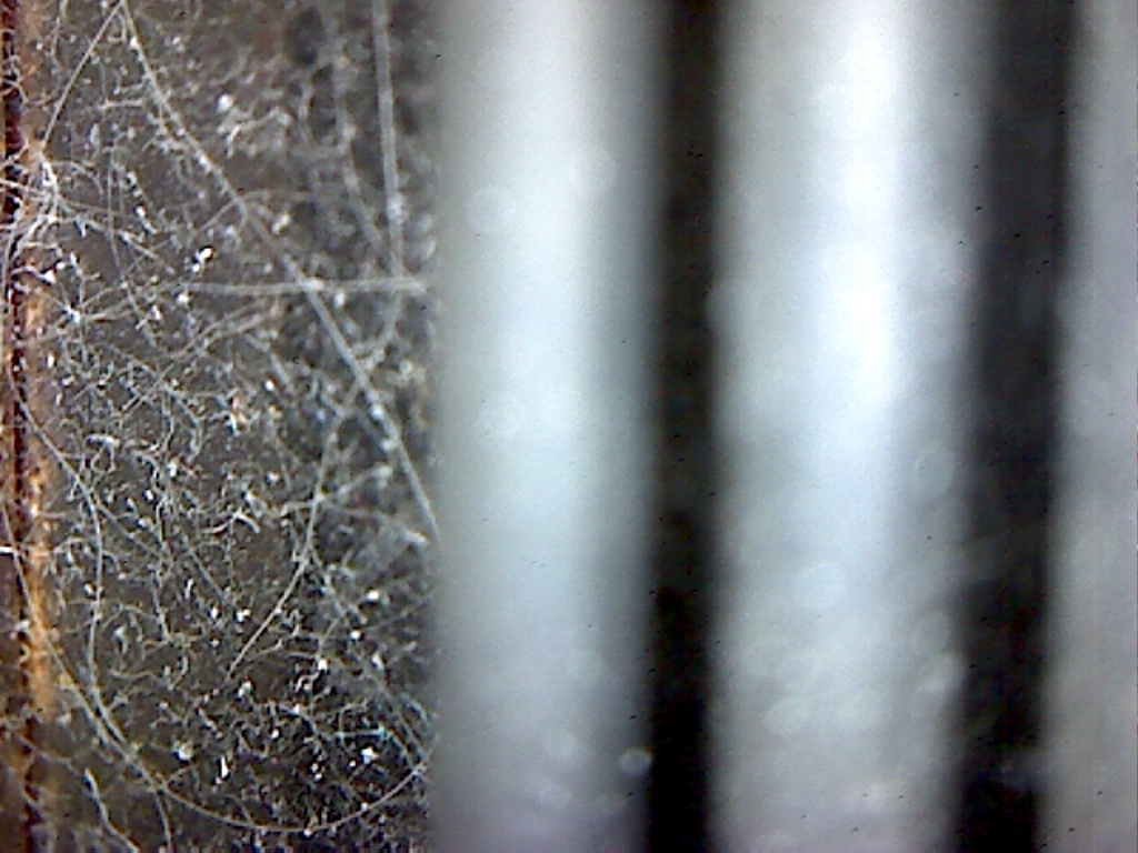

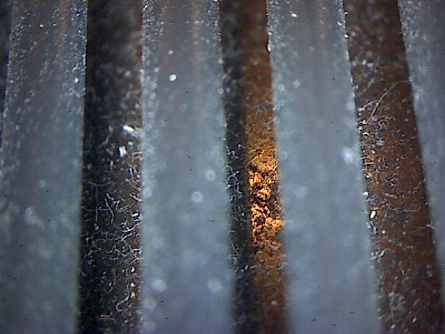

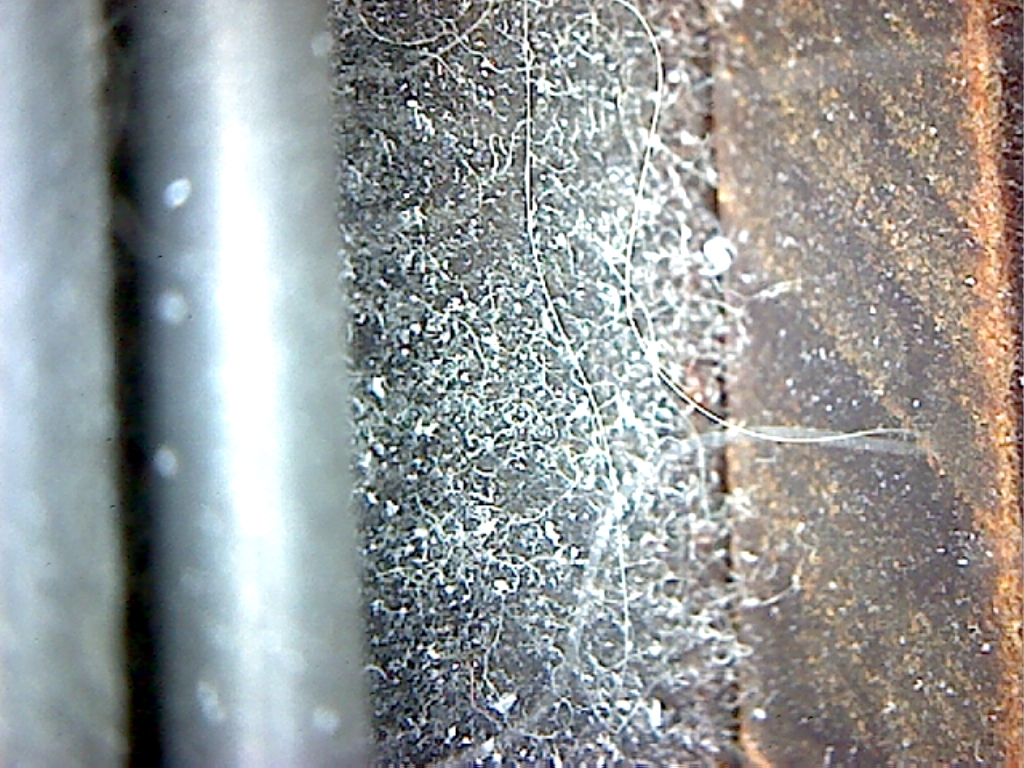

Probably (as usuall) there is a problem with diagphram (dirty) and conducting coating. I use USB microscope to inspect diaphragm (see encl photo).
Any idea how to repair it ?

I would certainly start with a gentle vacuuming. Use a soft brush attachment and see if that's sufficient to get all the muck off the wires and diaphragm. Also make sure the area around the perimeter is clean (where the diaphragm attaches to the frame), around the silicone dots, the bars, etc.
You could also try gently blowing them out with compressed air. Keep the pressure low and aim the stream sideways so it glances off the diaphragm.
With whatever method, go slow and only use as much pressure as is necessary to get them clean. Stretched Mylar is pretty tough, but pierces easily with small diameter objects.

Careful cleaning with vacuum or compressed air is the easiest first step, and it could fix the problem. If there's enough stuff on the diaphragm it may be bleeding off the bias voltage. In most electrostatic speakers, very, very low current is used for the bias so they can't handle much leakage. When the bias voltage is low, output is also low and can sound distorted. Having a bunch of debris in the speaker can also cause various noises.
It's best to wait at least 6 hours after unplugging the speakers to clean them (overnight is sometimes suggested). Letting the static charges dissipate from the speaker will help the dust/hair release more easily from the diaphragm and wires.

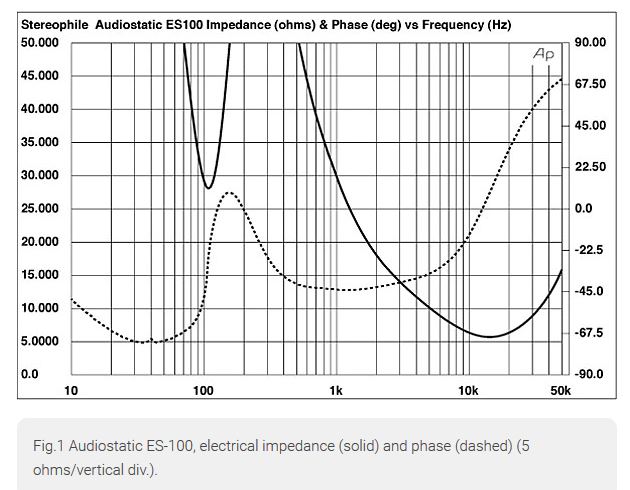

This information follows Quad impedance chart. Accidentaly I do not exceed 8V RMS and do not try to go bellow 60HZ.

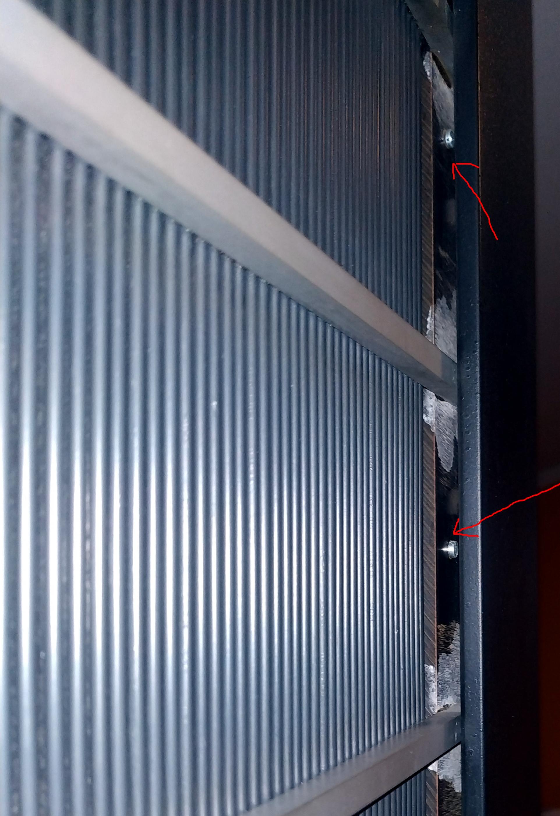

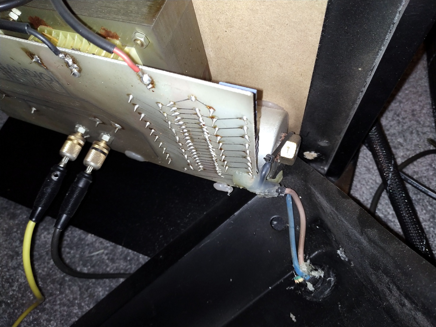

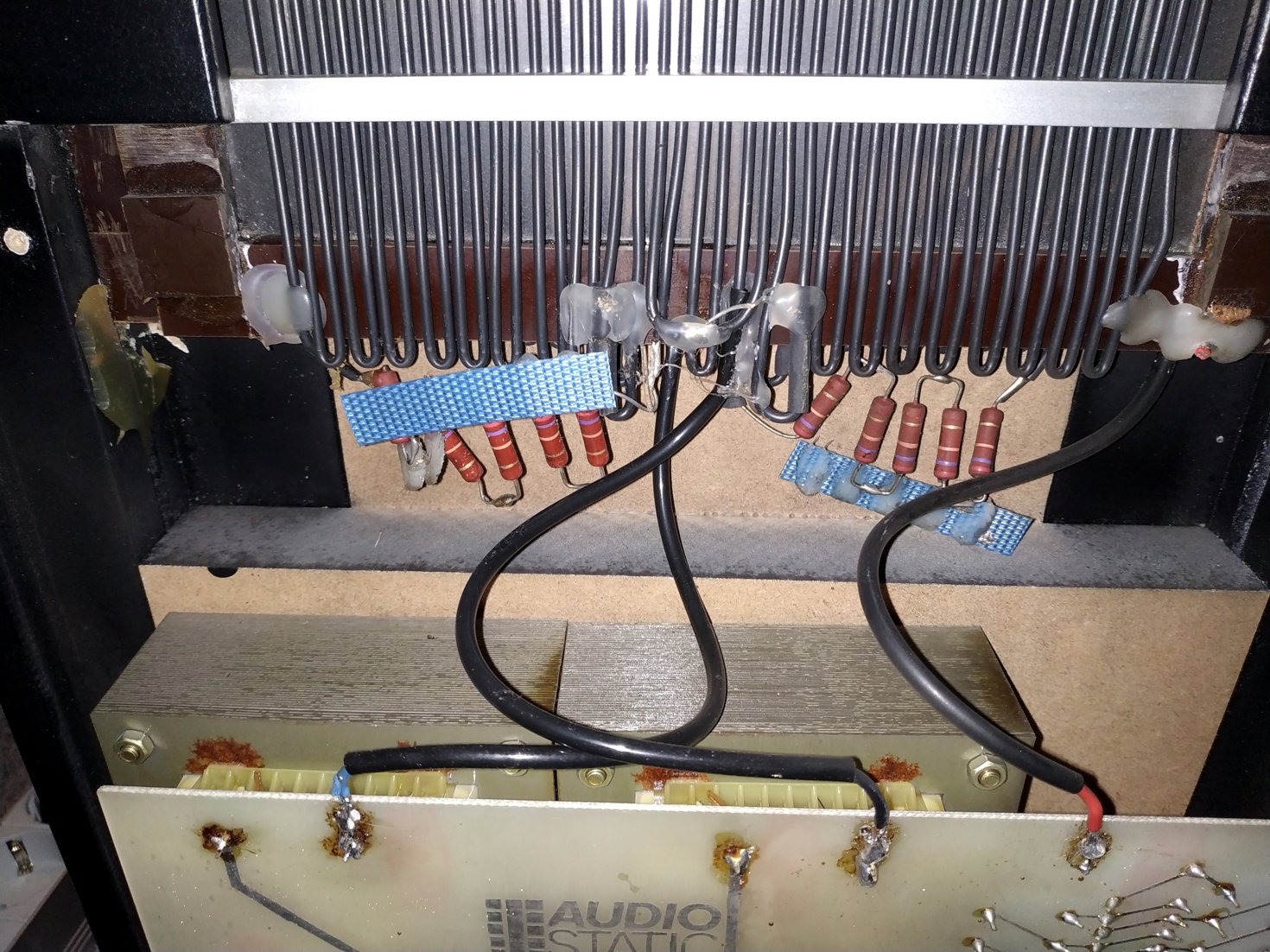

It looks like former owner try to refurbish film (there are screws around internal frame) and instead of oryginal parts somebody put Siemens (looks like from washing machine) 30mikro capacitor and wirewound resistor with alu radiator.
A few photos of „modified” ES100.
Somebody exchange input capacitor (resistor too), add “audiophile mains cable” and fastened frames by screw.
Film was probably exchanged too but looking for another modifications I’m not sure about quality of service.

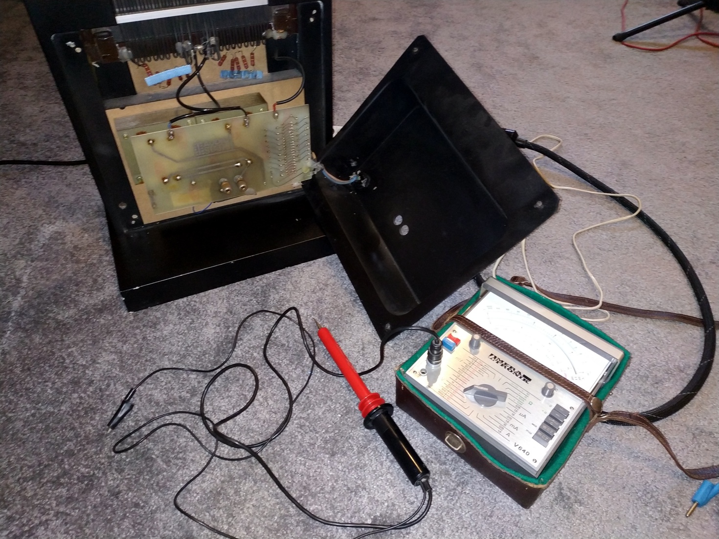

At lower input levels where it is behaving, does the speaker seem to have decent output now, or does the volume seem very low? At 2.83 volts in, most electrostatics will be in the low 80 dB range at 1 meter.
If your output is significantly lower than that, you can try to reach your high voltage probe in to the diaphragm and check to see if that bias voltage is also on the diaphragm in multiple spots. Probe very lightly though, or use a flat piece, very flexible loop, or something, so it's less likely that a hole will get punched in the diaphragm.
If output seems about right at lower input levels, you may want to sweep through the bass range with your signal generator and see at what frequencies the diaphragm resonances occur. If they are very low, the diaphragm may have lost tension, which makes it less stable and more likely to get sucked into the stator. Another way to approach this is to decrease the bias and see if the speaker behaves more normally with more input. You can do this with a variac on a low-frequency, simple multiplier.

Thanks’ for suggestion - I'll check HV on diaphragm.
