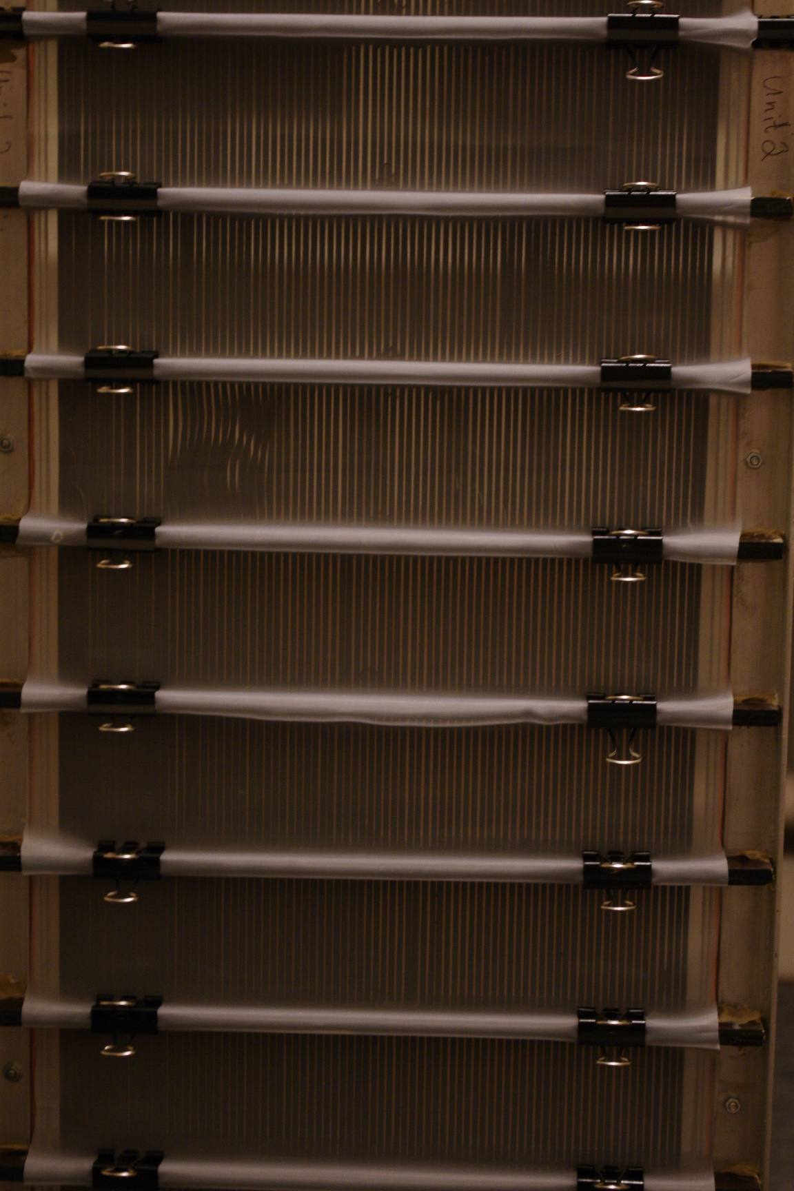

What material audiostatic horizontal strips which support wires are made of ?
The Audiostatic horizontal supports are made from aluminum. In my experience, it is not desireable to use metal for wire supports when building segmented stators. The reason is that there will be capacitive coupling from segment to segment throught the metal supports that bypass the segmentation resistors. So, high frequencies are not filtered out from the segments further from the center of the panel like you might think just looking at the schematic. Dispersion suffers compared to a panel made with non-conductive wire supports.
Thanks. I suspected that it's from aluminium from some pictures.
It's quite strange why they used such a material. I have not thought about capacitive coupling causing segmentation resistors be bypassed 🙂 . IMO it's not the safest way to build stators as there is still a possibility of wire insulation breakdowns or even mechanical damage.
Lukas.
It probably comes down to trade-offs between (structural stiffness vs size) and (material cost vs labor cost).
Aluminum(6061) is 10 - 20 times stiffer than plastics of same size so you can build thinner stator frames with aluminum.
This would be especially important when the cross bars need to span 30cm wide panels like the ES-500.
Also, Aluminum is stable where as most plastics can/do warp over time.
Aluminum may cost more, but it can be purchased in various stock shapes/sizes that can be used as is without any additional labor.
Use of plastics usually involves the need to cut smooth, straight cross bars to size from sheets of material.
This may not be important for DIY, but could be driving factor for a manufacturer.

after my experience with aluminum frames like Audiostatic (pics of those on my website) the capacitive coupling doesn't play any significant role here.
If You want to design a 'open' stator, the redish card board often used for the inner frame structure is out. Some black plastics or transparent acrylics may be left. But those materials may have stability and strength and fixing issues. The aluminum bars are standard off of the shelf products available in any DIY store here in Germany either as square hollow tube or massive rod or in rectangular shapes. They have a good looking anodized surface, are stiff enough even for wide panels, can be easily sourced and glued. One needs to watch if the glue is agressive to the wire insulation which over time could result in leakage or even breakdown. Plastic bars may not stick well with non-aggressive glues. With aluminum bars one may even use simple waterbased household glues to fix the wires. A cheap, easy to use and reliable solution ... and very DIY 😉
I've used hollow square of 10x10mm shape and massive 2x10mm shape in several panels successfully.
Panels are working well even after 20 years. So far the only thing I noticed every now and then is, that the metal bars aquire a bit of charge over time, that faintly zapps you on touching them. But the zap is even less than what happens walking over a carpet.

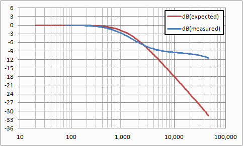

Absolutely. As an example, the attached plot shows expected and measured voltage driving the outter segments in an ES-100 style ESL. Measured capactive coupling was about 200pF! The level at which the attenuation flattens out is dictated by the capacitive voltage divider made from the segment capacitance and the coupling capacitance. This amount of response from the outer panels for f>10Khz negatively impacted the off-axis response. Remember plot shows electrical signal applied(not SPL) to outter segments which are larger in area than the center segment.

The charge you mention is the static charge stored in the (wire-pvc-crossbar) capacitor that Bazukas described. The HV supply connections to this capacitor are thru direct connection to wires, and surface leakage path from diaphragm contact to the crossbars.
If you try grounding the crossbars to avoid the charge buildup you will notice two things:
1) Increased capacitive load on the step-up transformer since it now has to drive this capacitance in parallel with the stator-to-stator capacitance.
2) If you are using a QUAD style neon light charge indicator, the flash rate will increase from current thru the grounded leakage path. This is most noticeable when connecting and disconnecting the grounding wire on humid days.

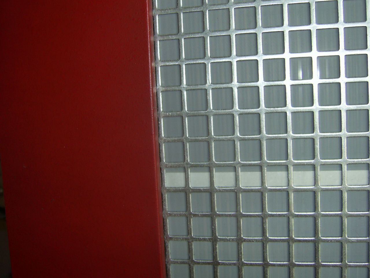

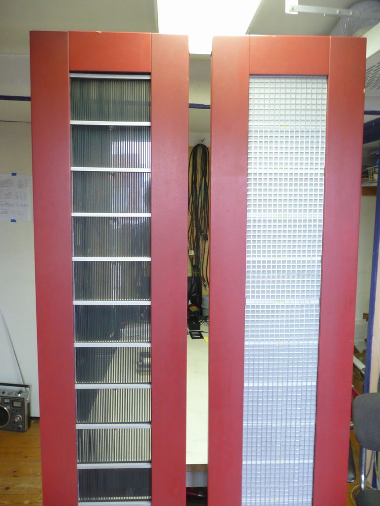

As you can see in the first post, there is a big resonance at approx 30Hz. Is it any way to modify the system to get rid of this?
I had a hypothesis that this would improve by removal of earlier mentioned series resistor, something that was obviously wrong.
The diaphragm resonance is most easily damped by application of acoustic resistance to one or both of the stators in the form of silk screen mesh or thin felt.
This will ruin the see thru optics of the ESL panel(this is very important to some people), but the bass response is much improved.
I posted some measurements of this damping technique here:
http://www.diyaudio.com/forums/plan...con-dots-resonance-control-3.html#post1958582
There had been a thread on another forum detailing the application of silk screen mesh damping to an ES-100. But it looks like the link no longer works. Attached are two pics I had saved from the posting before it disappeared. You can see that they glued silk screen mesh to a perforated metal sheet with square openings and then mounted it behind the rear stator.
Forum posting(link appears dead now): http://forum.puresound.be/viewtopic.php?f=9&t=447
Company that did the work: Modificatie Audiostatic door Audio 4 elektrostaten
One other alternative is to place on electronic notch filter in line between your preamp and power amplifier.
Ok, just for a quick experiment it will do.
The tighter and closer the mesh is to the foil the better it works.
Alfer* deliver U profiles which exactly fit the Audiostatic aluminum rods.
*available at Hornbach (German and Netherlands)
Why? The speaker is covered with cloth, and damping is on the rear side. Paper clips are good for experimentation - easy to remove and hold well.
I would have believed that a cloth would damp higher frequencies?
If so, one alternative would be to just add on backside. If it influence on higher freq, it will also influence on spread pattern, but for all we know it might improve interaction between speaker and room.
I can implement a notch filter, but in general, I believe in "making right from the start" to get the best sound quality.
