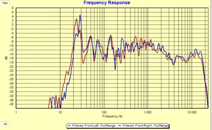

I have a Audiostatic DCM. I bought it some years ago, and have often asked my self what I was thinking. You can hear that there are some qualities, but overall sound is rubbish to be honest. When I started measure, I could understand why. Tried digital correction without too much luck. Then, when I looked at it, it seemed like some baffle step filters might help:

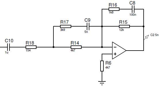

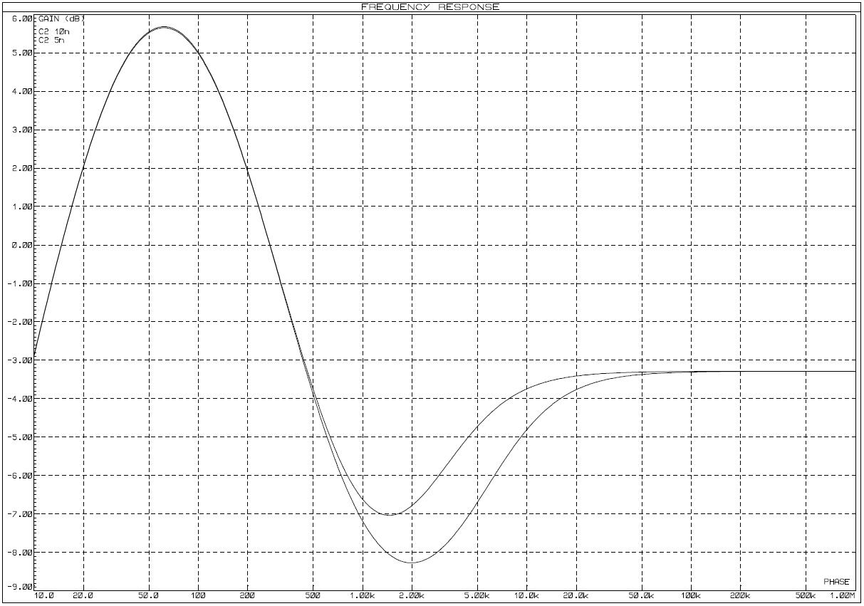

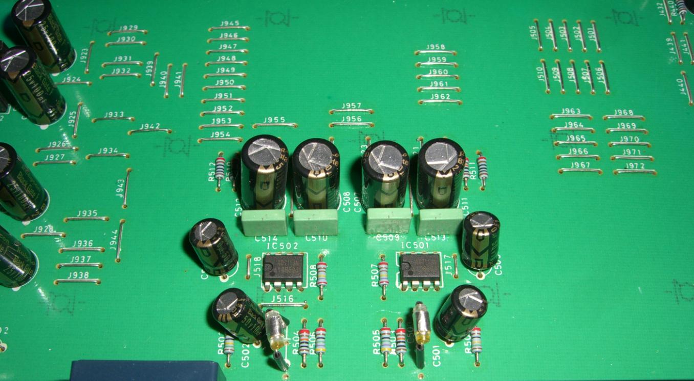

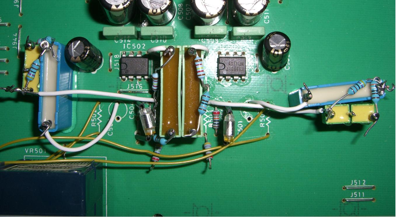

I had a old Rotel preamp laying around, who I started to modify.
C9 consist of two 10nF capacitors in series, this makes me able so easily change C9 value between 5nF and 10 nF. 5n gives the lowest dip, while 10 gives a lower center frequency.

With active filter it gets even better. I'm not very experienced in measuring, have one measurement where it looks even better, but I'm not sure if this is valid.

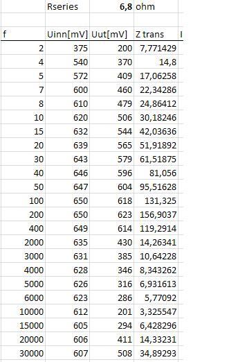

By the way, tested input impedance by applying a voltage with a signal generator and measure voltage before and after a series resistor of 6,8R. Already at 2Hz impedance was close to 8 ohm, dispute DC resistance of approx. 0,5ohm. So if your amp doesn't put too much DC at terminals, or is very weak, it should be fine to bypass filter.

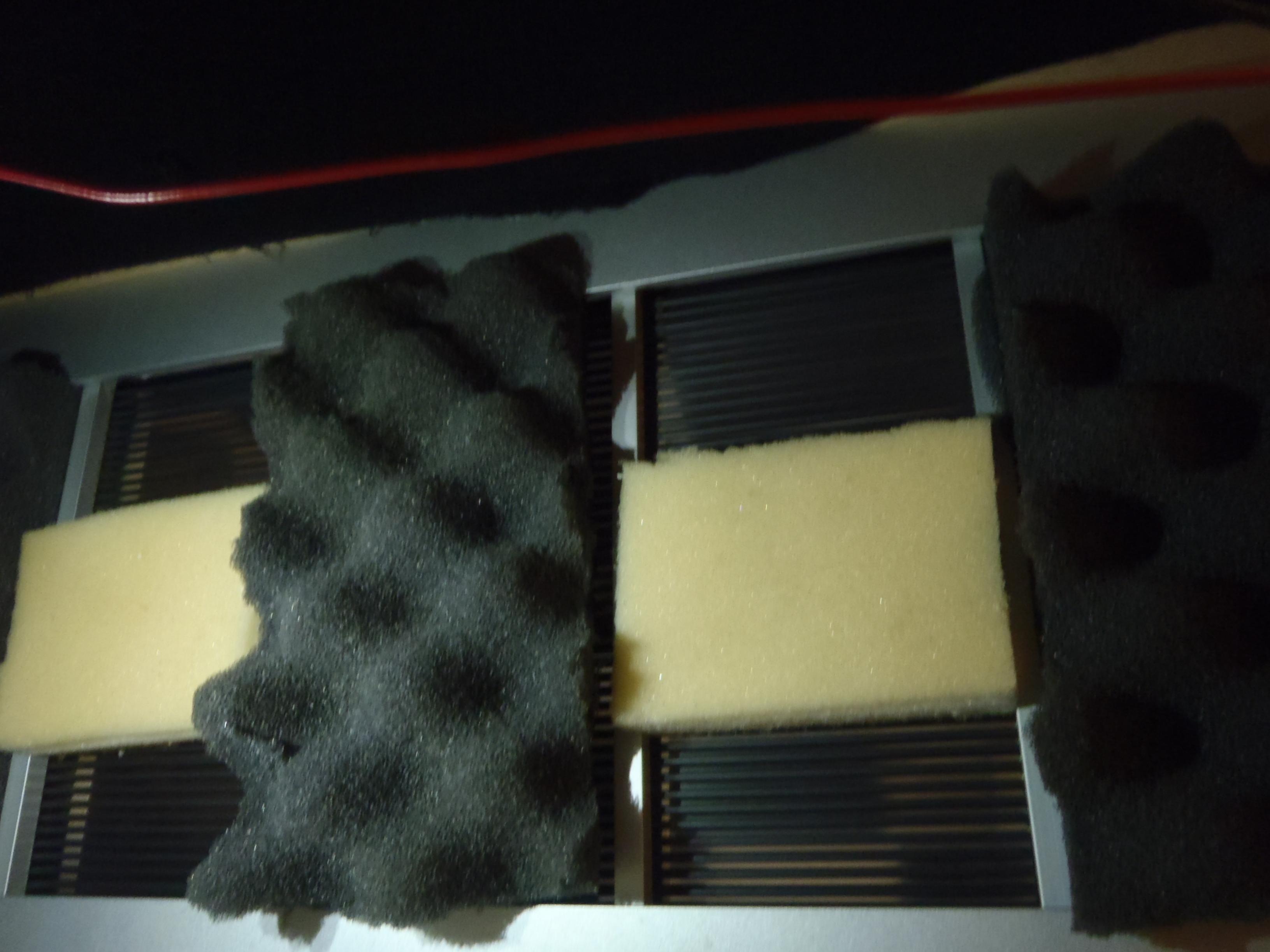

1- Audiostatic do not use damping behing the mylar and it's very bad.
Acoustat used a kind of 3/8 thick felt pad glued behind stator.
I think Quad did the same but not 100% sure what it was.
I used foam (maybe one day I'll try felt but I had foam around) to cover maybe 70% of the back. I just used pressure fit (no glue or anything)
It help the sound quite a bit.

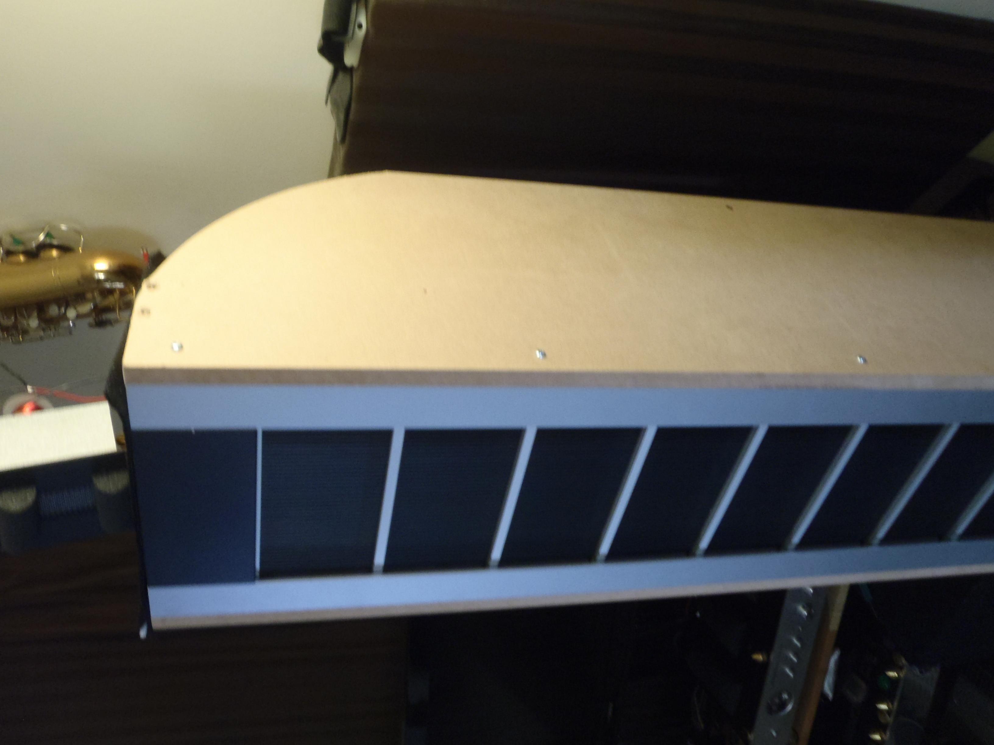

2-For the dropping response, building wings on both side help tremendously too.
More weight, less vibration from panel and lower rolloff.
My U baffle audiostatic have 12" wing on each side with felt and I used few bracing too.
Impressively, high benefited very much from the side wings.

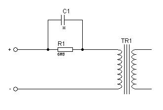

Found the reason why removal of resistor increased output at higher frequencies. Reason is of course that impedance start decreasing after a certain point, then goes to a minimum value of 3,3ohm just above 10kHz. Here are the values if it should be of any interest, sorry for the big hole between 400 - 2000Hz.
Audiostatic had the Bass Boost technique patented. They used a autotransformer with two inputs, one for feeding Bass and one for feeding MH. The inputs were joineded together via coupling parts that shaped amplitude response such that bass got a boost. As every other detail in the construction, the quality of the audio transformer as well as the auto transformer was poor and cheap. The audio transformers hardly reached the quality of standard EI-core power trannies as you can see from any impedance plots (impedance minimum around just 10kHz with a segmented panel!). See US Patent 4,461,931 for the auto transformer patent.

Audiostatics without mirror drive will benefit from wings. I have experimented with wings as well. It does not generate the very low push of the mirrordrive but it makes the overall sound warmer. Panel vibrations were killed as well (a major problem with es100). Unfortunately my wings were very ugly.

..as you can see from any impedance plots (impedance minimum around just 10kHz with a segmented panel!).

I can't stress enough to add wing on your audiostatic.
And like Dijkstra mention, the result is very ugly.
Here a picture of mine (yet to have veneer on side)
Even better would be to use a Infinite baffle if you can.
I used that around my acoustat 2+2 years ago and had a f3 of about 25 without any sub!!!
That was clean bass too, unfortunaly, I can't do it again where I live now.

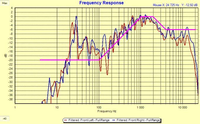

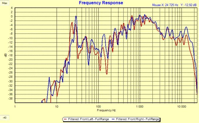

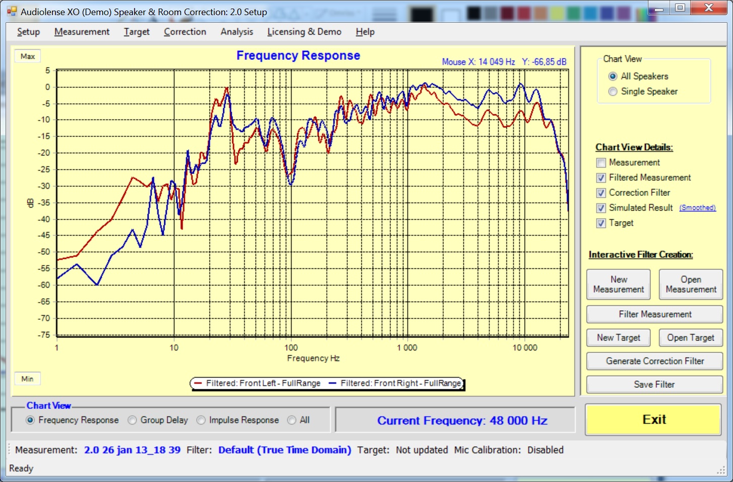

Do you mean 40/50Hz? My is at right below 30Hz. To me it seems like you are introducing a flow resistance who are dampening excursion of membrane, is that the function of your mod?one more pic of the back of the panel
Foams just barely holds there but provide critical damping.
My 40h peak got reduced quite a bit
(your seem to be at 50h)
I will consider to try large baffles, it might be possible for me to do if I'm a bit creative, but I'm not sure.

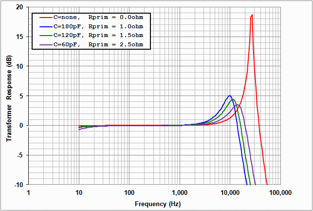

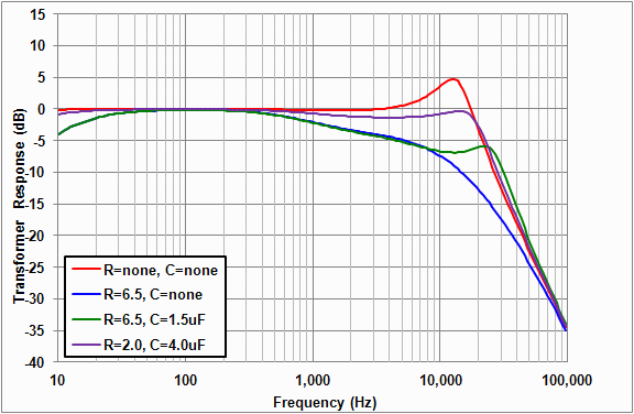

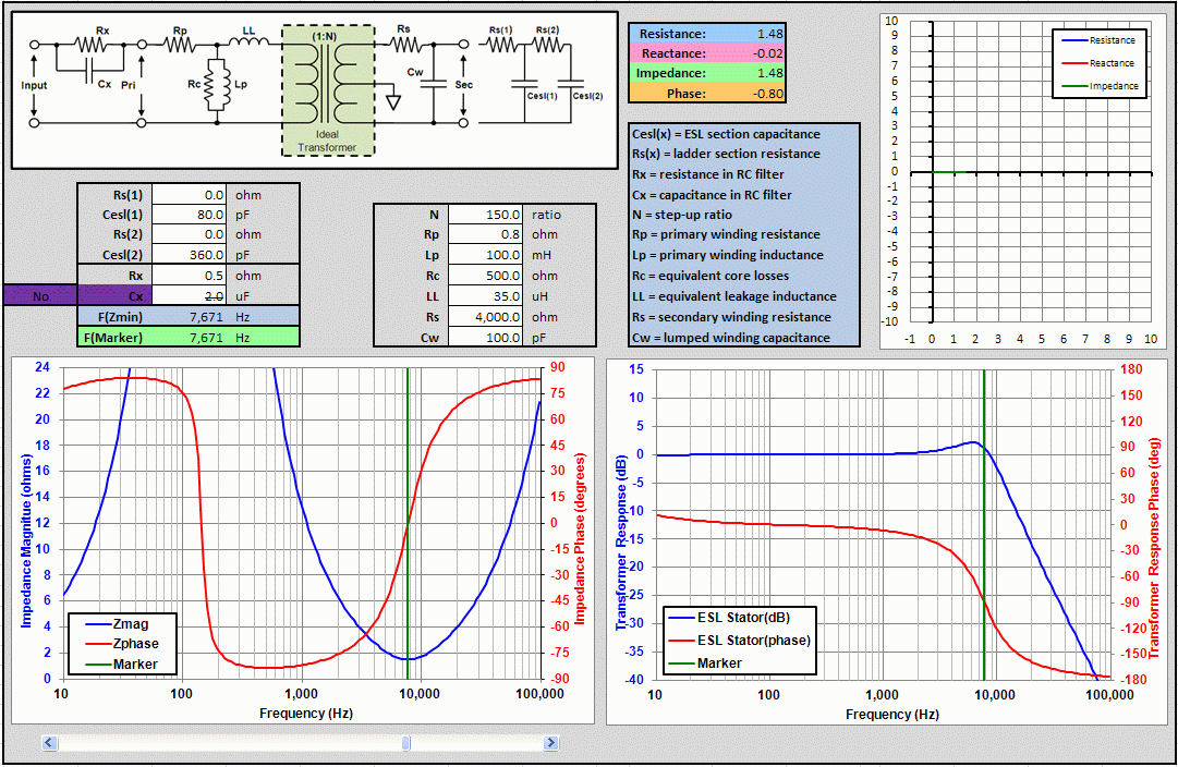

Could you explain this in more detail? What is a segmented panel, and why is minimum Z at 10kHz bad on a segmented panel?
A segmented panel does not connect all of the panel area directly to the transformer. Rather it uses resistors to segment the panel area so only a small area is directly driven by the transformer at high frequencies(HF). This is important because the panel capacitance will limit the HF bandwidth due to an underdamped low-pass filter formed with the transformer leakage inductance. The Audiostatics are 2 segment designs.
The minimum Z point indicates the frequency where the response of the transformer will start to roll off.
In general you would like this to be >20Khz, but even 15kHz is useable.
For example:
Attachment #1: shows a model for the impedance and transformer response for Audiostatic ES-100. The resonance between transformer leakage inductance(LL) and panel capacitance can be seen by the minimum dip in impedance at 13,669Hz. You can see that this corresponds with the roll off point of the HF response of the transformer.
Attachment #2: shows what would happen if the whole panel was hooked up to the transformer without segmentation.
Resonance is moved down to 7,671Hz as is the HF roll off point.
Attachment #3: using the model we can compare the response for different values of resistors and capacitors in the primary circuit. You can see that the transformer response changes match pretty well the differences you measured.
In general, increased resistance dampens the resonance and rolls off the response. Adding a capacitor in parallel with the resistor can help to reduce the roll off or peak the response above the resonance point when a larger resistance value is used.
If anybody would like to play around with the modeling tool, let me know and I can post the Excel spreadsheet.

Here some measurements i made about Audiostatic transformers (with different loads)
Also a measurement from core saturation. Everybody can see that AS has a problem with core saturation which will be even greater when a mirrordrive will be added.
Thanks for sharing the measurements. I agree that the AS transformers did not have the best power handling capability. Perhaps that is one of the reasons they put the higher resistance values in series with the primary. I posted brief summary of my test results for the mirror drive on an ES-300RS here:
http://www.diyaudio.com/forums/plan...c-es-100-mylar-replacement-2.html#post2061070
Looking at the measurements for various loads on your AS transformers, it looks very similar to what I would predict if using transformer parameters for the transformers on an older ES-100 I measured. The older transformers had higher leakage inductance, but lower winding capacitance.
Attachment #1: shows the transformer parameters I had measured.
Attachment #2: shows predictions for the loadings you measured.
