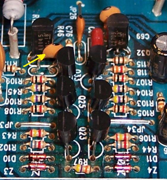

Q30 (2SA1145) & Q32 (2SC2705) get real hot. Picture is the area of concern, with Q30 & Q32 in the back.

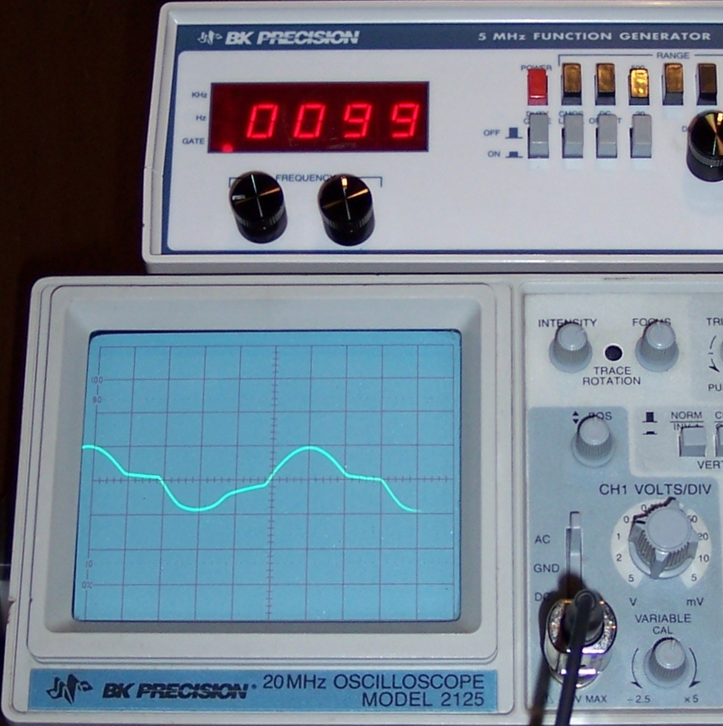

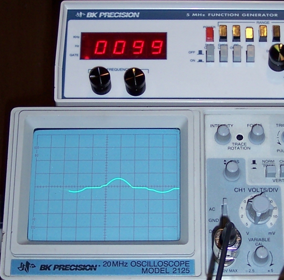

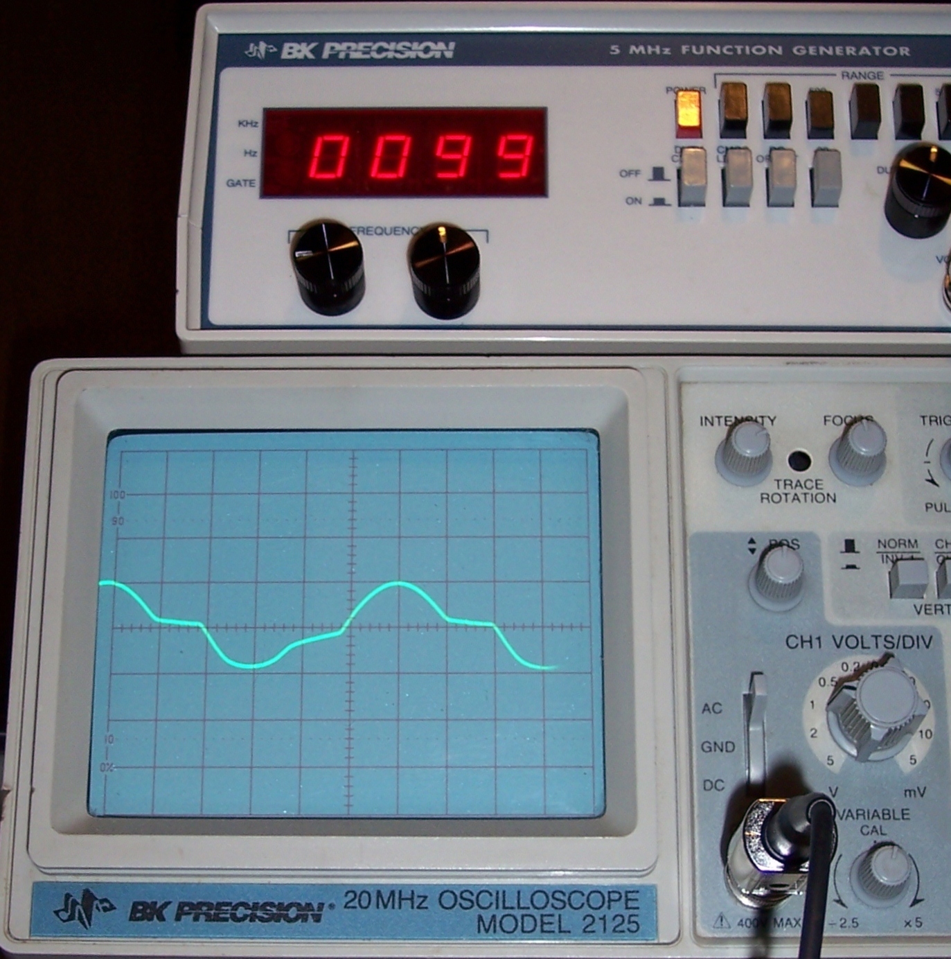

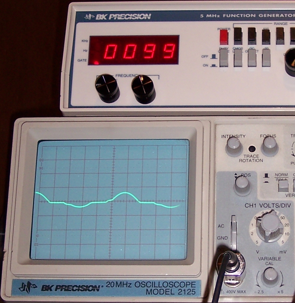

If I unplug the rail supply, the amp will come out of protection and I can see the signal all the way to the output teminals. However, it isn't clean. Here are some pictures of what I am seeing. It apears like something is not allowing the PNP side to develop signal equally to the NPN side.
Is this what should be expected for not having the rail supply connected?

Are you feeding a sine wave signal to the input? If that is true then that's is what you should see in the output. I can see the positive and negative side of the signal generated at the driver output but it should be the same as the input.
The first picture of the scope is the sine wave I'm driving into the amp.
The drivers have the same signal as shown in the other four.
These measurements are with just the +/- 15V supplied, as stated earlier the rail supply is disconnected.
Backtrack and check the voltage with the scope the transistors collectors and base of the transistors driving the base of the drivers. Without the schematic is hard to troubleshoot the amplifier. The scope is the best test equipment to troubleshoot. Just follow the path of the input signal and when does not compare you may found what it is causing the problem.

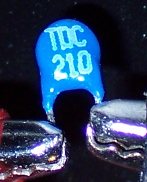

Near as I can tell this is an NTC thermistor.
I removed it from the circuit and measure about 1330 Ohms accross it at room temp. It falls to about 275 Ohms when I hold a soldering iron near it.
Does the marking mean that it should be 210 Ohms at room temp and drop from there OR is it correct that it drops to 210 Ohms as its lowest resistance?

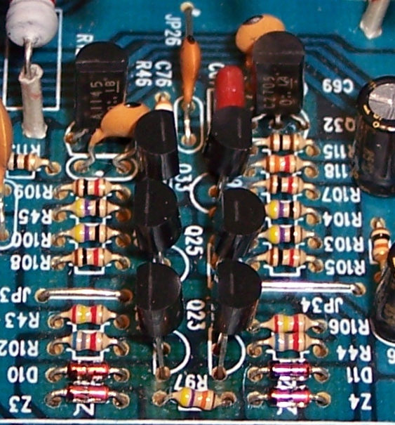

Found the problem. The 22pF ceramic cap indicated by yellow arrow had failed. I only had 33pF caps on hand and replaced two of the 22pF to keep it balanced (the other one is behind the 2sc2705) The amp works with those, however I think I should put the correct value in there, as it doesn't sound quite right even though the scope on the outputs looks clean.
