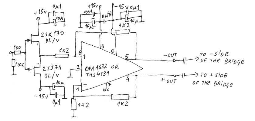

During the last "stocktake" that I did in my workshop I found a stash of 4 LM4780 chips that I've got at the time through the "sample" program, and decided to try building a bridge/parallel monoblocks if possible.
Can you please advise if you are still selling the boards and if so, can I bridge two parallel boards for one channel?
After some digging through the forum, I found this that can be used as buffer (big thanks to @juma ):
This buffer converts SE signal into Balanced, but what if I already have balanced signal coming out of my media player (Cambridge CXN)?
I tried to contact you via website, but had no answer so far, appreciate any help here.
Big thanks in advance to all,
George
