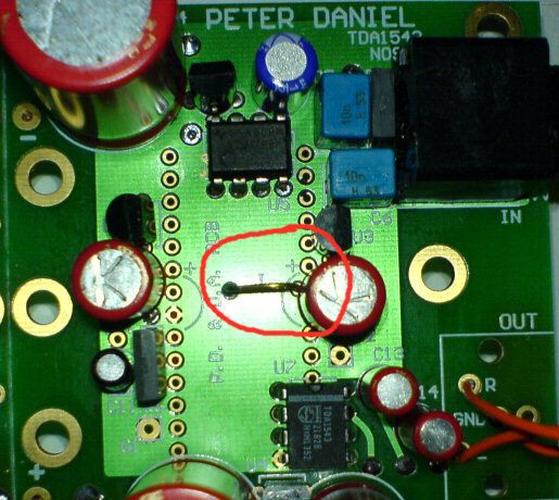

At least 200 sets of that DAC has been sold already, and I'm not aware of anybody having a similar problem. It's either player, or a bad chip. I tried variety of transports and there was always compatibility.
Try to increase the value of R6 to let's say 400R and see if this changes anything, although I don't think it would matter.
What are you using for a preamp?
Thanks for those pictures, mine looks just the same 🙂
I tried 500ohms (the closest I have) there and it made no difference :{
I am using it plugged into a set of JBL active computer speakers at the moment but I also tried it with my headphone amplifier ( http://www.amb.org/audio/mmm/ )
I have to humbly apologise and hang my head in shame....it works and I have been an idiot.
I wondered when building what the ---J--- marking meant on the topside of the CS8412. Rather than figure it out I thought I'd come back to it.
Suffice to say now I realise it means jumper and have inserted the wire, the dac works fine
I was studying the pictures joint for joint for about the 50th time when I realised yours has a jumper in there. I now have to put the line driver back in and tidy up the mess I have made😱
At least you know what to tell the next dummie who complains of the same thing 😎

Now I have added the jumper everything works, my soundcards and the cheap dvd player.
Did you place this jumper?
Coax and digital are the same thing.
Coaxial = a cabled connection (not an optical one)
Probably your players have it labeled differently, some of my stuff says coax, some digital and some spdif.

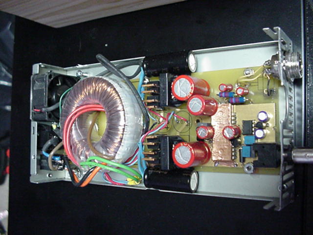

Hey Peter I just ordered the Premium kit. I got a question, what type of wire did you use in your making of say Patek? What type of wire did you use between the transformer and the amplifier? I am planning on having a remote power supply as well. I am not sure if what I will use. What ohm ratings are acceptable for this?
opt-e said:Wiring.. how much does the type of wire matter?
Stranded vs solid core? Thin vs thick? Copper vs silver?
Ideally, what kind of wire should I be using for what purpose?
I see most people use heavy guage wire for power supply wiring and output wiring, and thin wire for low voltage signal carrying wires.
You're bound to get different answers depending on who you talk to.
For what it's worth, I prefer the smallest gauge solid core wire that can be used for the particular application. I am using 30 gauge solid core silver wire for the inputs; 22 gauge solid core silver wire for the outputs; 22 gauge solid core copper wire for the power supply.
Wade
Destroyer OS. said:Hey Peter I just ordered the Premium kit. I got a question, what type of wire did you use in your making of say Patek? What type of wire did you use between the transformer and the amplifier? I am planning on having a remote power supply as well. I am not sure if what I will use. What ohm ratings are acceptable for this?
For signal, I'm using solid core silver (looks like 30ga) that came with S&B102 TVC, I'm not sure where it can be bought. I also like Vampire solid core wire (26ga) that Percy sells.
For power and speaker connections I'm using Cardas hookup wire (19.5 ga). Since I'm using it in umbilical cord, solid core wouldn't work. Also, Cardas seems to work better than everything else I tried so far. Solder pot or high power iron is needed for termination (multiple enameled strands).
