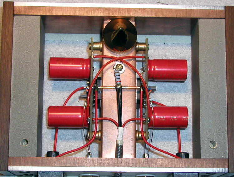

The difference between dual mono and stereo is the number of rectifier boards used in powering the amp. In stereo, both channels are powered from the same board, in dual mono each channel has its own separate board.
While in stereo setups with a single transformer you could still use two separate boards, on more than one occasion I had reports of humming supply so I always recommend using a single rectifier board.
That's also what I'm doing in all my stereo amps and in the picture below I'm showing trouble free way to connect power grounds: output grounds of both channels (OG) are connected with a piece of thick copper wire. Central point on that wire is power star ground and all 4 ground wires from rectifiers board (PG+, PG+ and PG-, PG-) are connected here. Output grounds are taken directly from the board, signal ground connects to the point on the board marked as SG.
Those boards were designed with dual mono operation in mind and as such they work well without any mods.

Here's the same idea in a Patek amp. Boards are positioned vertically now, and I created special grooves to slide in the copper wire connecting both channel grounds. Black wires from PS ( PG+ and PG-) connect to that point and grounds to speakers are also taken from here. Amp's chassis is connected through 10R resistor.

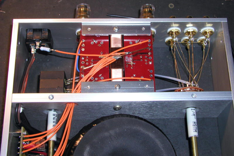

That amp was actually a custom order, I'm not sure if I offer 5 channel version as a product.
You should.. I think that looks even sweeter than the usual patek. Plus, then you can reach all the hometheater people.
I'm a bit confused with your stereo amp setup. You say you're using a single rectifier board, but you have four ground wires from the rectifier? Shouldn't there be only two?
Also, it doesn't look like you have anything connected to PG+/PG- on the amplifier board. If grounds from the rectifier board are connected to the star ground then I assume connecting them to the grounds on the amplifier board is not necessary. Please correct me if I am wrong.
The four ground wires consist of dual PG+ and PG- connections (in parallel, to increase current capacity).
There are no wires connected to pads marked PG+ and PG- on amp board, but the copper wire (connecting both channels) connects to OG pads (which is the same ground as PG+ and PG-). The central point on that wire is a star ground, and that star ground is connected to the output ground (OG) on amp's board.
Got it, thanks 🙂 I didn't realize your 3875 board has a pair of PG+/PG-.
Would it be a good idea to do the same (use dual PG+ and PG- connections) with the 4870 kit?

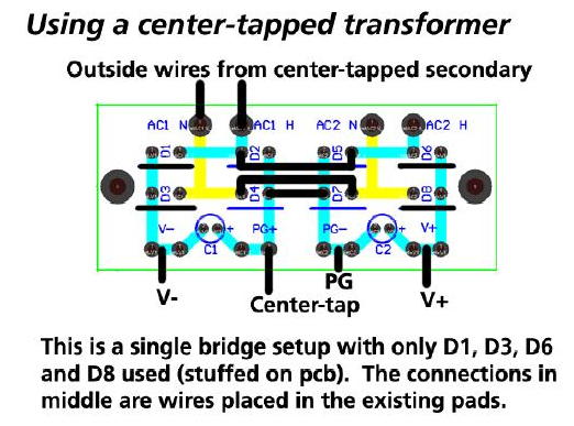

Hi Peter, anyone who can help. Sorry if this is answered before.
How do we connect the PS if the transformer is the center-tapped type? Should we omit 4 of the diodes or disconnect (cut) the CT and connect as two series windings on the rectifier board?
Sangram
