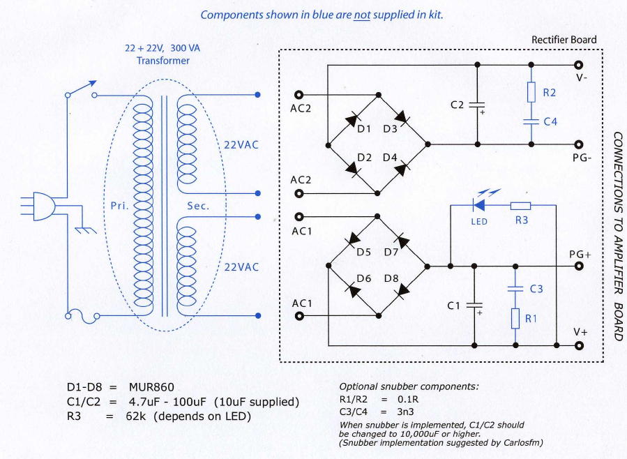

do i still need the rectifier board? and then connect it to the transformer?
where can i buy a good and cheap transformer?
Unless using batteries, the rectifier board is always needed.
You may try Antek transformer on Ebay or check with Apex Jr: miscellaneous.html
should i go with a transformer or toroid? which transformer model is most suitable for LM3875 dual mono kit?
i read the building instructions and saw on the picture that each pcb output is connected to L&R RCA. 2 pcb will be 2 of RCA pairs while i only need 6.3mm headphone output. how do i solve this problem?
For headphones it doesn't matter much, choose most convenient option.
For the amp I usually recommend 300VA, 2 x 22V toroids, for headphones 100VA should be fine.

my headphone needs 4W at 100 ohm impedance. so 100VA transformers will do? how do i know the transformer's power is sufficient for powering my headphone?
i looked at the schematic again, and ended up confused with the output channel:
http://i61.photobucket.com/albums/h75/soesnake/Home%20Audio%20Projects/AmpKit003.jpg
the picture is showing 1 PCB. it's clearly written there are 2 output channels. if i build a LM3875 kit i will have 2 PCB with same output, meaning there will be 2 left & 2 right channel right? while the headphone jack will only need 1 left, 1 right, & 1 ground channel. How do i do the wiring?
The LM4780 is dual chip (2 amp channels in a single chip), the LM3875 is a single chip (one amp channel per chip)
100VA should do; with headphones it's not the current, but voltage that delivers required power.
