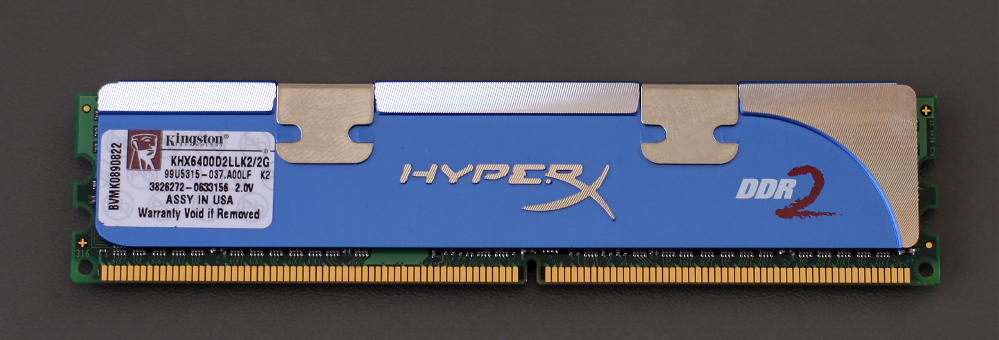

Hi Rick,
I found last piece of that memory at local store (2 x 1k), I also located and ordered Gigabyte mobo. Regarding CPU, what is the consensus: E5200 or 7200?
rickmcinnis said:KINGSTON HYPER X LL memory
Hi Rick,

Peter, you have too much memory. You need one "stick" of 512mB. You do not want to use the dual channel feature of the MB, either.
