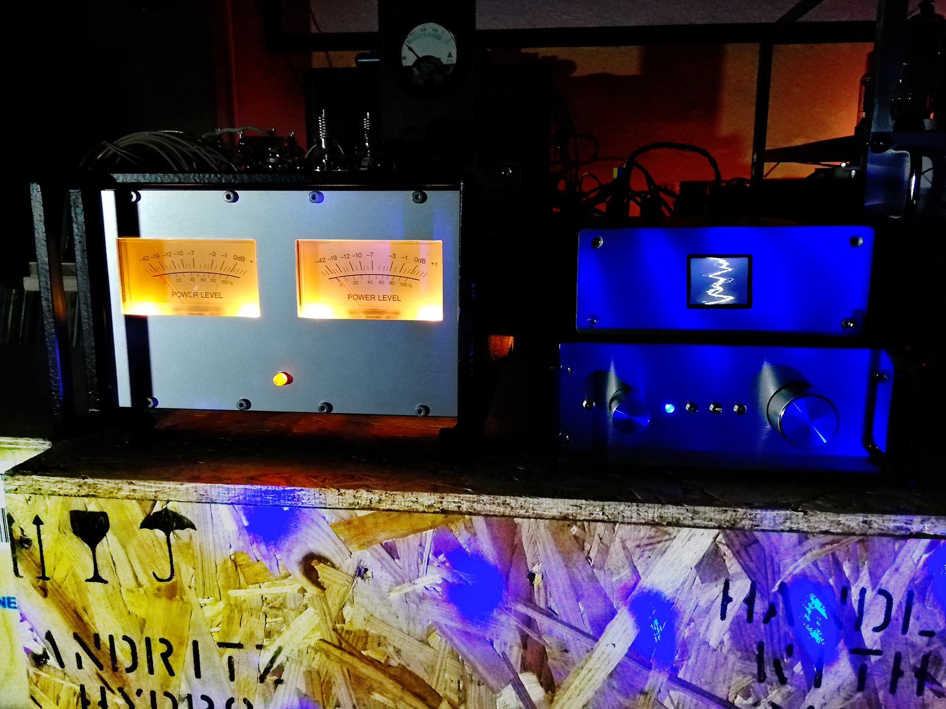

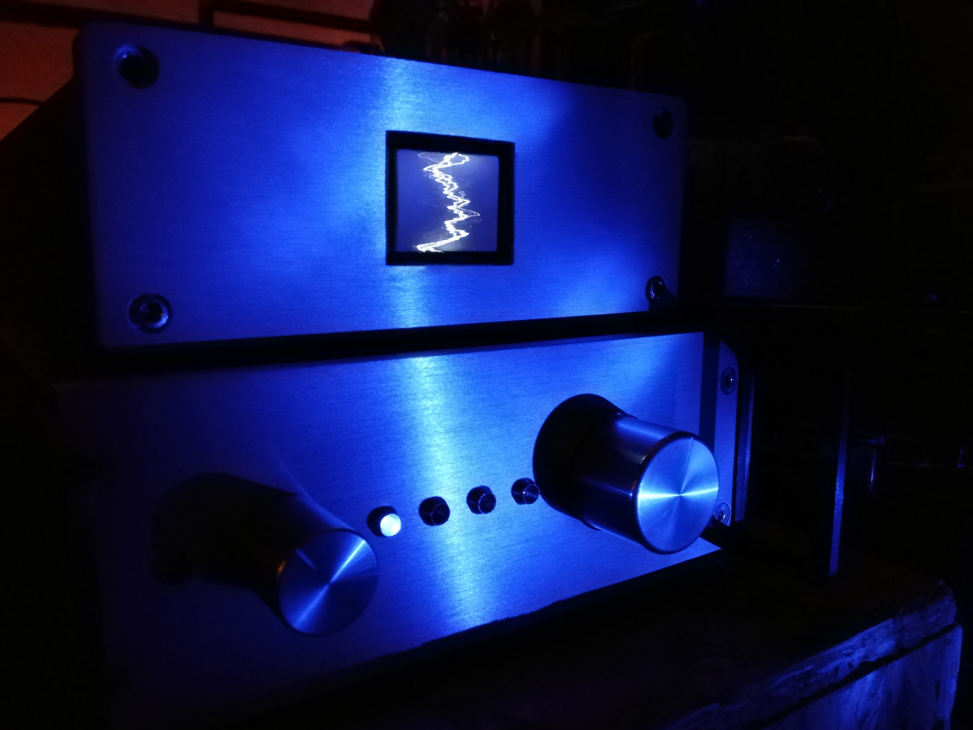

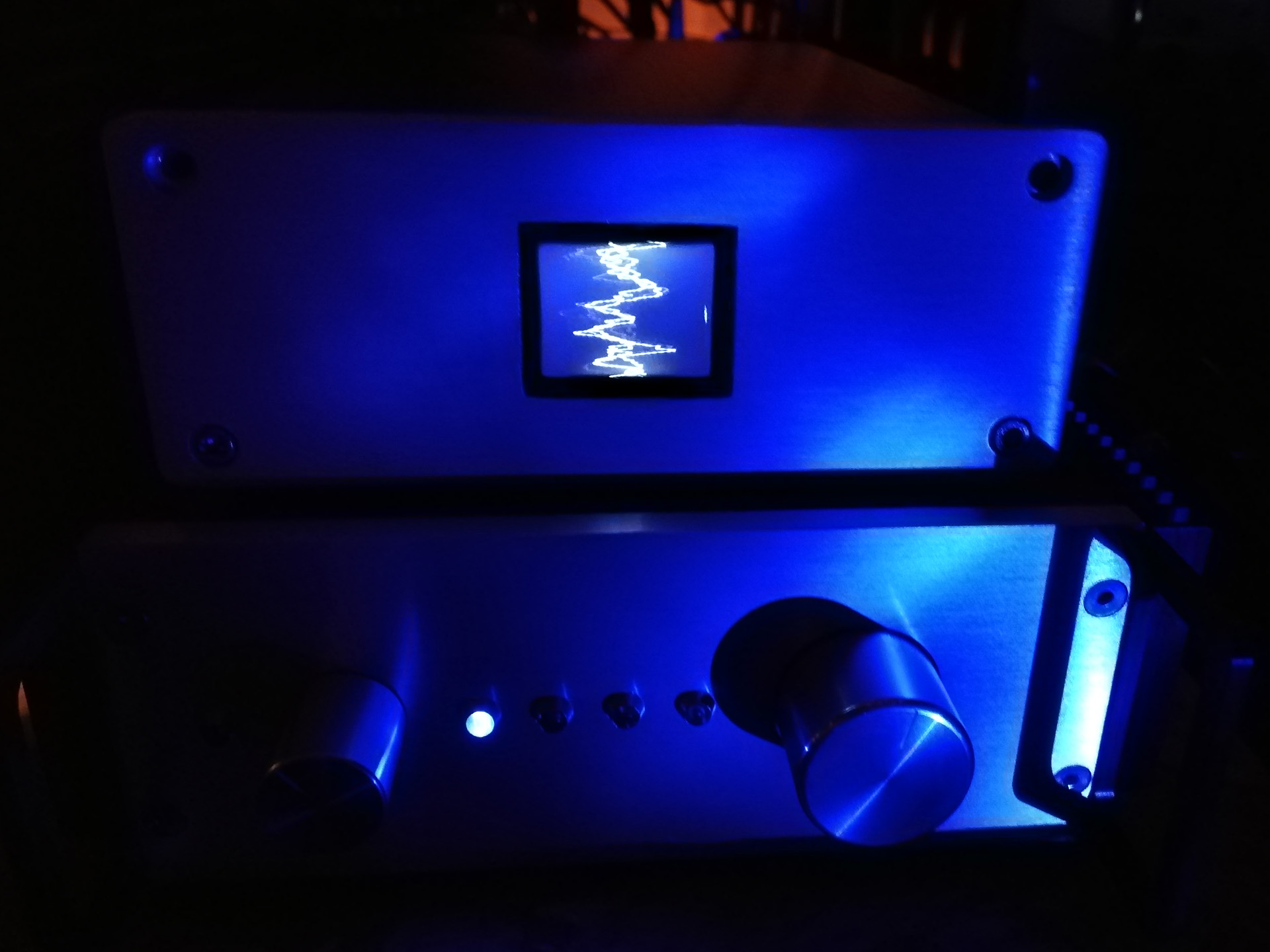

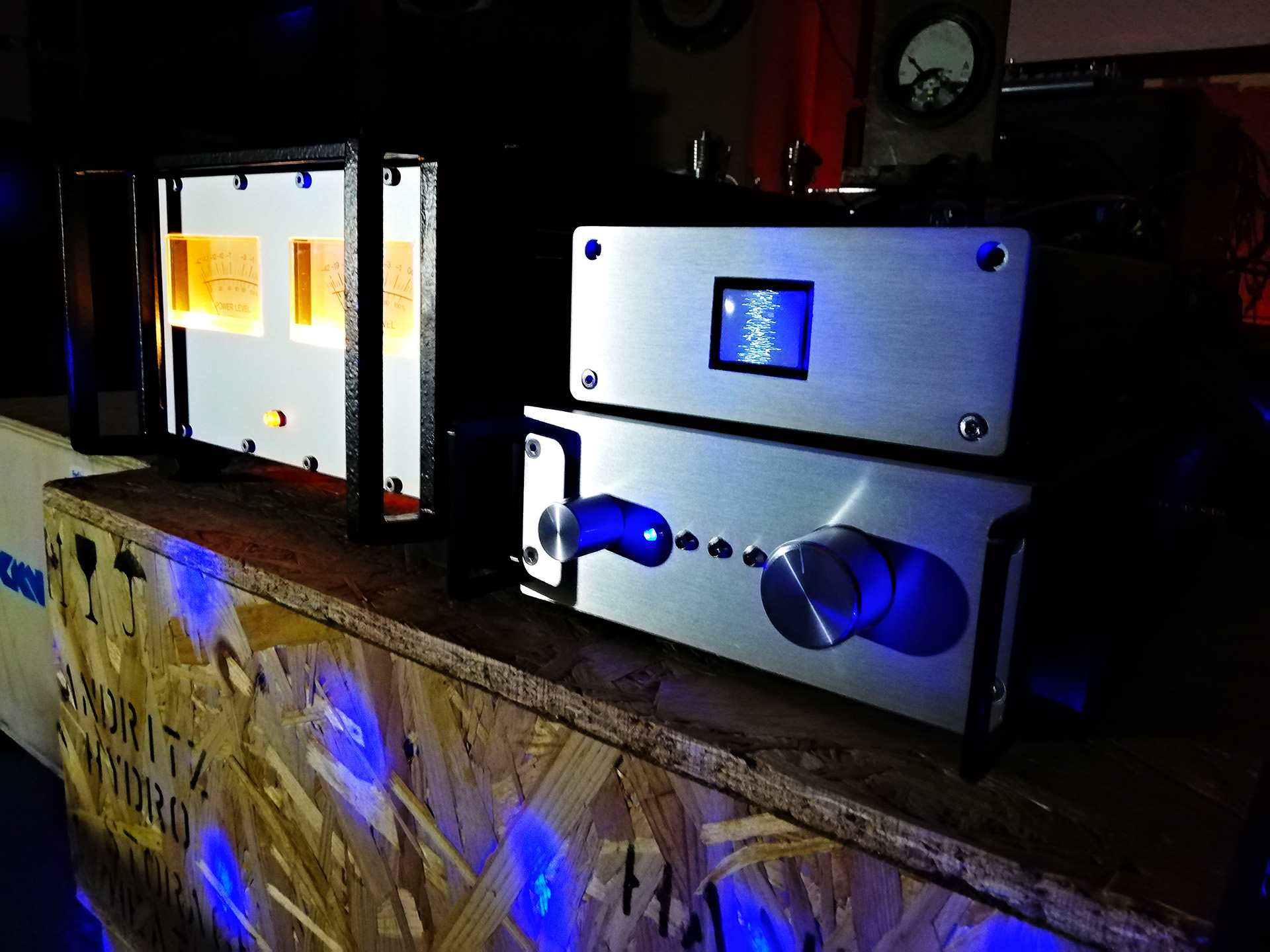

Here is my audioscope project - just because I like uncommon methods to visualize sound

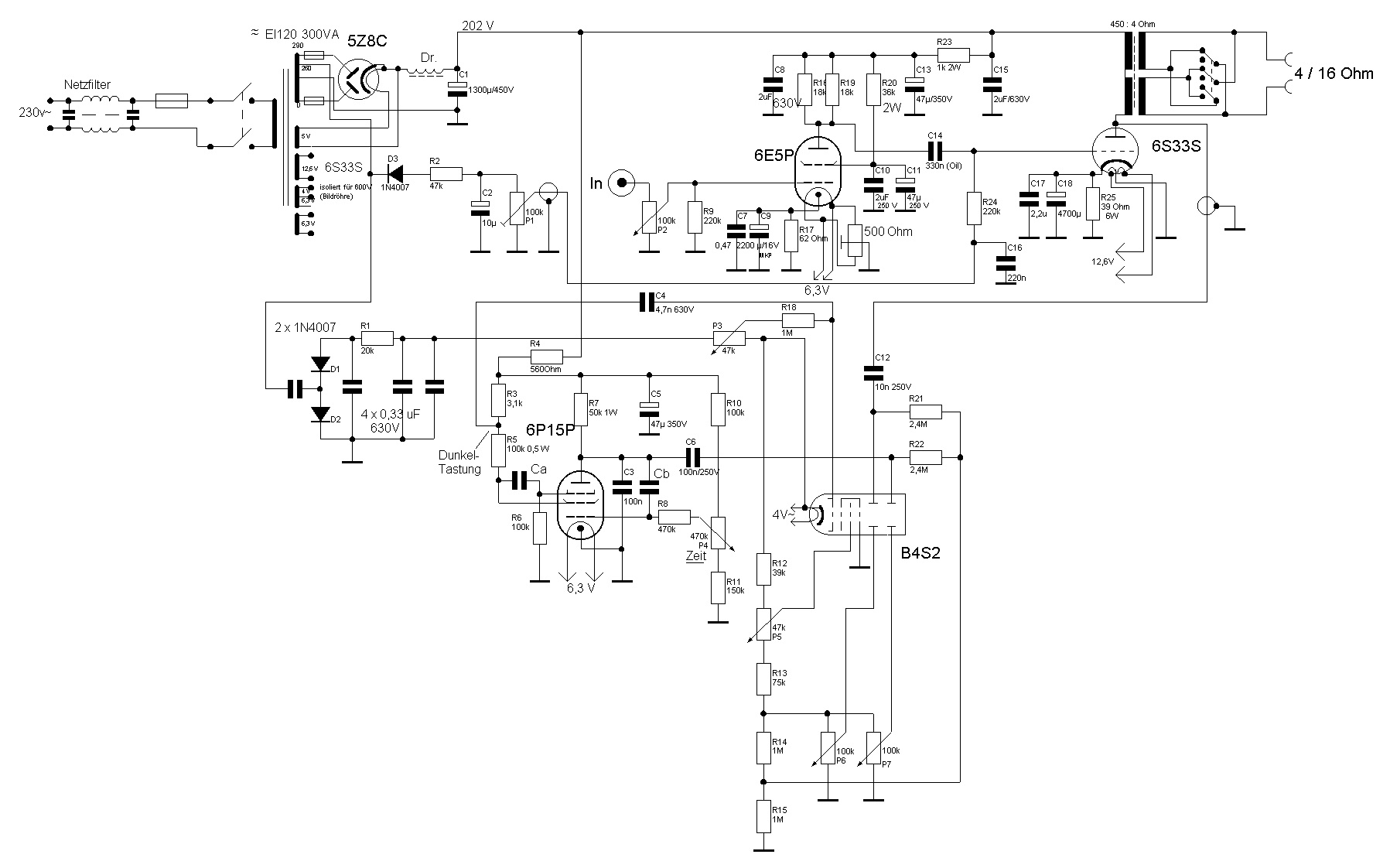

Some time ago, I used a similar circuit as an optical gimmick in an EL84 SE tube amplifier. (With a smaller and round crt YouTube ).
It consists of the electronics out of a 1,77" viewfinder from an early 1980s video camera. I don´t remeber the camera brand and type where it´s teared down from, but it should be easy to find something similar for little money in the Bay.
Newer camera types usually are downsized and contain less impressive CRTs.
After reverse engineering the viewfinder, put it into operation carefully with the right connections and voltages. Just a small mistake in your considerations, and it burns... I speak from experience 😀
The horizontal deflection coil is disconnected from the circuit, the vertical stays untouched. I´ve integrated a terminating resistor in place of the x-deflection coil, to keep the circuit running.
With a small audio amplifier module like PAM8403, it´s able to modulate the CRT deflection.
This procedure is easily reproducible and not critical, if you manage to analyse the viewfinder electronics right 🙄
