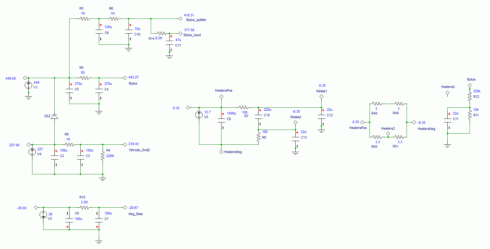

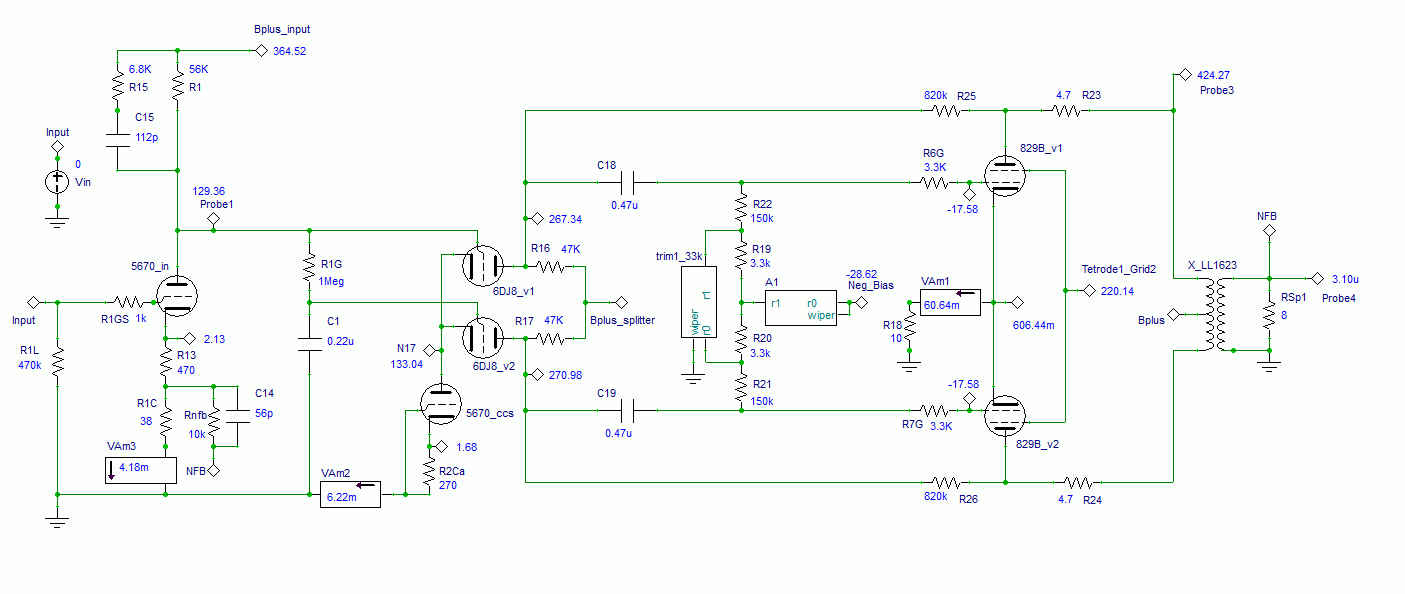

Hello,
I also have a FU29 amplifier and I'm planning to do some upgrades.
First I used my multimeter to get the schematics. In the attachments you'll find the circuit of one channel and the PS of both channels.
The mods that I'm planning to do are:
- replace input tube 6N3 with 5670 (2C51) (already done, that was easy :) )
- Add chokes to PS and make separate PS for left and right channel
- augment the current through the input tubes from 2ma to 4ma
- replace pot with ladder attenuator
- replace critical components with better ones, especially the coupling caps
Danny

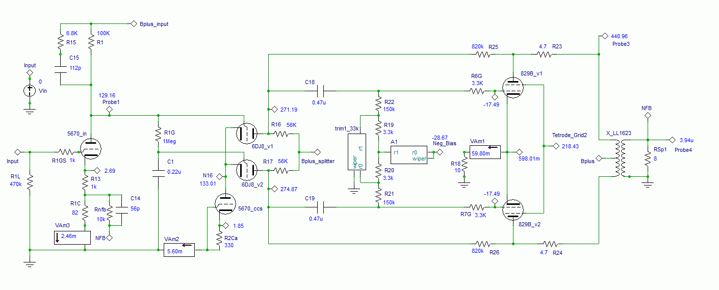

And here are the schematics of the updated version that I'm planning to make, if I find some time :)
For the moment I'm busy with building some speakers, so all my DIY time goes to them first.

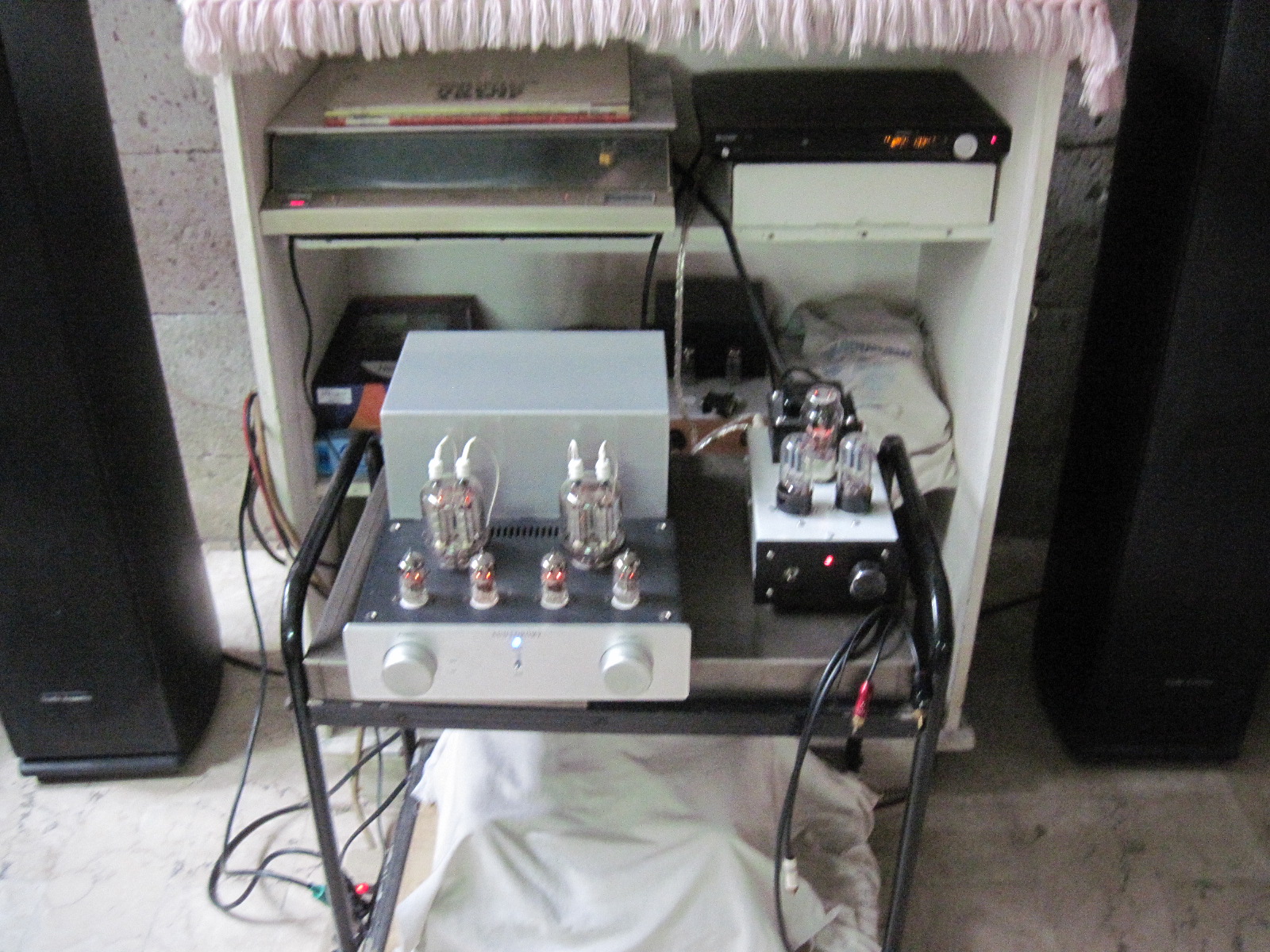

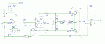

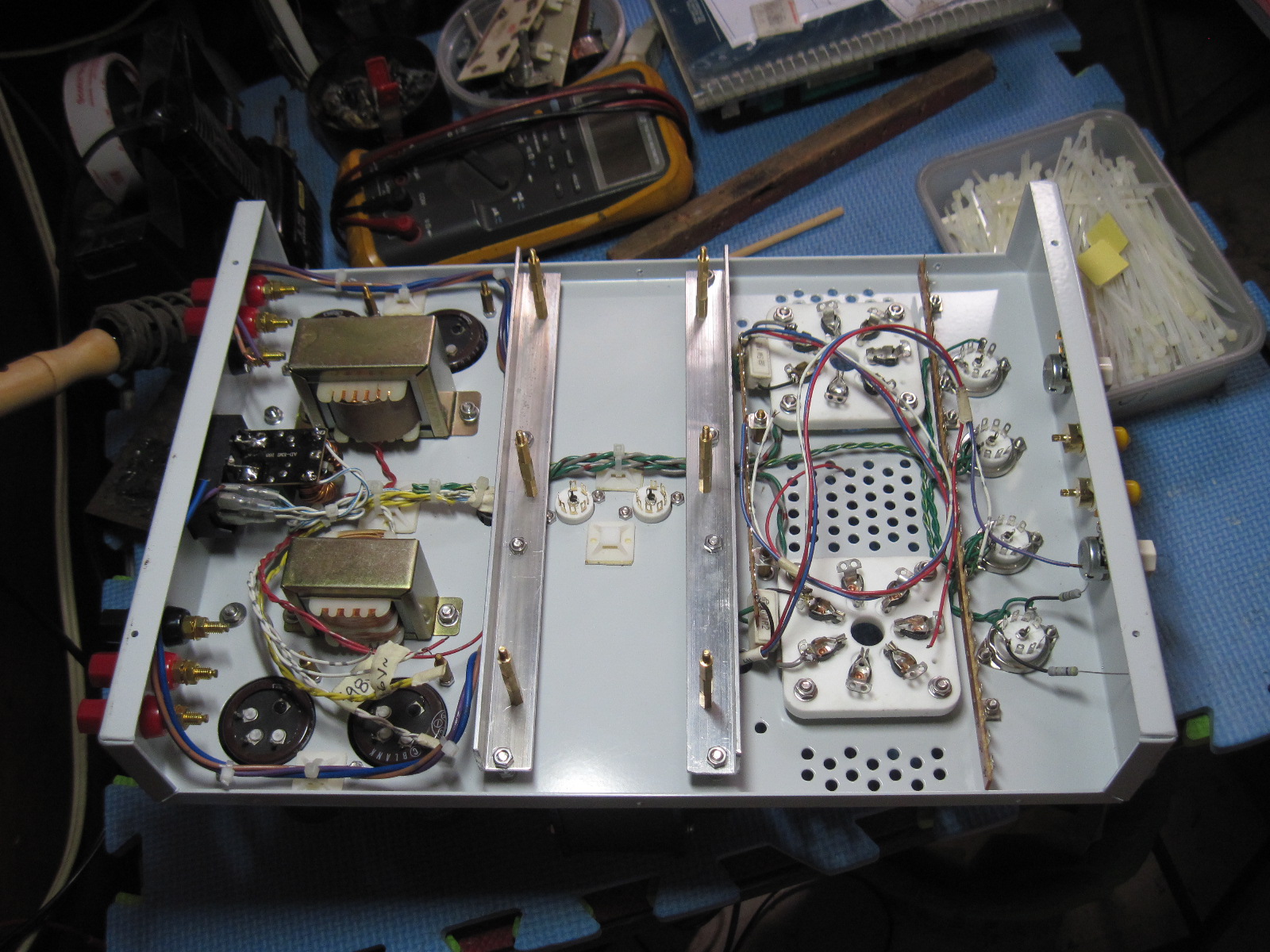

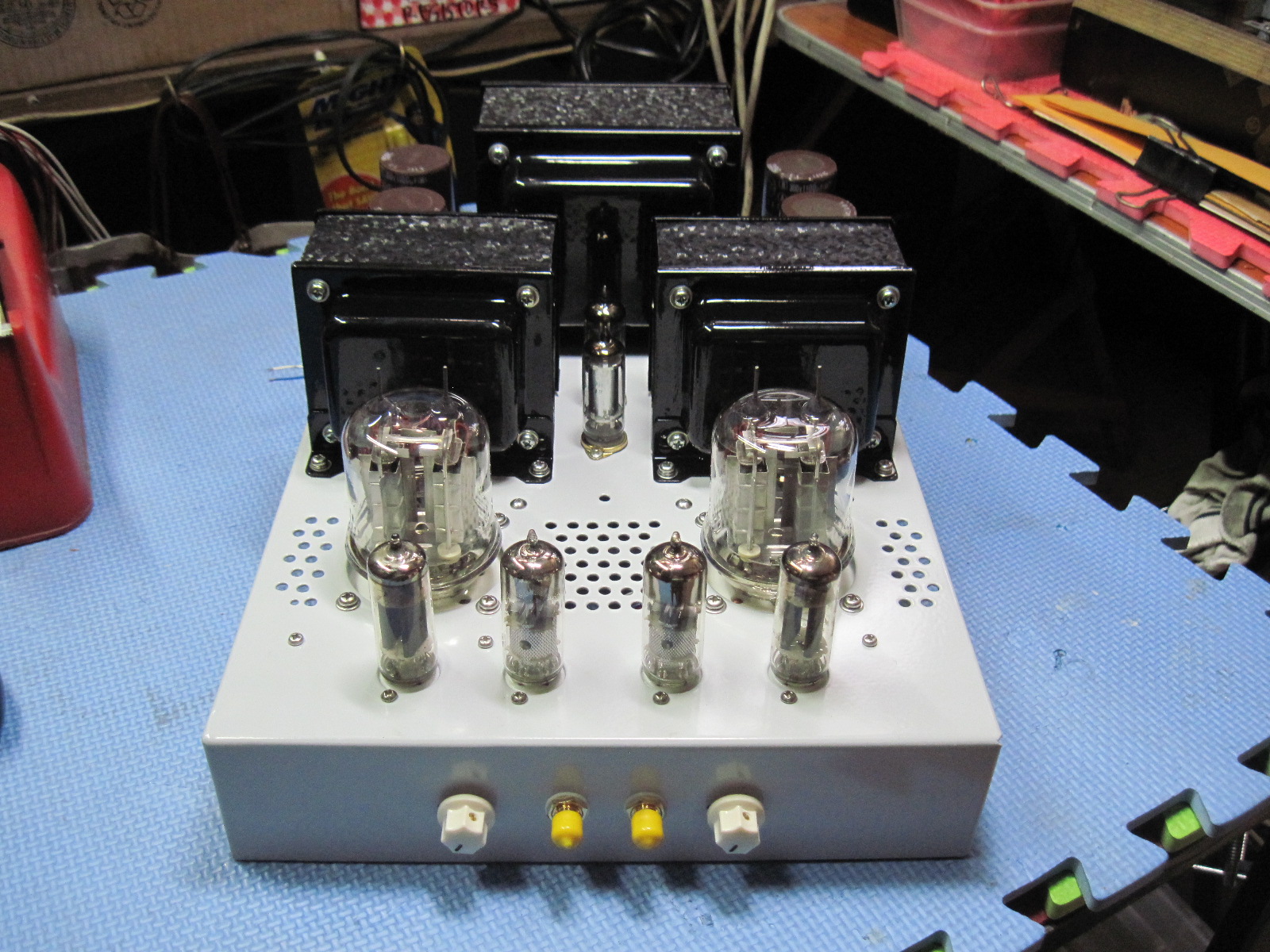

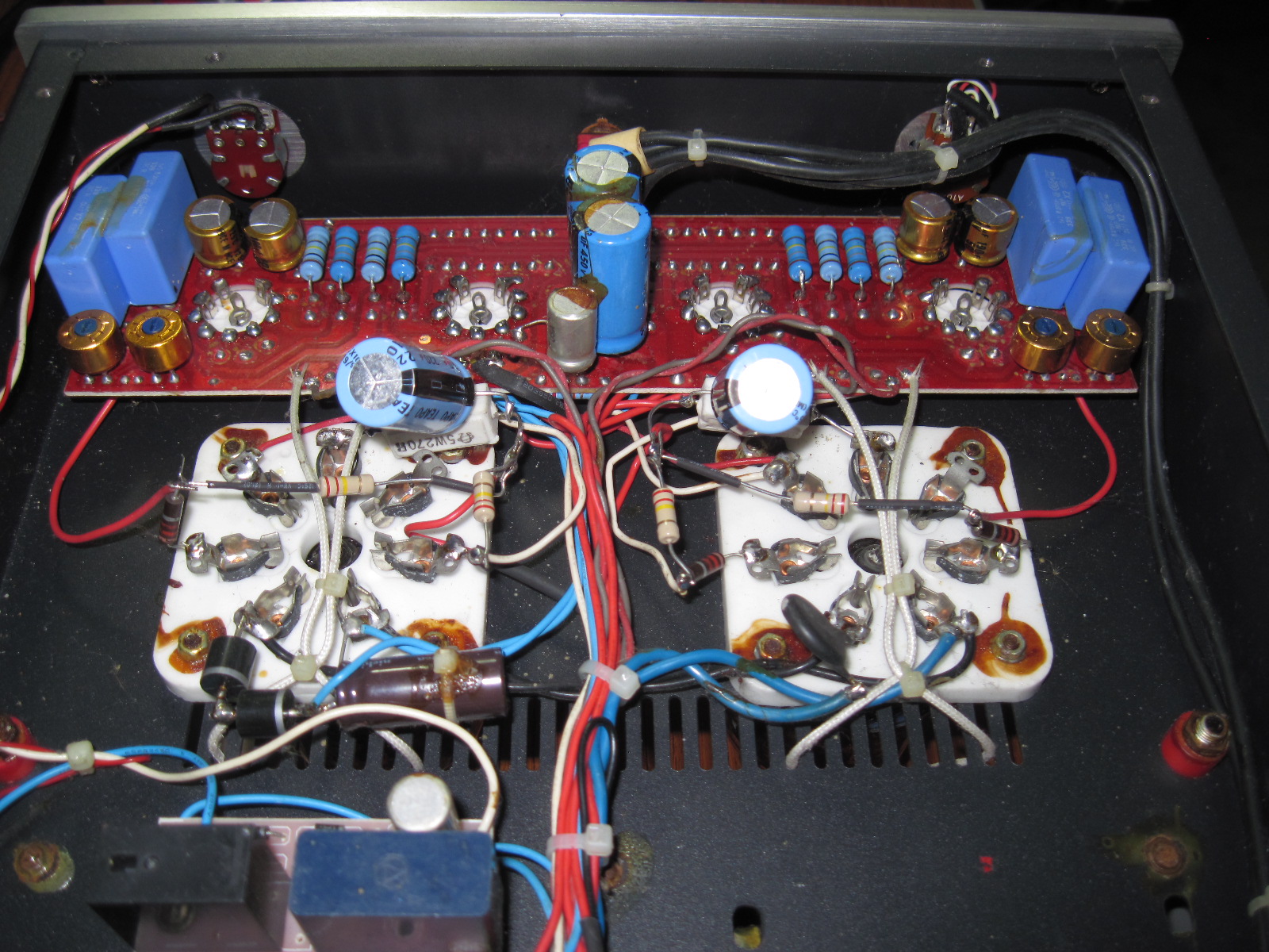

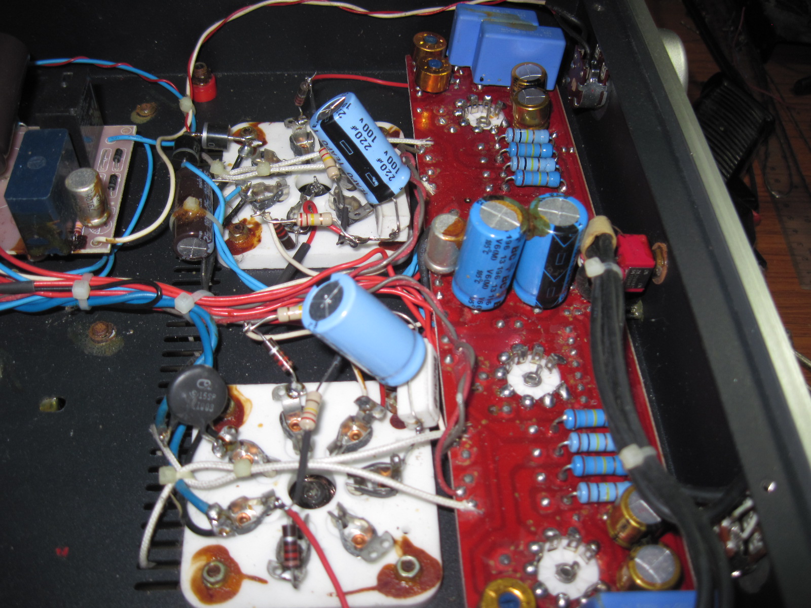

i had this amp sent to me for repairs...
the 829b tube on one channel tends to red plate...
so what i did was to convert this amp to cathode resistor bias
by cutting the negative supply line to the grid and
installing cathode resistors and grid leaks to ground...
so now this amp did not require fiddling with bias pots no more...
and as far as sound quality goes, the owner did not detect any difference
in sounds before and after the mods...
this is one such "hot" amp....

Some of the earlier variants not so good.
i would think so...this amp runs hot....
G2 supply can be improved by using a mosfet regulators...
B+ seems high so that filter caps run on the brink...
but otherwise, this is a good sounding amp, i am making my own version
using bigger power traffos and OPT's.....
