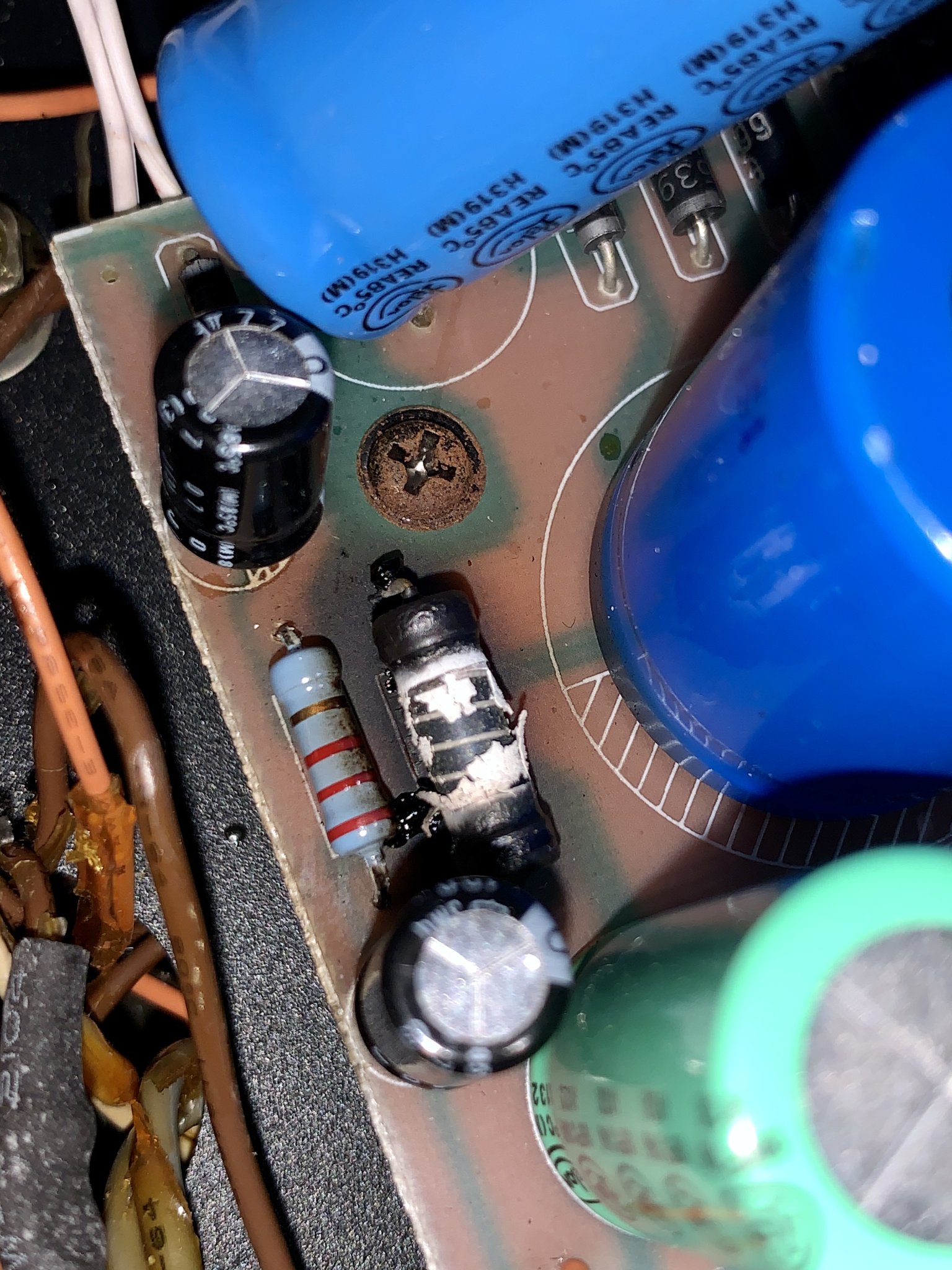

I got mine with a blown channel. I was able to assess that the issue was caused by a missing capacitor on the preamp tube socket board. When I removed the board with the sockets to look under, I found that one capacitor (22uF 100V) in the bias circuit was missing on the blown side. (See pics) this caused the bias resistor to burn and the 1K resistor on the power supply to burn also. I have since replaced all the PSU resistors and capacitors on the PSU board and on the preamp tube socket board.
One capacitor I am not sure of is on the Power supply board. This unit was already tampered with before me and that capacitor value seems off to me. In Pieros schematic it shows a 330uF 400v. I had a 33uF 400v installed. But I wonder if this is because Piero is in a 220v zone. Maybe the values change depending on the mains voltage ? Are you in the US.. ? 120v zone ? Can you confirm if that capacitor is 33uF or 330uF ?
Also can you please confirm what the value of the main power fuse is? And if slow blow or fast blow.
Please help me I’m stuck with this lol
Thx
