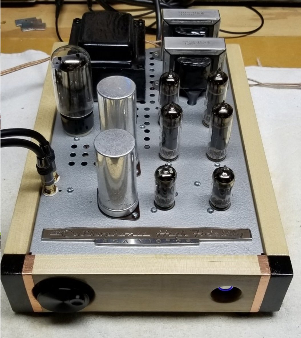

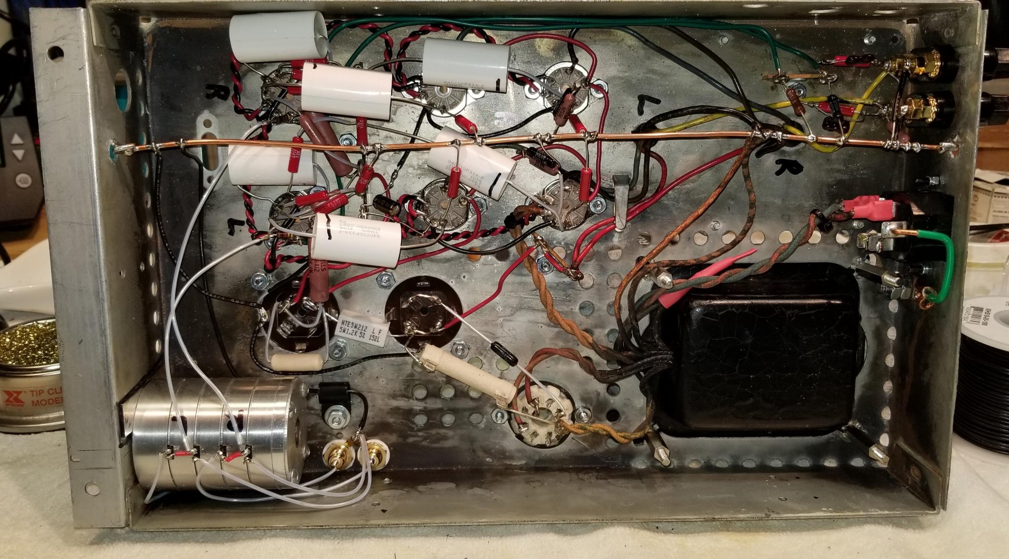

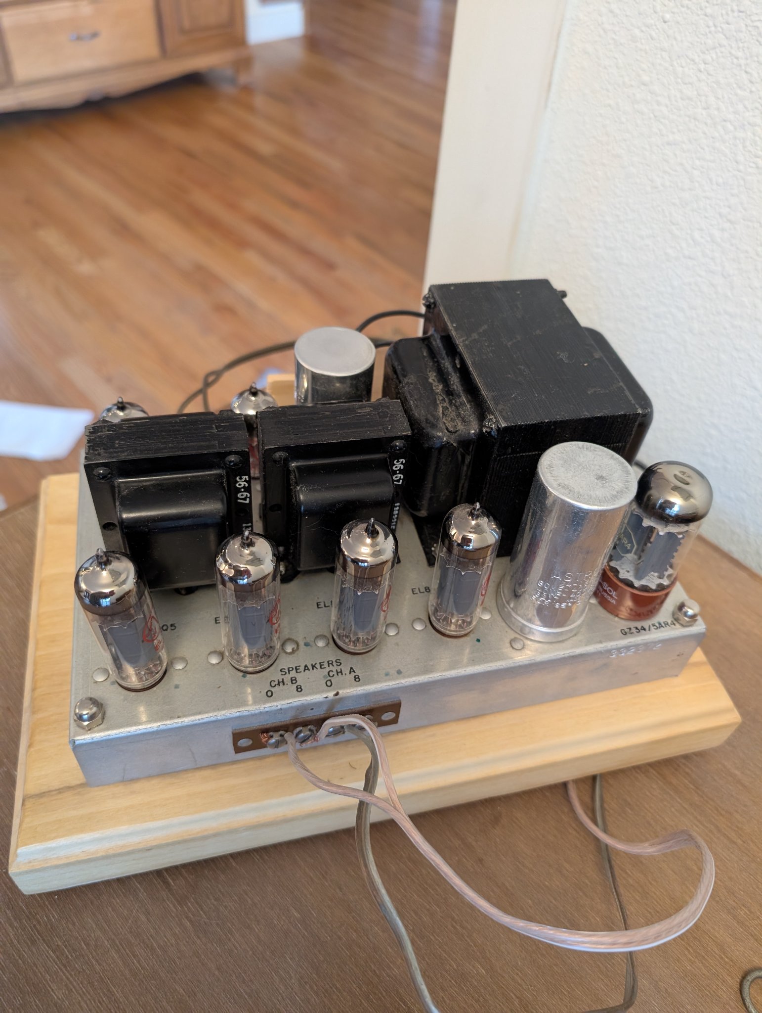

I have a Pilot amp from an old console. I recapped it quite a few years ago but only been using it a year or so. It sounds fine to me (76 yo ears with hearing aids). However, I'm sure I used cheap caps and I put JJ tubes in it. Are there specific places where really good caps would make a difference? Also, what tubes could I try.
A friend and I are planning to diagnose it soon. He just got an oscilloscope and signal generator. Then I think I should transfer it to a better-looking box. So, while I'm doing that, I may consider some changes.

If the schematic I found is correct, this uses several decoupling caps between 0.047 and 0.1uF. All these will have a sonic impact BUT the effect maybe somewhat diluted and a recapping to improve sonics maybe an expensive endeavor.
Not sure that the 'keep it original' argument holds since it's already recapped.
If you have used good, reliable Illinois Capacitors level caps I'd leave it alone.

You did not mention replacing the electrolytic capacitors. Judging from looks it appears you still have the original can capacitors. If you don’t experience hum or overheating of these capacitors now they can live/serve for a while. But eventually you will need to replace them. And since you are working on it shortly I would recommend replacing all the electrolytic caps now that you have not already replaced.
Your tubes are probably good if they test strong. What 12ax7s are you using? Investing in the best 12ax7s that you can afford will pay off in this location. JJ EL84 tubes are fine if you buy them tested. JJ rectifiers do not have a good reputation, but I see you have a nice Tungsol made in Russia GZ34 installed that should be good for many more years.

I used MIEC electrolytic caps (black and silver things) soldered under the chassis. The symbol keys told me what went where on those. Really knew nothing at the time (still don't) just bought what I could find that matched the parts list. Used red-dips for many of the smaller caps. Do still have the capacitors I removed. Maybe I should test them.

Would you consider MIEC a good cap? I'm guessing not as the most expensive was prb $5 and they are just hanging on their leads. Not that many hours on this amp so far, though.
I have not personally used MIEC capacitors, but they have a good reputation among the justradios.com crowd. Regarding 12ax7s, if I were in your shoes I would keep using my JJs and buy a good set of tubes as back up if and when you encounter a good deal. Taste in 12ax7s is a personal thing. I like Telefunken ECC83 but acquired them years ago before their prices got out of reach. Most NOS American and Western European 12ax7/ECC83 are very good and last a long time, so used ones are a definite option. I have not used JJ 12ax7, but have heard good things about their small signal tubes and several power tubes. Some user say they like JJ as well as NOS American.

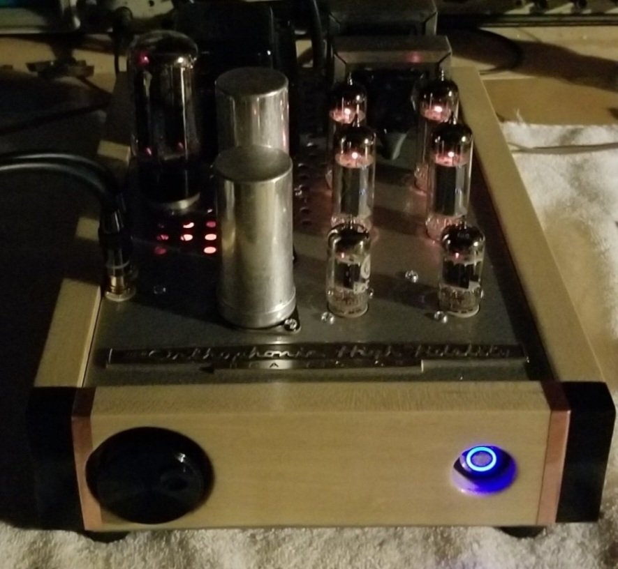

Finished amp, in case you're interested. The can caps are new CE caps with the lettering removed.

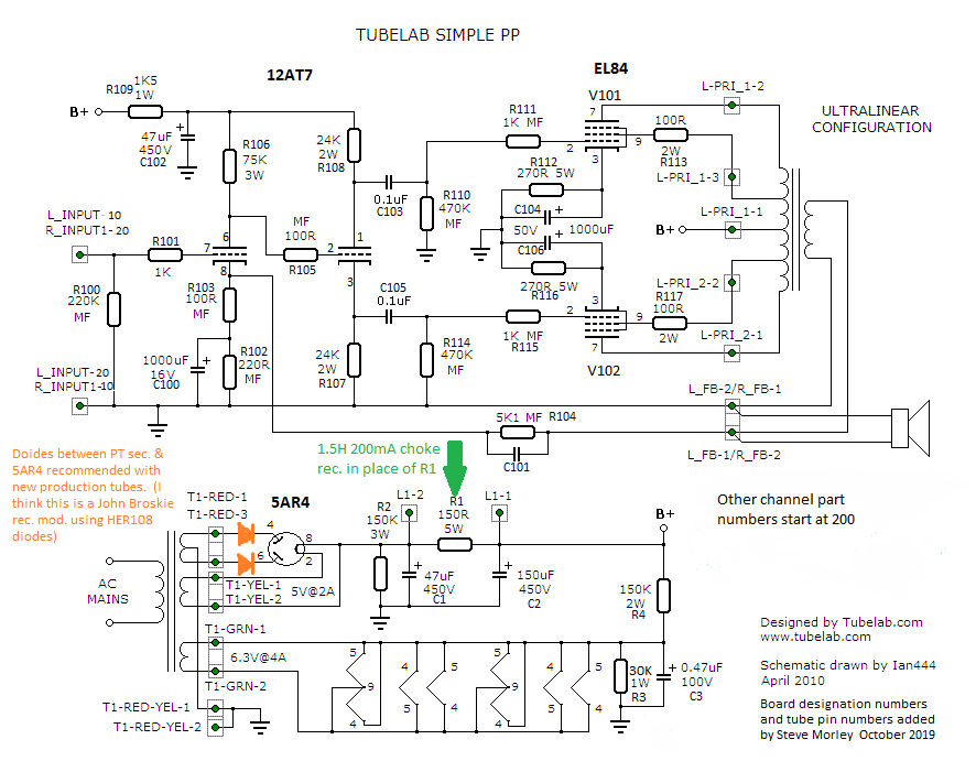

However, if you need to rebuild the amp (replace resistors and caps you have not changed yet) you could rebuild it to suit a different front tube, such as 12AT7 you suggested. Tubelab has a design, called SPP (Simple Push-Pull) that sounds good and works well with 12AT7. I don’t know the details of your amp (B+, transformers, etc) but the circuit is a starting point with your output transformers and power supply. I attached the schematic for you. Most people buy the Tubelabs PCB, but it will not fit your chassis, so point-to-point wiring is your option.
Is there a problem with your existing power supply and MIEC capacitors? If there is no problem I would not change the capacitors. If you must change the multi-caps look at: https://www.tubesandmore.com/products/capacitors?filters=746a130c112a746
Here is the Tubelab website with information on the SPP amp that I mentioned. https://tubelab.com/pc-boards/tubelab-spp/
@ Francois G, thanks for the info. Since there is a PC board and the project is a beginning level, I may be able to build that. It would be just for training, though. My Pilot is a rather nice, clean sounding amp w/ 15W/channel. I had thought about duplicating that design with improvements like multiple OHM taps on the output transformers and level controls. If I put 2 of those together, I'd have the ideal for my odd set-up. However, I was having trbl matching the power transformer from Hammond and just dropping in their output transformers likely wouldn't work unless I had enough knowledge to do some tweaking (because feedback circuits are probably fussy, among other things). Since I'm happy listening to what I have, I'm prb not doing anything near term beyond continuing to study. Thanks to everybody for all the advice.
