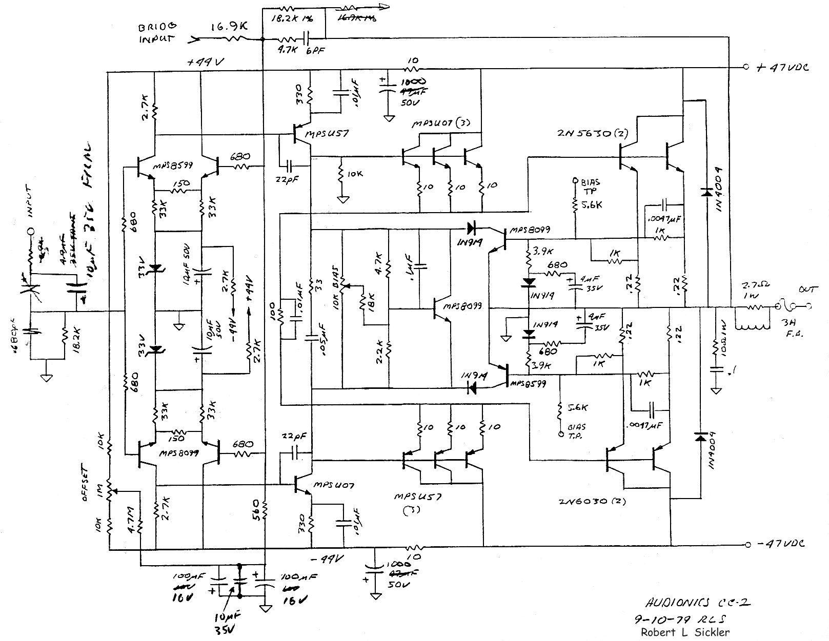

Here's a schematic, from a tribute article about R.L.Sickler at nutshellhifi.com:
....... It looks like this guy wired in 4 extra caps, but left the original ones there. Why would that be?
'Anybody's guess but perhaps the guy imagined it would be better to augment the capacitors rather than just replace the old ones since they are quite expensive and he had smaller values on hand.
Anyways, just because someone makes pics or videos of what they think is an upgrade, doesn't mean they have a clue what they're actually doing.
Actually, on a closer look at the pics showing the electrolytics, I believe those are polypropylene (MKP) or similar film caps which may be 2 -10uF, wired in parallel to the large electrolytics. Some believe this reduces the rising impedance of electrolytic caps at high frequencies and so improves the sound. I take back my comment about strange upgrades since this is widely used, particularly in older equipment with standard grade components.

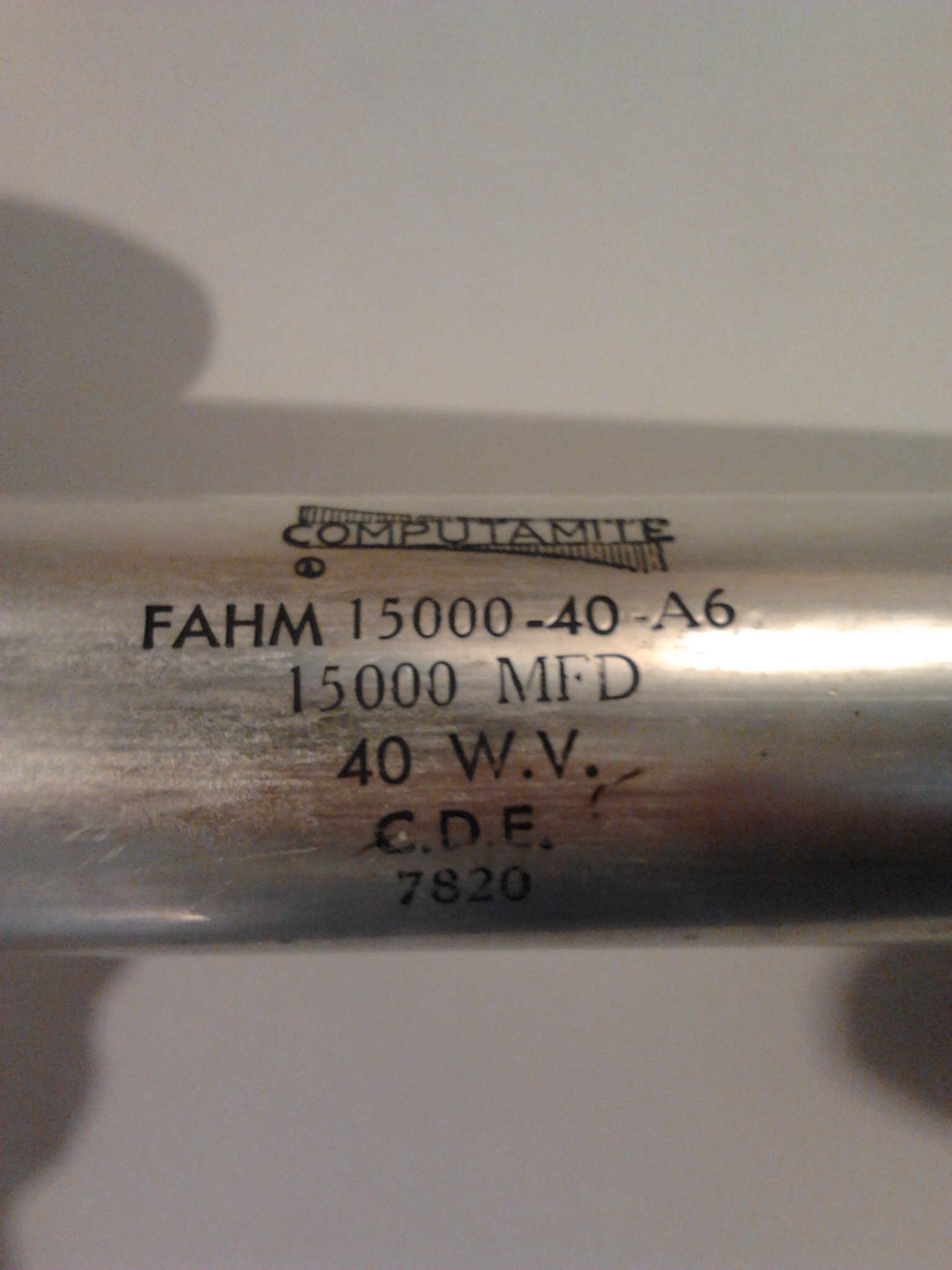

So Here's a photo of the big caps I've gotten out.
Might these be a good choice for replacement ones? Mallory CGS233U040V4C Capacitor 23 000uF 40 VDC | eBay
Seem to be similar size, and slightly larger rating as suggested. I just wonder about how mine say 40 W.V. and these say 50 Volt max surge. Just different lingo, or is there a technical difference?

Electrolytic caps have indeed shrunk dramatically over many years. A peak or surge rating is no longer generally used because of confusion, as you find. Simply ensure that the marked voltage rating is at least 10% higher than the rail voltage your caps are going to have to work at. As your specified rail voltages are +/- 47V, better use the higher standard value of 63V. The 10,000 uF caps specified for the rails are shown as 50V only, which is too close for safety if there are mains variations. So those parts you listed would only be suitable if your amplifier power rails were 35 Volts or less, which isn't the case. If they are being used elsewhere, they are being wasted as the specified values on the schematic will be fine.

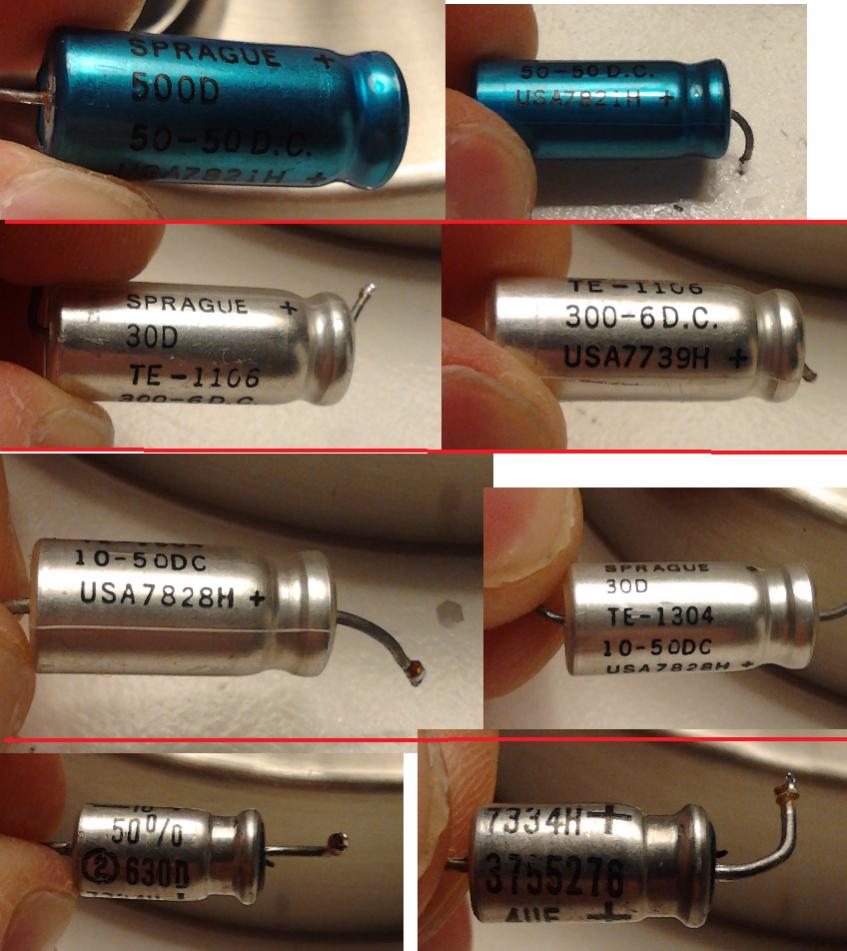

Cap values
Pardon me for being so newbie, but I'm finding these capacitors hard to understand. No microfarad value is given (except the bottom one 4uF), seemingly just a D.C. value.

Physical size is the main difference for all replacement caps you will be considering. Nothing will simply fit the same as you see when you start looking for equivalents, regardless of the component's alleged quality and the promotional pitch about being designed for audio use.
The most difficult change is that all those smaller electrolytics in your pic. are a style known as axial. That is, their leads run on the circular axis of the part and emerge at each end. This suits the old style electronic designs that were built on tagboard, long ago. There are now very few capacitor types available in this style and it is often cheaper and simpler to bend out the wires of a radial component (leads come out one end, spaced on the same radius).
Make sure there will be room for tall components to fit in the case when mounted this way. Adhere them to the PCB with a small blob or 2 of neutral cure silicone adhesive for stability - don't use hotmelt glue that just melts again with the heat inside. Also, don't just rely on the leads to hold larger parts when spread this way. Secure the cap - you can see what happened to one of the larger caps, possibly caused by lead stress.
