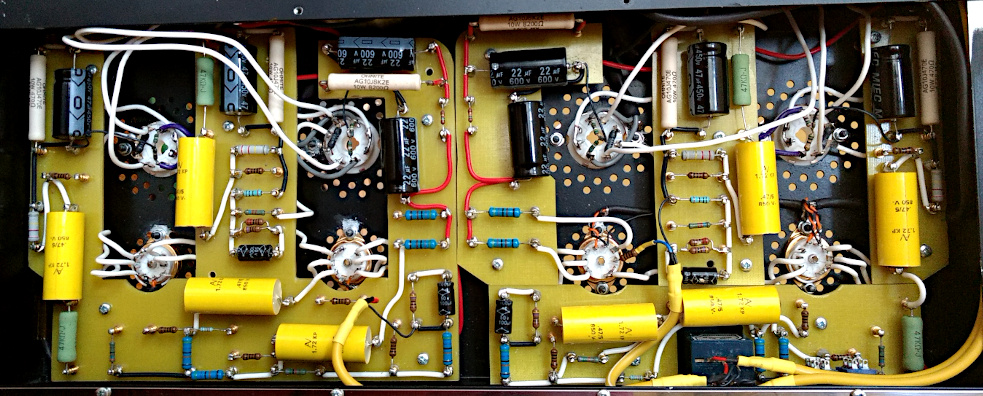

I'd go over both boards and re-low each soldering points (yes it's a major pain to remove them from the finished amp. If that doesn't do it, try moving the wires around?

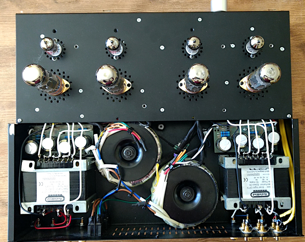

@petertub yes, speaker hum. There is no transformer hum on this amp. now that was interesting! Removing either preamp tube removed pretty much all hum, With both driver tubes out, I couldn’t tell if the amp was on, same result if I pulled the input preamp tube, dead quiet. I guess that means that the hum is induced in the preamp tubes, most likely the input Hm. Maybe a ground loop with the input circuit?
@fb2017 it seems to have all options, dual pts, dual power boards, extra filtering stage top right on both channels. They have the newest transformers, I had to get an addendum to the manual with the right colour codes. I thus have separate windings for the heaters for each tube (all have been referenced to ground). I havn’t reflowed all solder joints...
I actually have a second amp, in all but tranformers an edison 60, but with smaller transformers and intended for 6v6 or 6l6 tubes, 15 watts. It similarly hums quite a bit...
Removal of driver tubes tells us that hum comes from a point before@petertub yes, speaker hum. There is no transformer hum on this amp. now that was interesting! Removing either preamp tube removed pretty much all hum, With both driver tubes out, I couldn’t tell if the amp was on, same result if I pulled the input preamp tube, dead quiet. I guess that means that the hum is induced in the preamp tubes, most likely the input Hm. Maybe a ground loop with the input circuit?
power tubes and that the power tubes are reasonably matches current.
Is the hum present if shorting plugs ( inputs are shorted ) ? If it hums then i would test another 6922
tube(s) as hum may develop between filament and cathode.
One could also try parallelling the C106 ( last electrolytic cap in the B+ chain) and note the effect.

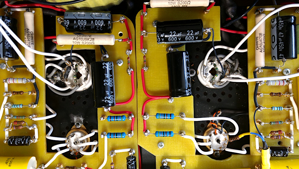

First time post and only recently found this thread.
I built an Edison 60 kit, and hope my comments add to it.

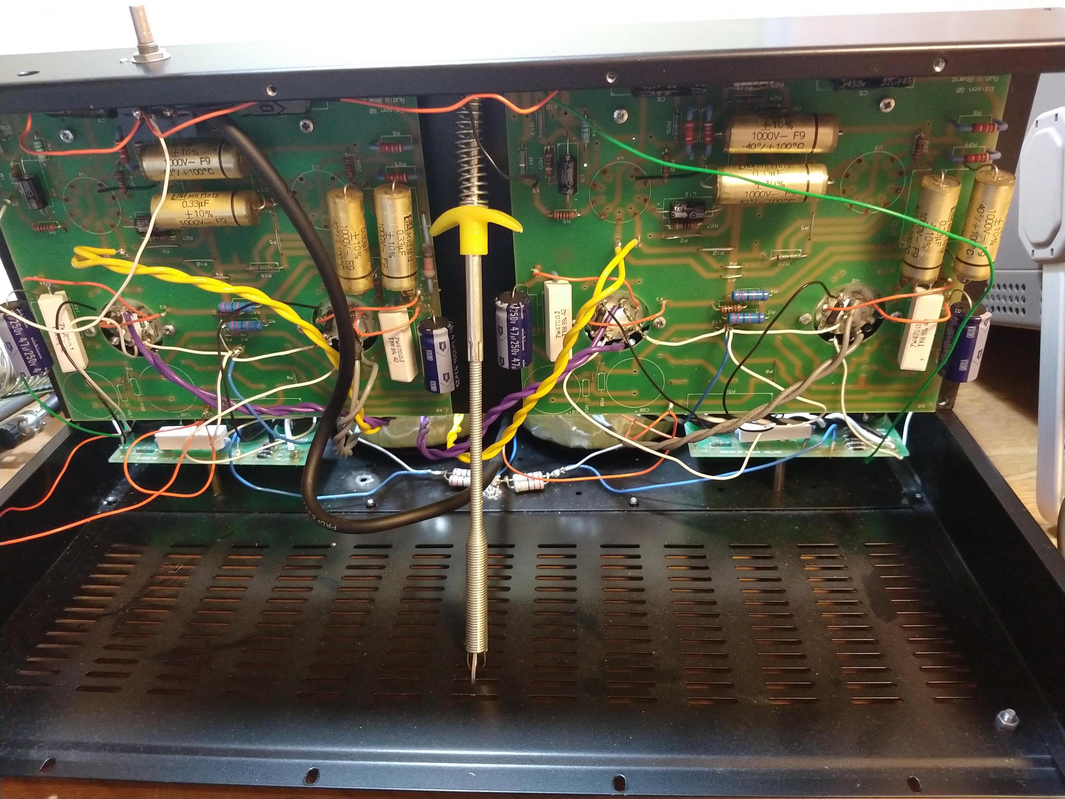

@Leffler I too had a bad hum from one channel with the other quite noisy. Changed the supplied E88CC's with JJ E88CC's and the hum and noise disappeared.
However..... I do have an interesting effect. I have the volume control fitted and R101/201 removed. With the volume at zero and in most other positions the output on both channels is quite noisy, however when the volume control is at about the 10 O'Clock position the output is “tuned out” and completely free of noise - fortunately it’s where I'd normally have it.
The noise is present regardless of whether the input is connected or open circuit. I've not tried shorting the input.
I've 'scoped the preamp valve outputs and cannot really pin it down, so I'd be interested in your views. The good thing is it can be tuned out so I can live with it.
I did try it without the volume and with R101/201 fitted and it was noisy with or without an input.
For info, the input is connected to an ANK Line 4 line phono preamp kit which is completely silent.
On a separate matter, how good have any of you found the quality of the Edison 60 kit to have been? First, to state that my background is electronic prototyping so I'm used to dealing with most issues and I expected there to be some fettling, but I was surprised at some of the issues with my kit.
Mechanically there's a tolerance issue between the boards and metalwork. The boards initially wouldn’t fit as the valve bases and mounting holes were mm’s out even with the boards pressed hard up against the metalwork. The only way I could get them to fit was to shave few mm’s off the board edges as close to the nearest track as possible (it’s a ground track fortunately), and elongate the board mounting holes about 5mm. The board is still pressed against the metalwork and I was just able to get the valve bases to align between the metalwork holes and board solder holes.
Electronically, I've had to replace the higher power resistors R8, R18, R29, R30 and R31 on both boards. After a few months use they were all very discoloured/burnt from excess heat, and in fact R30 and 31 were cracked too but not O/C. All of the resistors had been mounted to allow for free air movement.
Additionally, the left channel suddenly developed a hum, traced to C5 becoming open circuit (blown out and leaking). Voltage tolerance was 450V and was close to the actual voltage. Replaced with a higher voltage tolerance on both channels and now fine.
I’m UK based so ambient temperatures aren’t high, and there’s always been reasonable airflow around the amp.
Overall I love the sound of the Edison 60 and enjoyed the build, and hope my comments will help others.

@Nickdp, my first post too....I also built an Edison 60 kit a few months ago, with pretty much all the options fitted (ie dual power supply, additional power filtering, upgraded signal caps, resistors, output transformers). Also very pleased with it - currently running it in Triode PP mode.
During the build I had the same problem as you with the alignment between the valve holders and metal work, although I managed just by elongating some of the holes rather than shaving the PCBs.
The other problem I had when I first powered up (with UL connection) was oscillation due to positive rather than negative feedback, due to the output transfomer printed labelling not being consistent with the actual windings....cured by reversing all the primary connections. However, I swapped to triode mode without global negative feedback, which I prefer anyway.
I just checked the resistors you mentioned....I can also see evidence of R18 overheating, but not the others you mentioned. However, my kit was supplied with 6N1Ps rather than E88CCs. Also, R30 and R31 were supplied as 10W resistors, rather than the 7W specified in the standard parts list.
I had a minor hum problem in one channel, but swapping the input and driver 6N1Ps in that channel cured it.

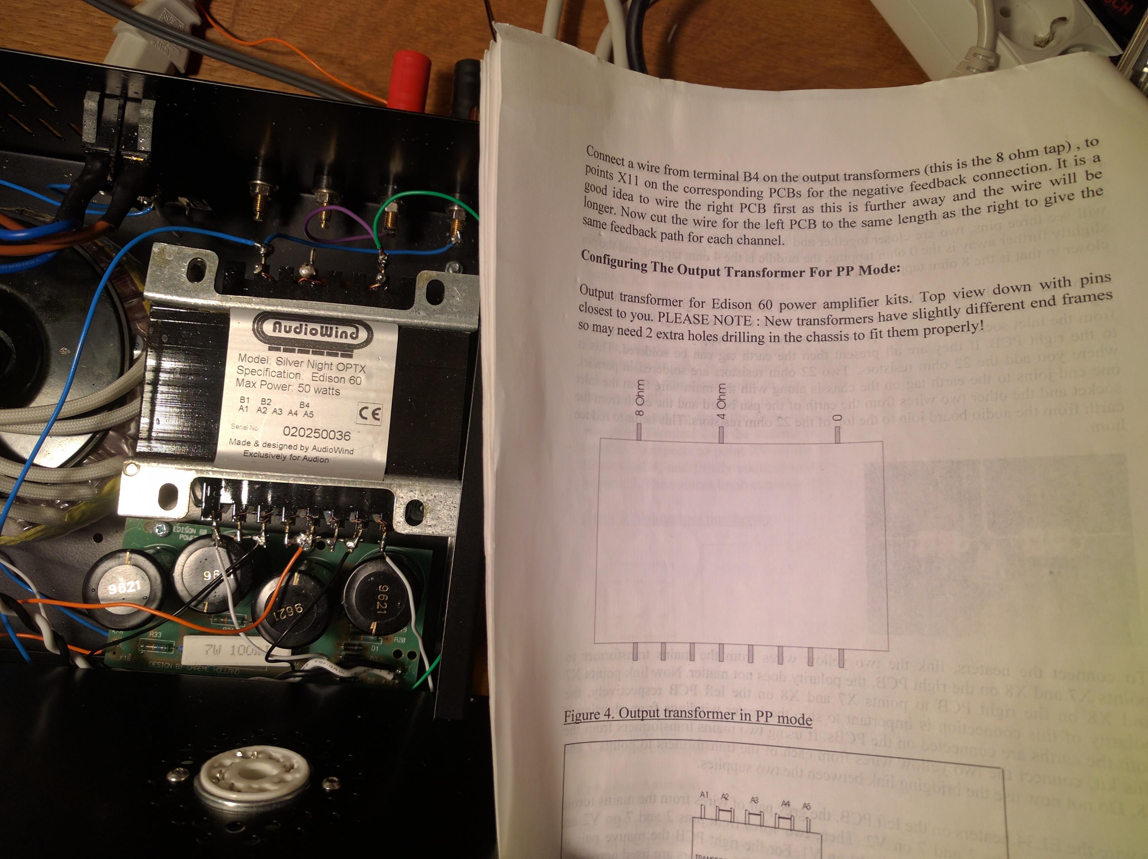

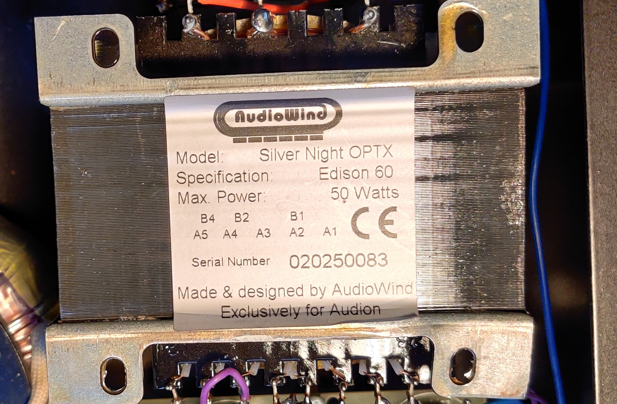

So the B1 on the transformer with the 2 blue wires coming from it are the + positive 8 ohm tap, the B4 with the green and purple wires are your -0 negative ohm tap.

Hi FB2017
The label on my OPTXs has A1-A5 and B1-B4 the other way round to yours (see photo). When I contacted the company they did say they had a batch that was incorrectly labelled, but said that the 8 and 4 ohm taps are the two closer together...this seems to be the situation you had. In my case the labelling is consistent with the instructions but - as I discovered recently when trying the 4 ohm tap and wondering why the output was so low - actually the 8 ohm tap is the one on the right. So it seems in my case that the transformers were actually assembled wrong...
Steve

The output transformer labelling issue is very confusing. I've just checked mine and mine is the same as @fb2017.

@NickDP
I just re-read your first post. I've just recently been making a few tweaks to mine including playing with the negative feedback - adding 330pF across the feedback resistor to get rid of some ringing in the square wave response.
When I did this I ended up with some quite buzzy hum from one speaker when the volume control was zero/low which disappeared when the volume control was higher. Sounds similar to what you are seeing? I connected my scope across the speaker terminals - and found it was oscillating at about 1.7MHz. Connecting a 10 ohm resistor and 100nF capacitor (in series) across each speaker to damp the oscillation seems to have cured this, and both channels are now very quiet at all volume settings.
Not sure if this is the best or only solution - maybe someone more expert will chip in - but you might want to try similar

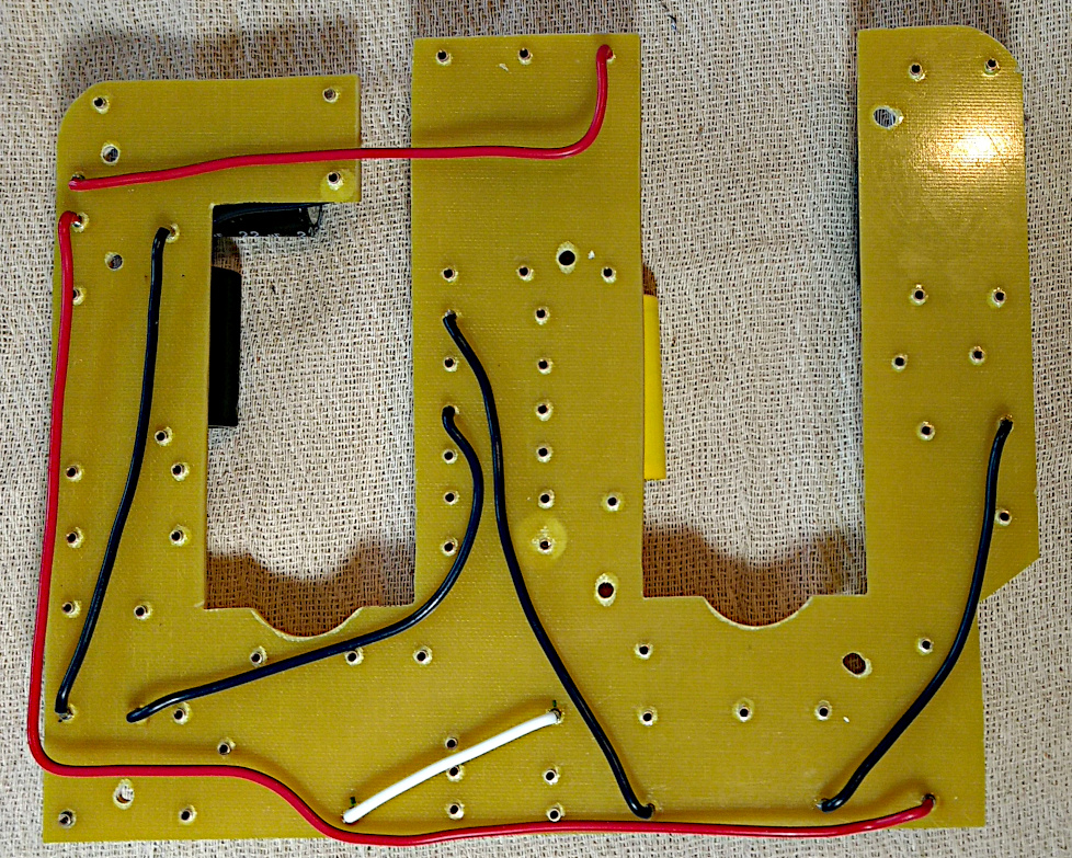

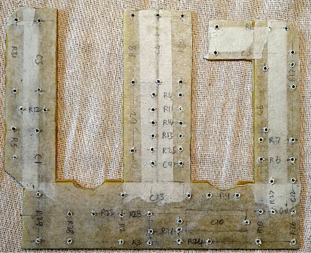

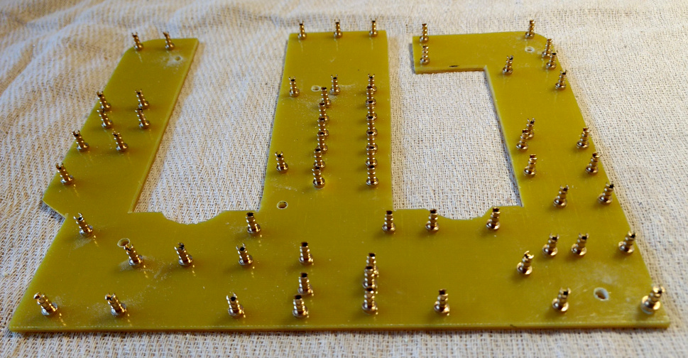

Lockdown has a lot to answer for, especially when I have too much time on my hands, and as a result I decided to rebuild my Edison by scrapping the PCB's and going for old school point to point wiring with tag boards.
I designed the tag board layouts, making sure there were as few crossed wires as possible, and that interconnects to the valves etc were as short as possible. The boards are 3mm G10 FR4 Fibreglass board from Ebay, and Glasshouse gold plated turret tags from hificollective, pressed in using my drill mounted in a stand as a makeshift press with the insertion tool in the drill chuck.
I cut the first LH channel board into 4 rectangles, and because it worked so well I used the pieces as a template for a single board for the second RH channel.
To make things more interesting I made the RH channel a mirror image of the left to make it visually more appealing. However it was quite challenging when it came to wiring everything up, as the valve holders had to be rotated around and I had to ensure all the connections went to the right places.
The advantage of the these turrets is wires can be inserted from underneath the board, which made for a much neater job on the top.
The valves are JJ E88CC’s and Genalex Gold Lion KT77’s which give a rich sound with plenty of bass.
The end result is…... it sounds exactly the same as the PCB version! But I’ve had a lot of fun doing it and especially how it looks visually. Ideally I’d redo the original LH channel as a single board, but I’m about to start building an Audio Creative DDAC 1794 so it will have to wait.
Issues I previously had with noise etc are still exactly the same, so the layout isn't the issue. I'll continue to look into this to get it as quiet as possible at all volume settings.
