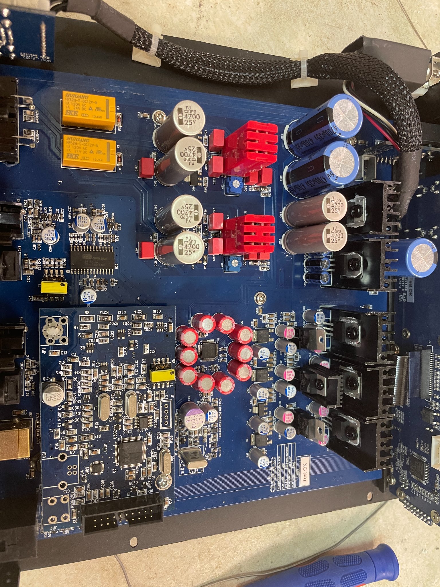

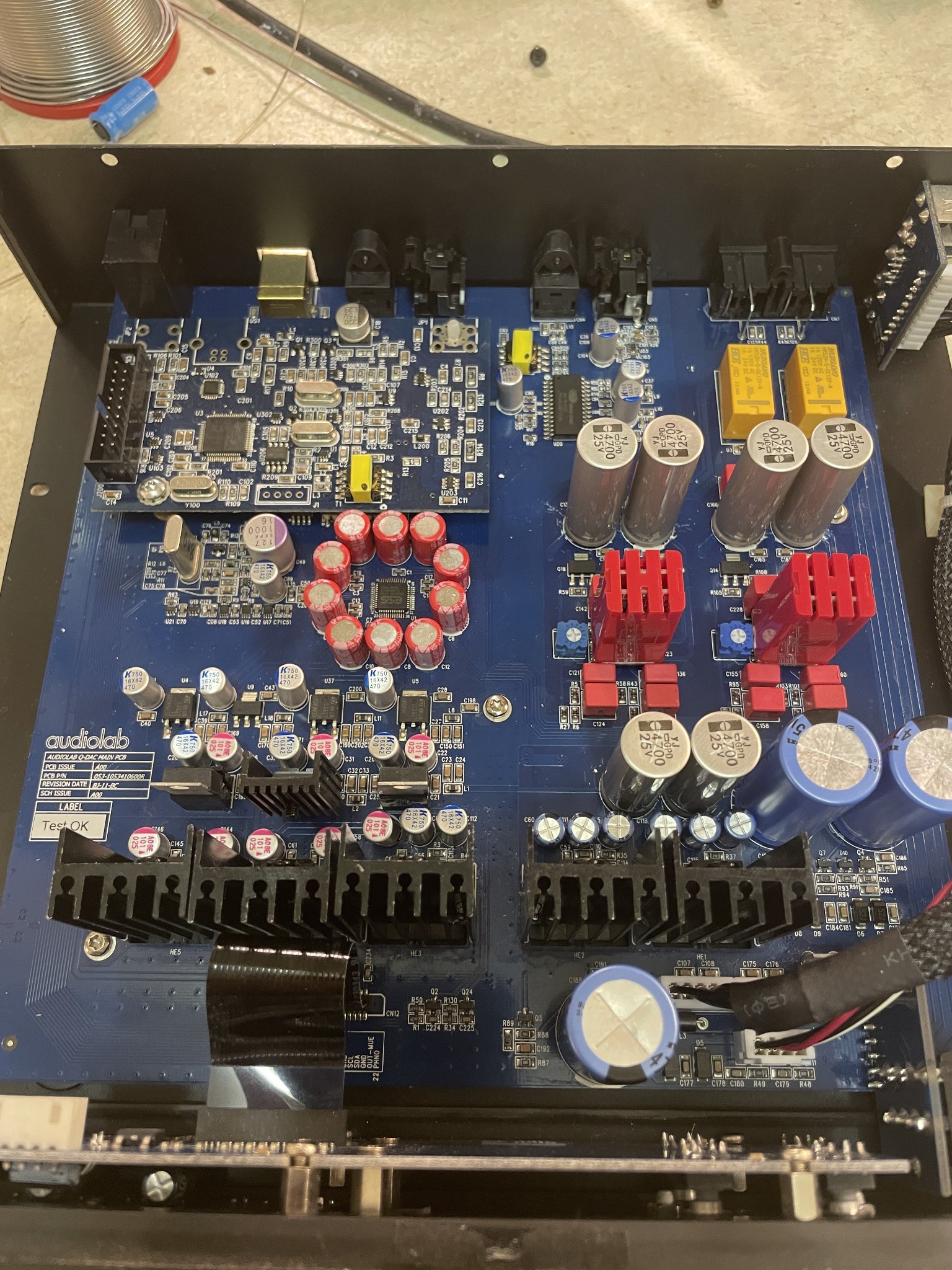

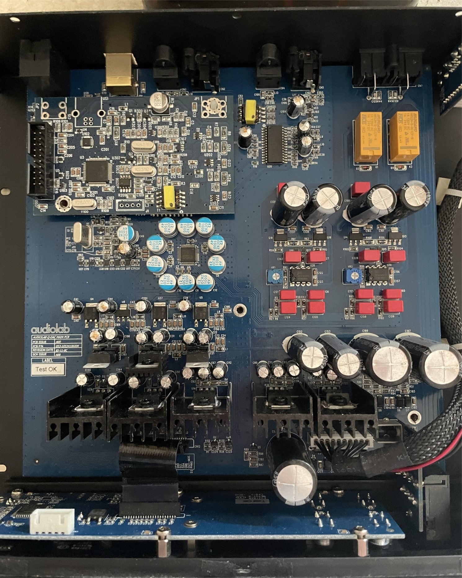

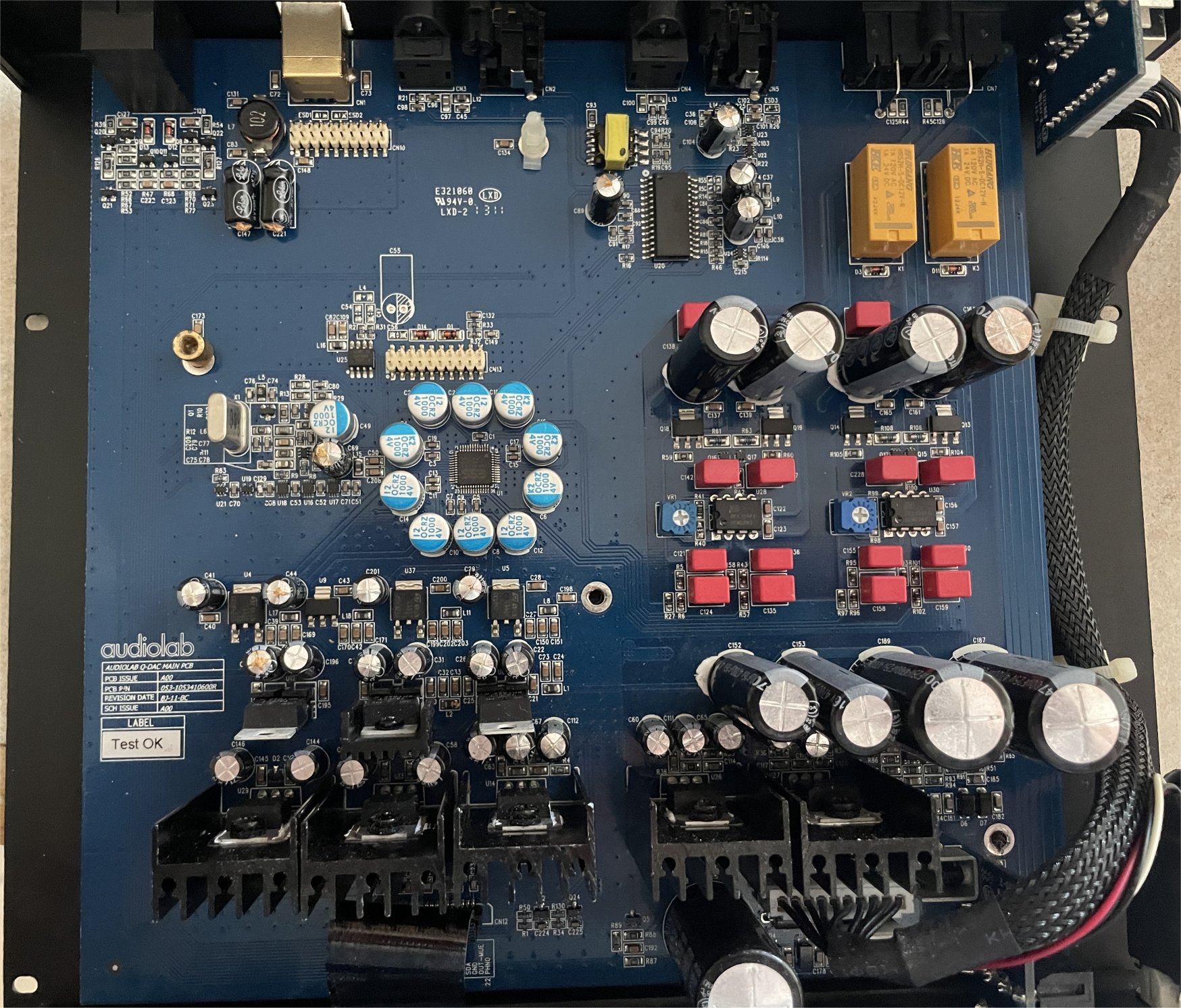

Thread created to document 'upgrades' to an Audiolab Q-DAC. Hopefully useful to others by the end
This is apparently the M-DACs poorer sibling, but it has proper 8 pin DIP output op-amps and enough functionality to also pose as a pre-amp
This thing wasn't super expensive on a well known auction site so I went for it. I swapped out my STAX DAC talent and the initial reaction was 'meh, well at least it works'
After a week or so of listening it was time to "pop the hood"
So Pictures!!

So here follows a slightly incomplete list of electrolytic Capacitors - MM means 'obstructed couldn't see the value' and I didn't bother with the USB daughterboard (it's 220at 16v)
470uF/6.3v on a 5v line? = 🤮
The polymer 4v ones around the DAC look fine though
