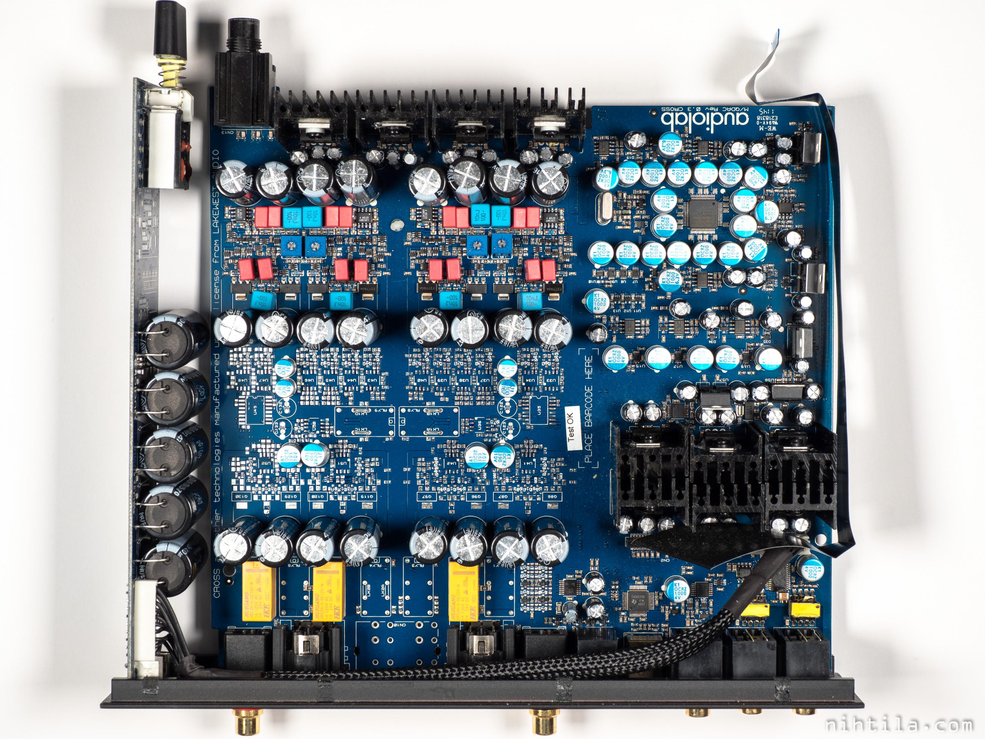

Bad Caps in Audiolab's M-DAC

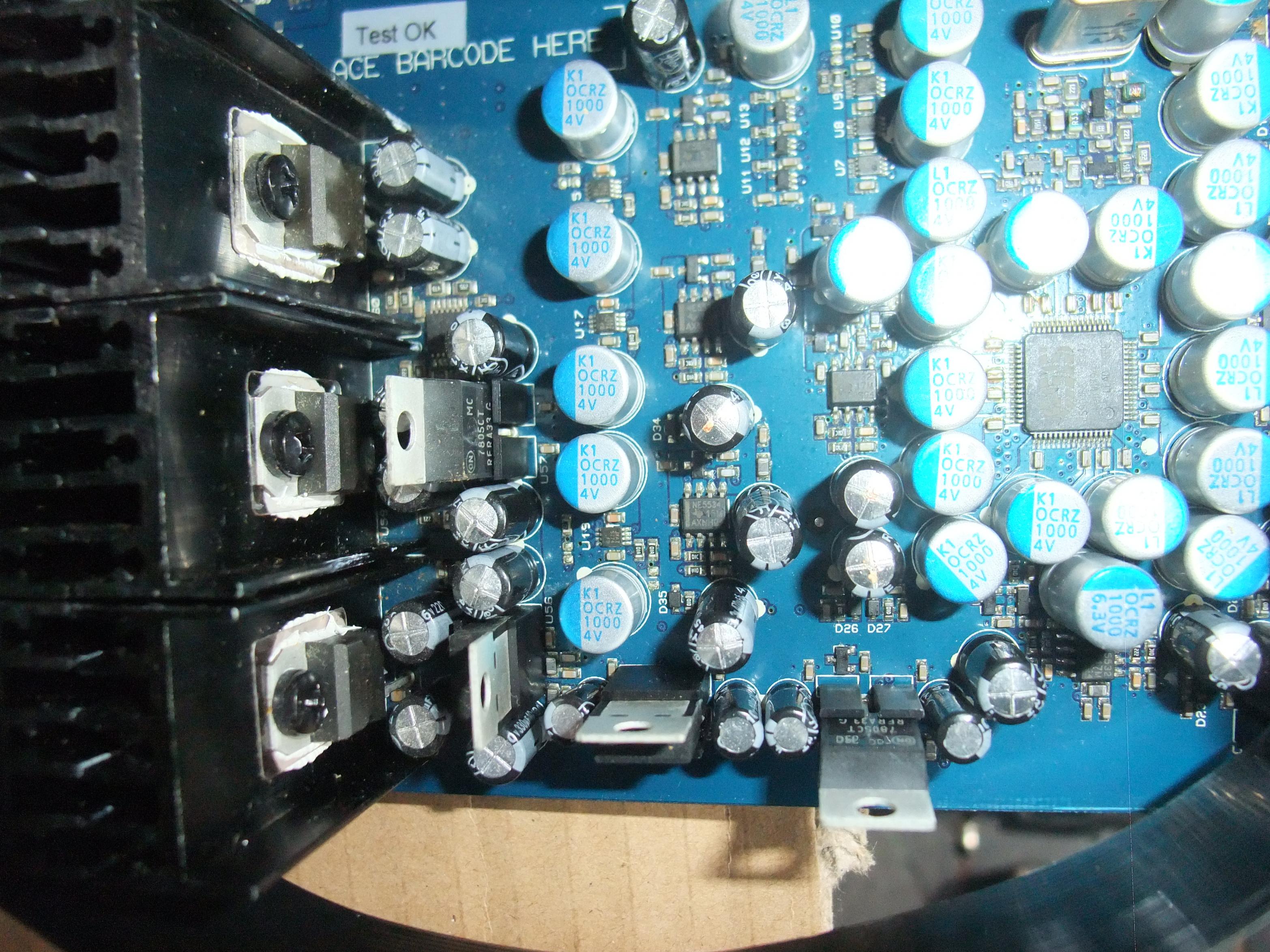

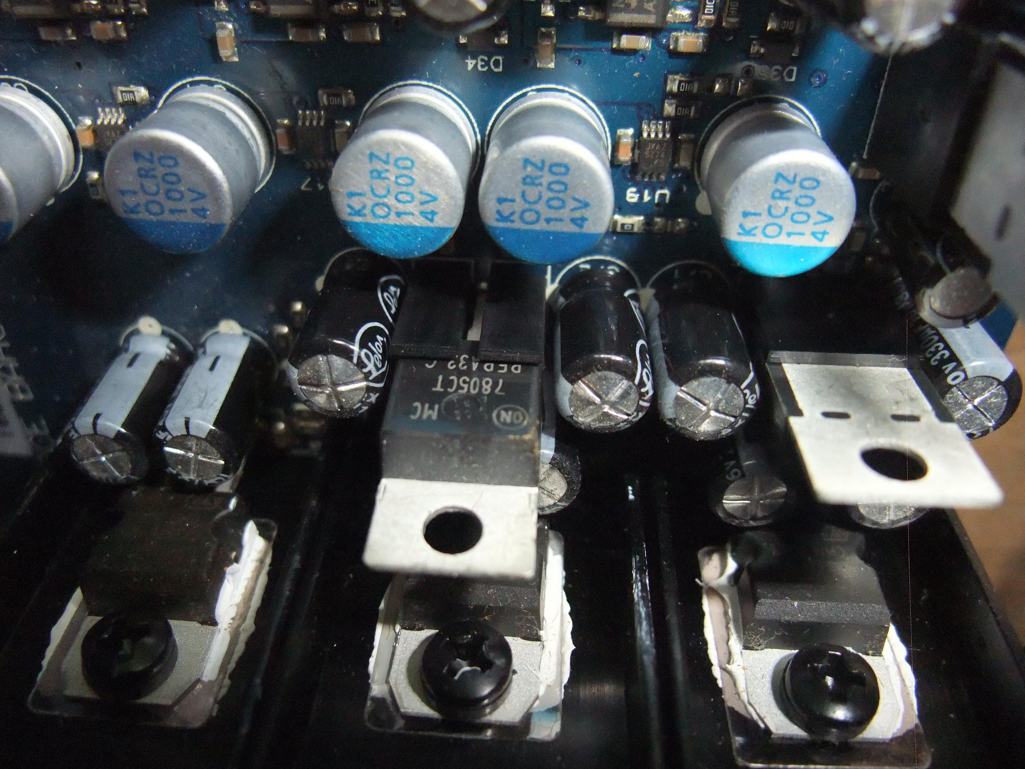

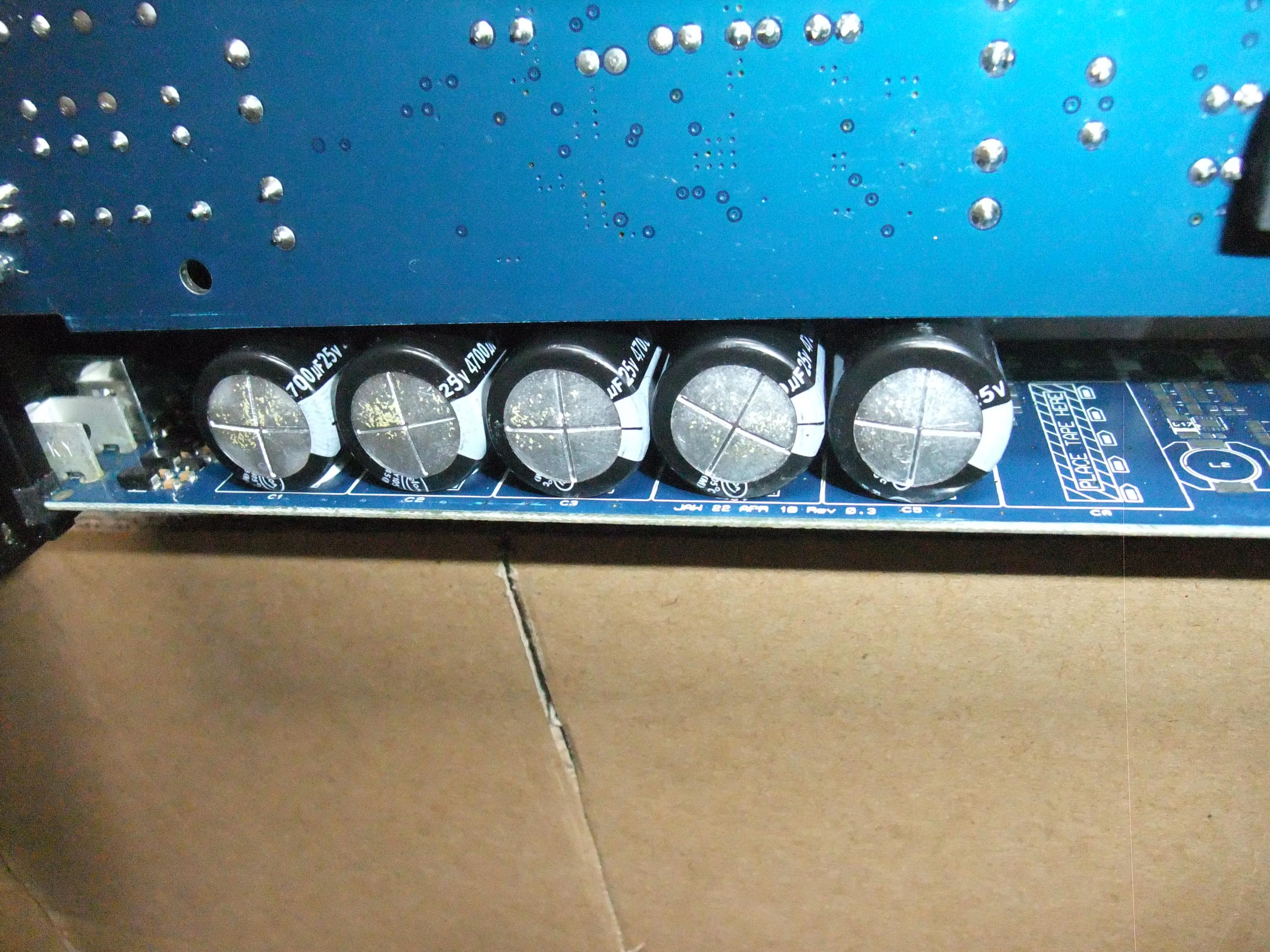

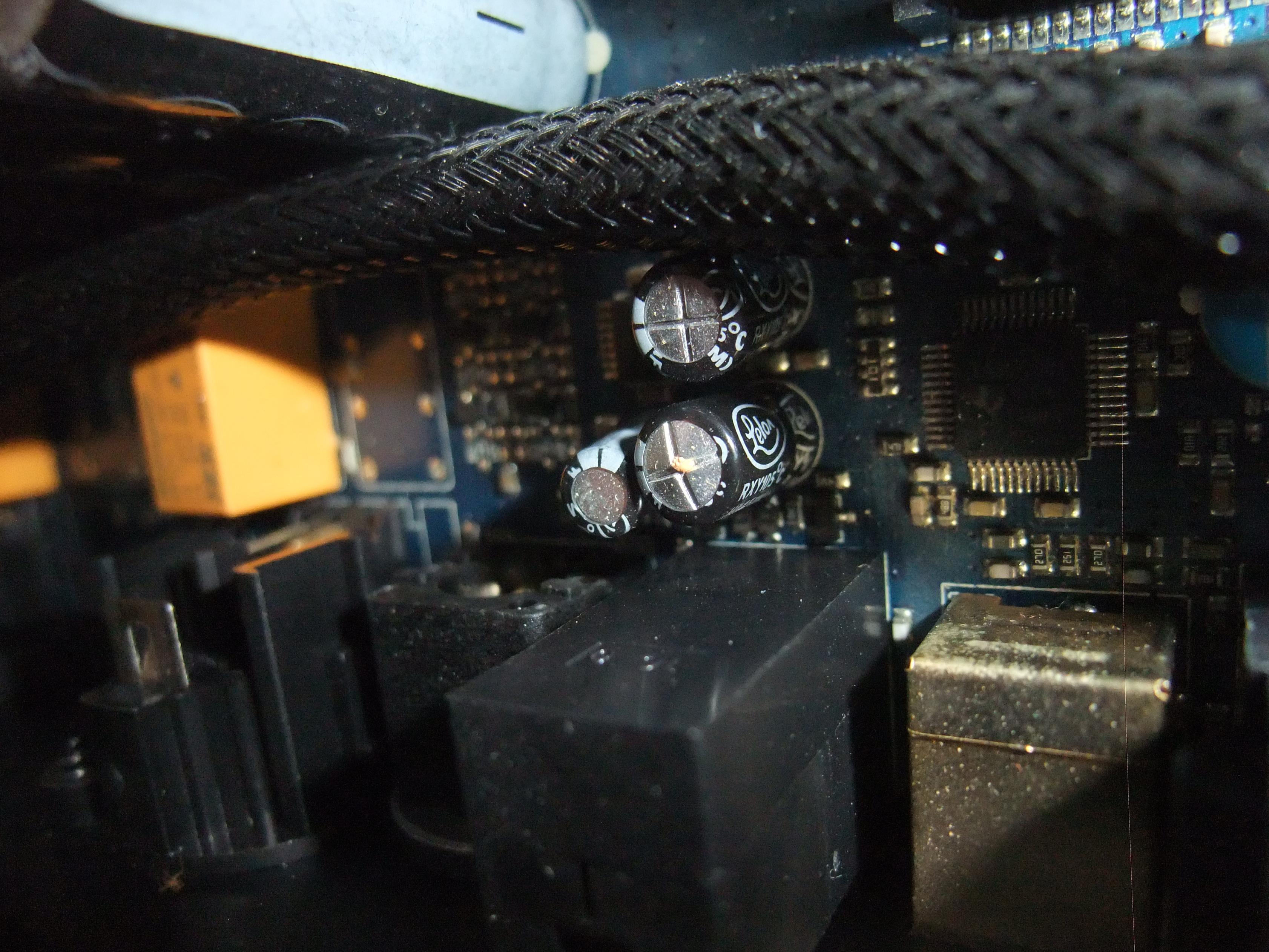

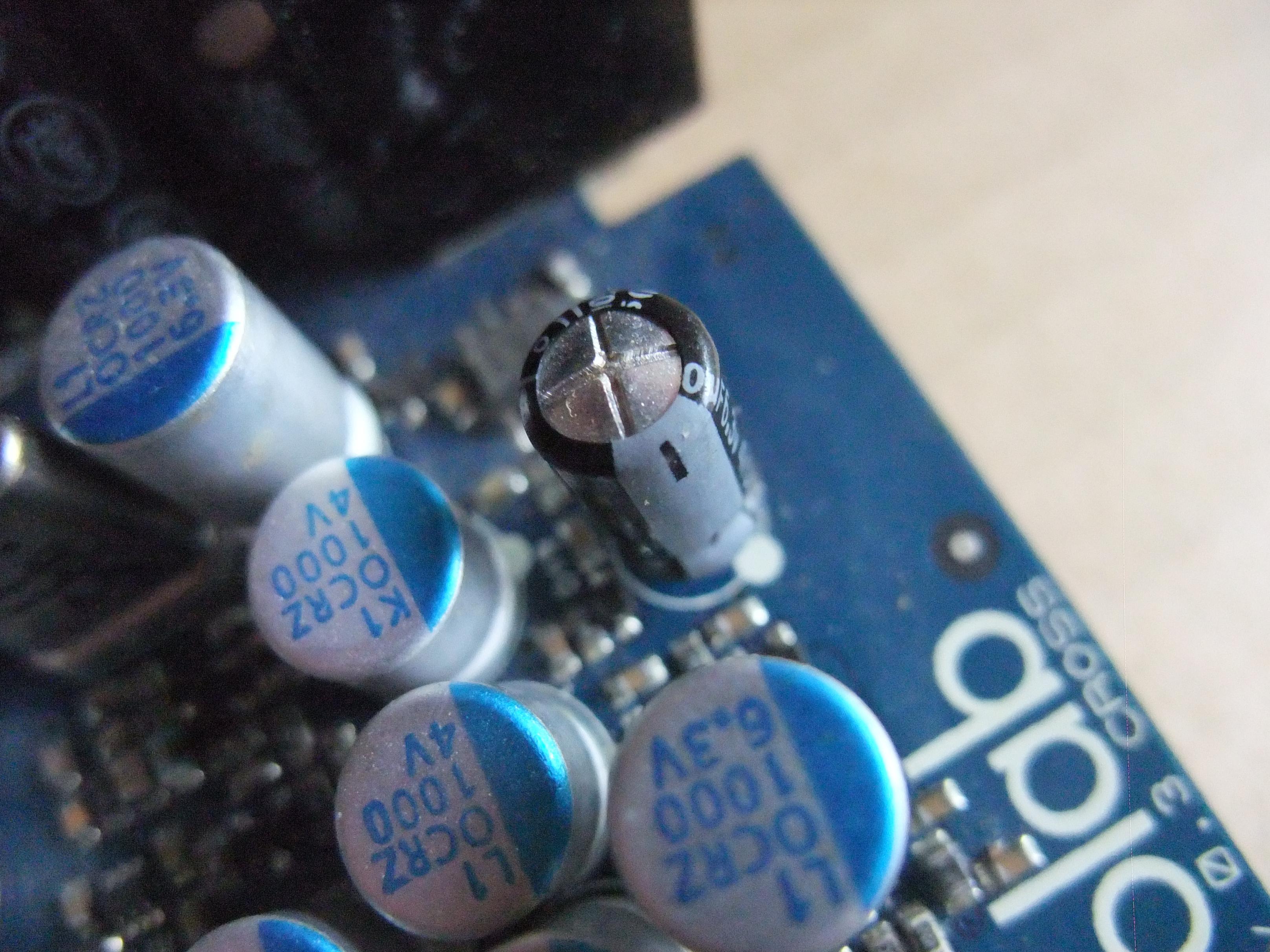

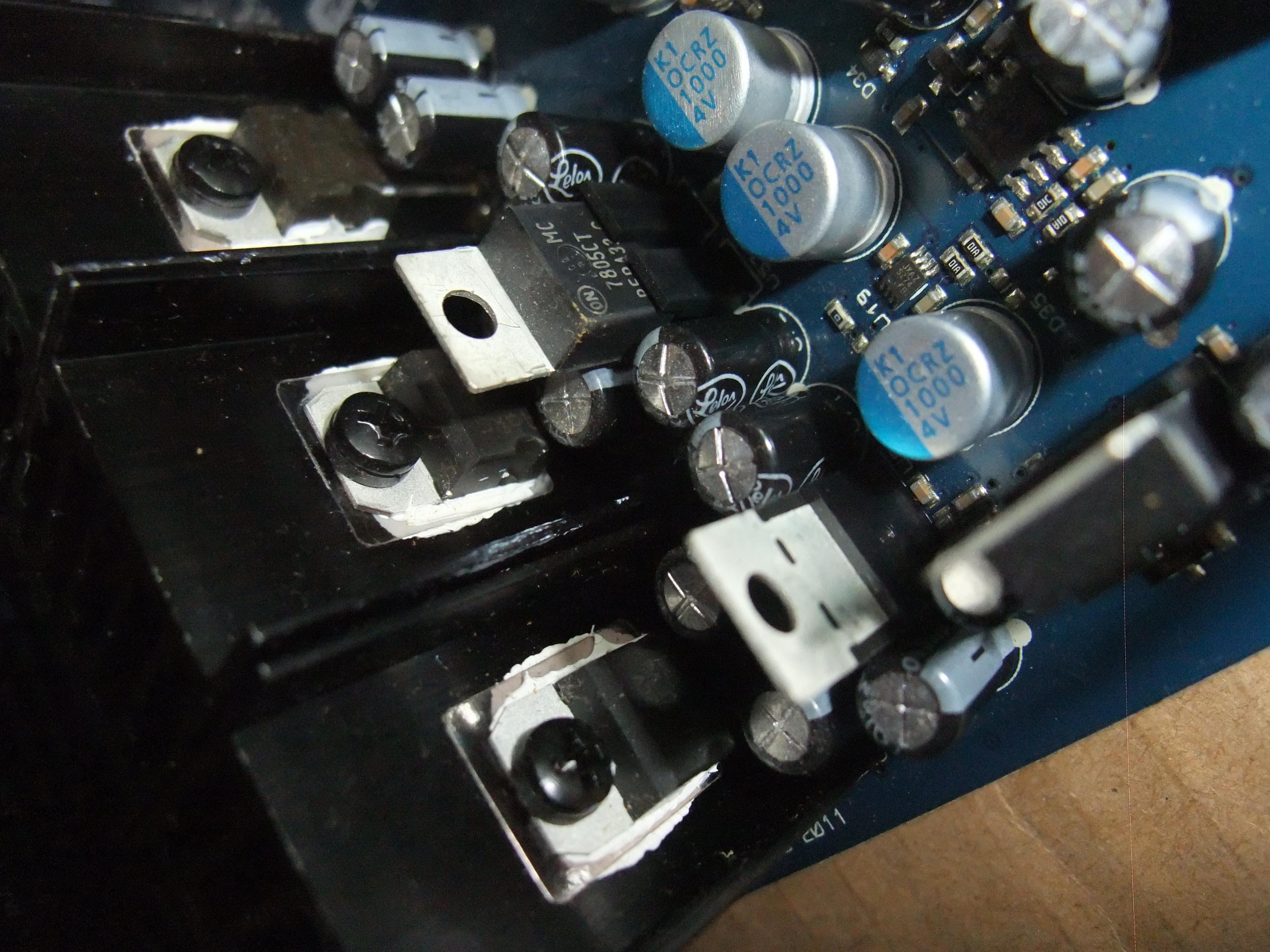

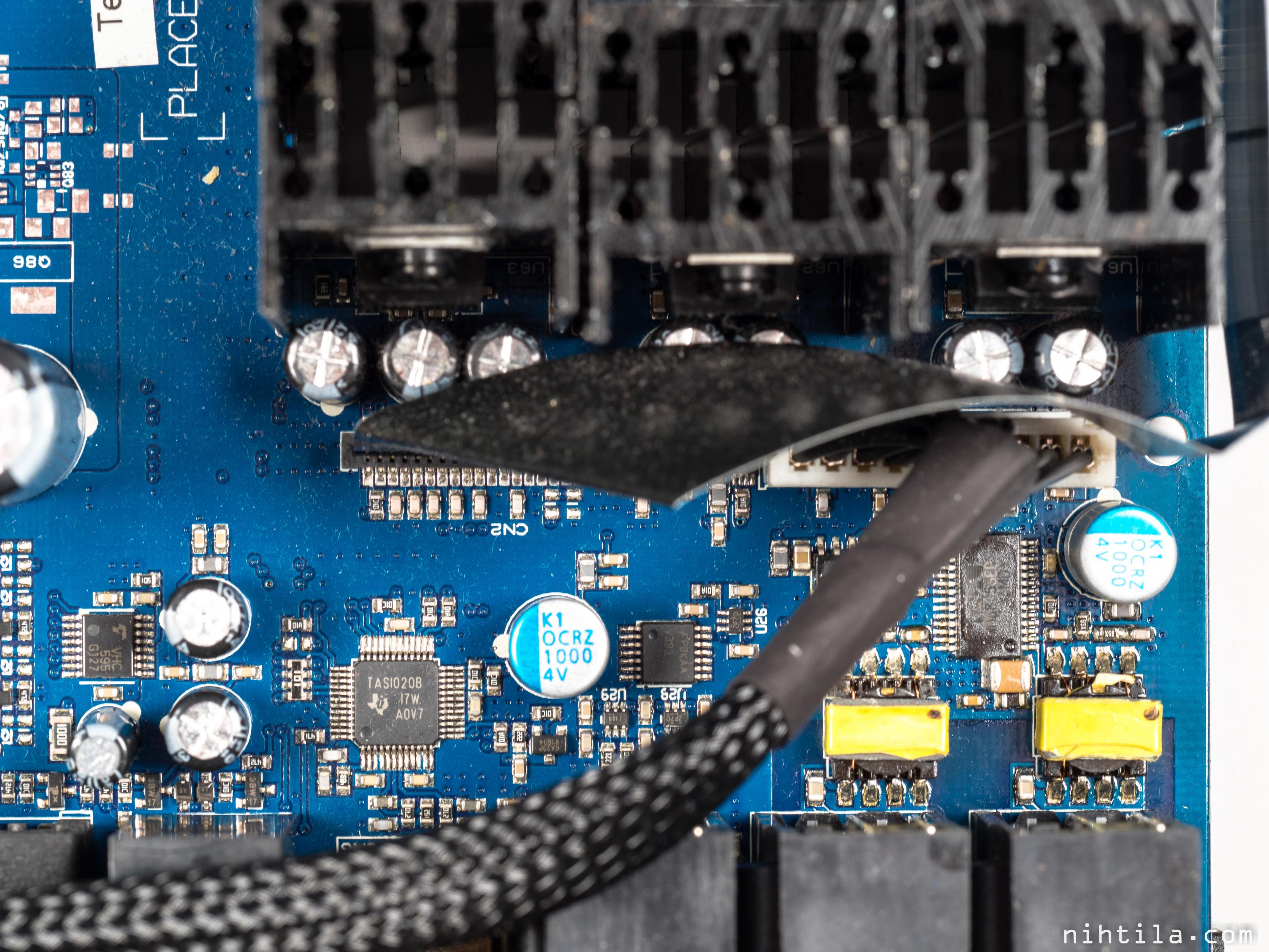

I receive this D/A converter from a friend because of very unpleasant odor development and because of increasingly poor sound quality.
After strip down the reason was clear.
Same as showed and described here:
Ask Hackaday: Experiences With Capacitor Failure | Hackaday
DFI Lanparty nF4 Ultra-D - Badcaps Forums
In the attachment are images from a device in unused condition where caps looks god.
Next time I will upload images from the here mentioned device with the same cap versions inside, that have partly exploded.

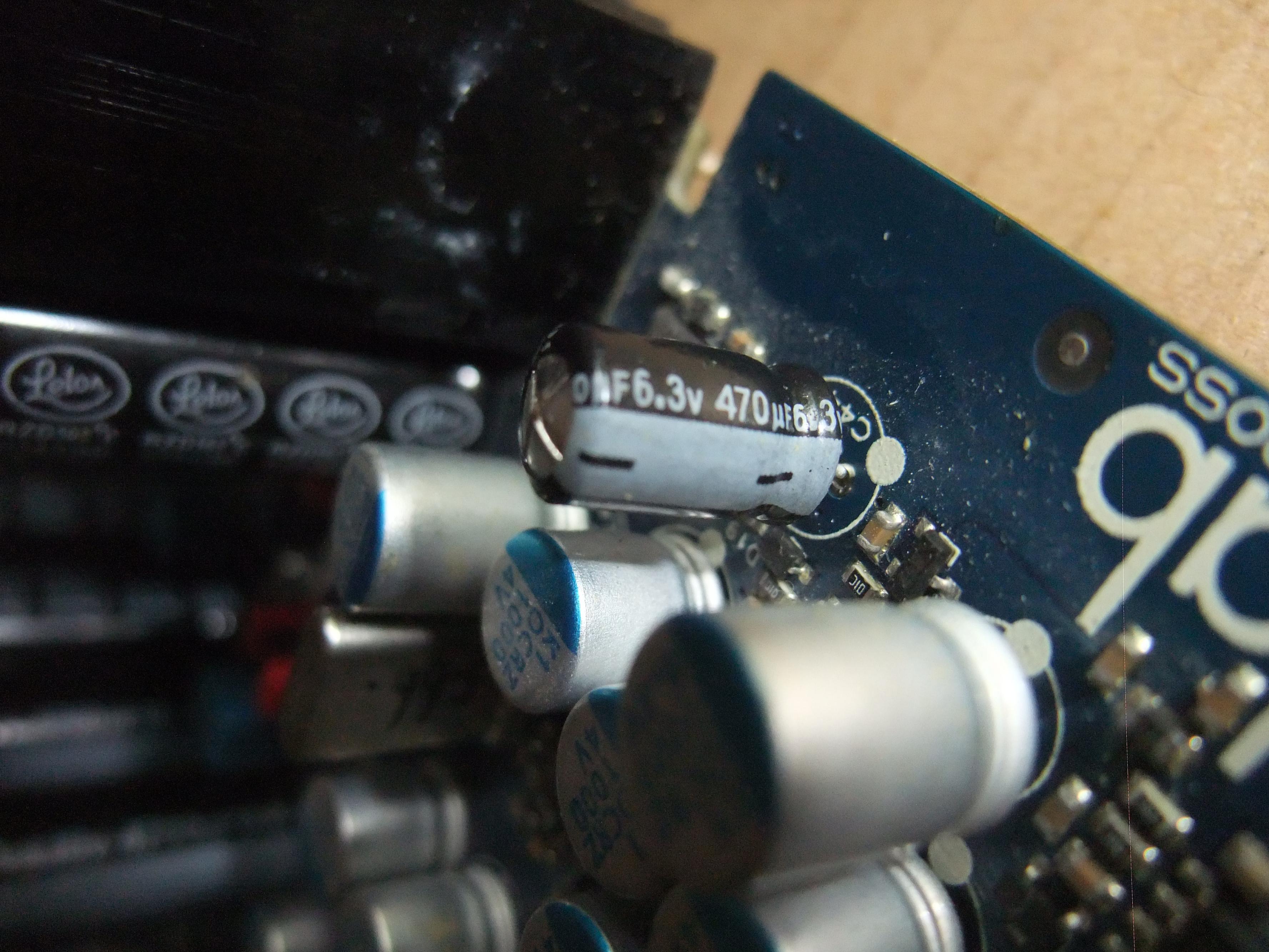

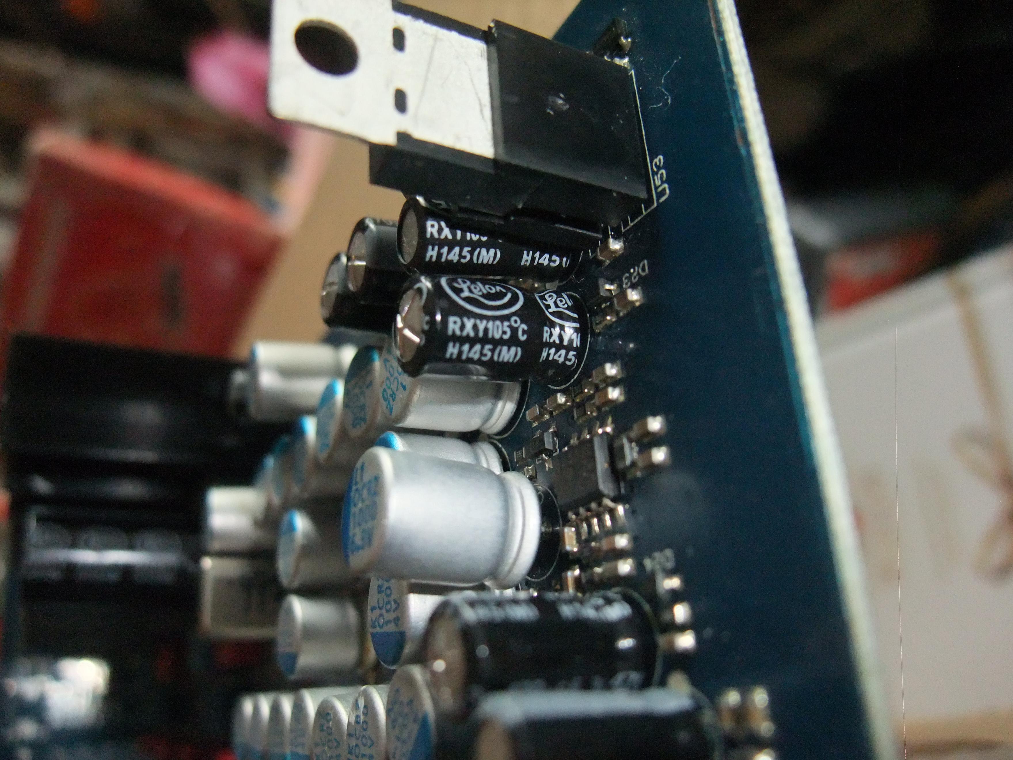

The 470uF/6,3V types are mainly affected (brand name "Lelov") - go to the image number 7.
Is this a known issue on this model or are there only any few devices with this issue ?
Thanks for an advice.

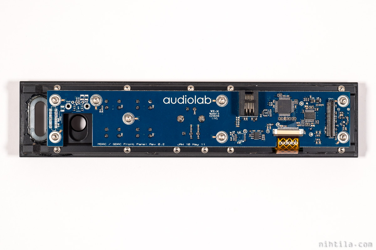

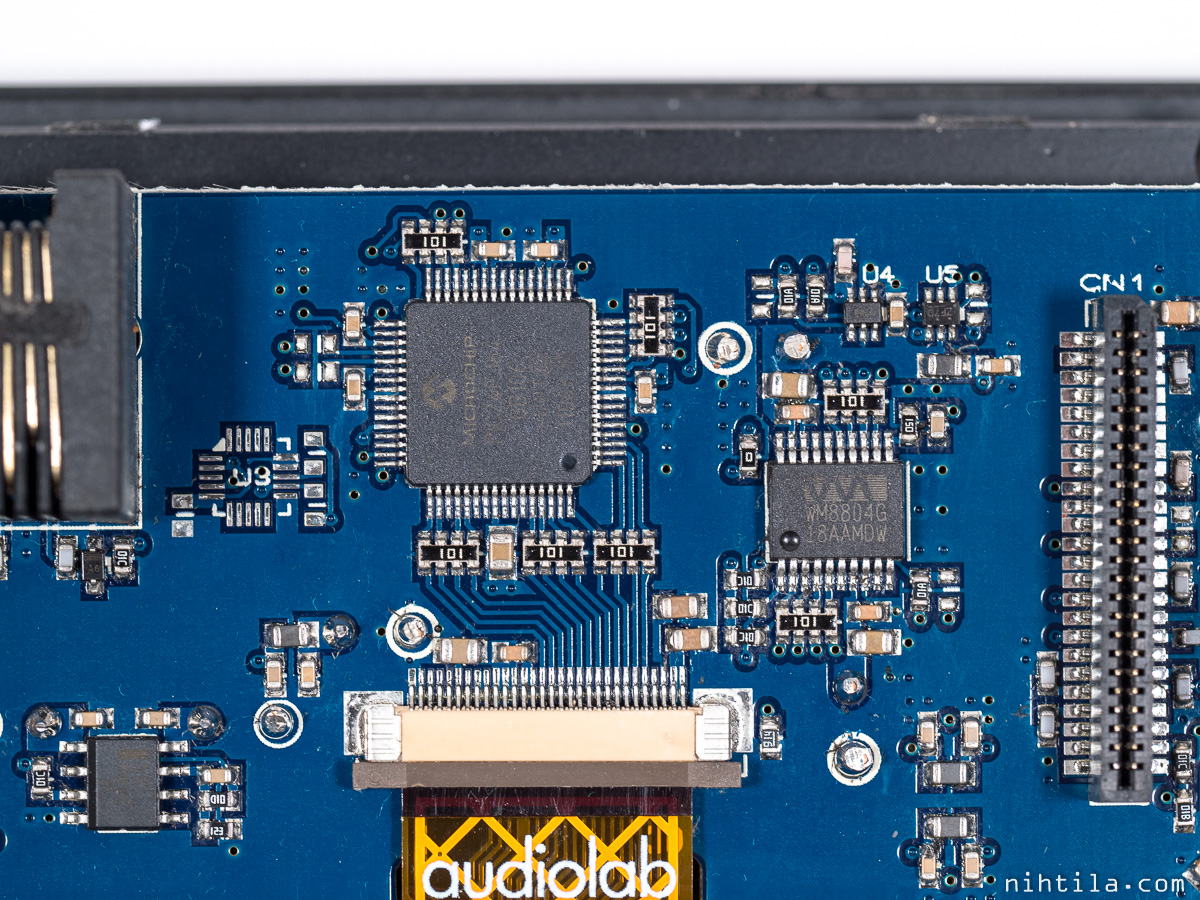

more pics from inside

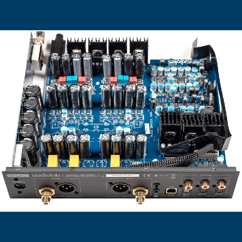

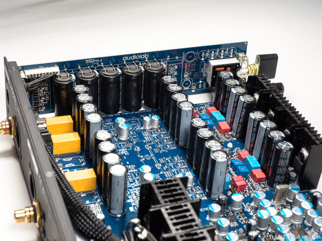

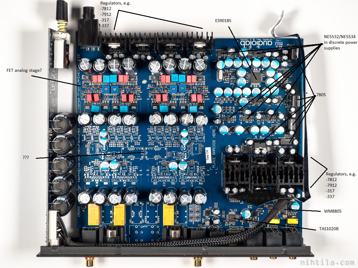

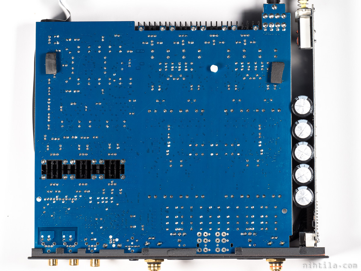

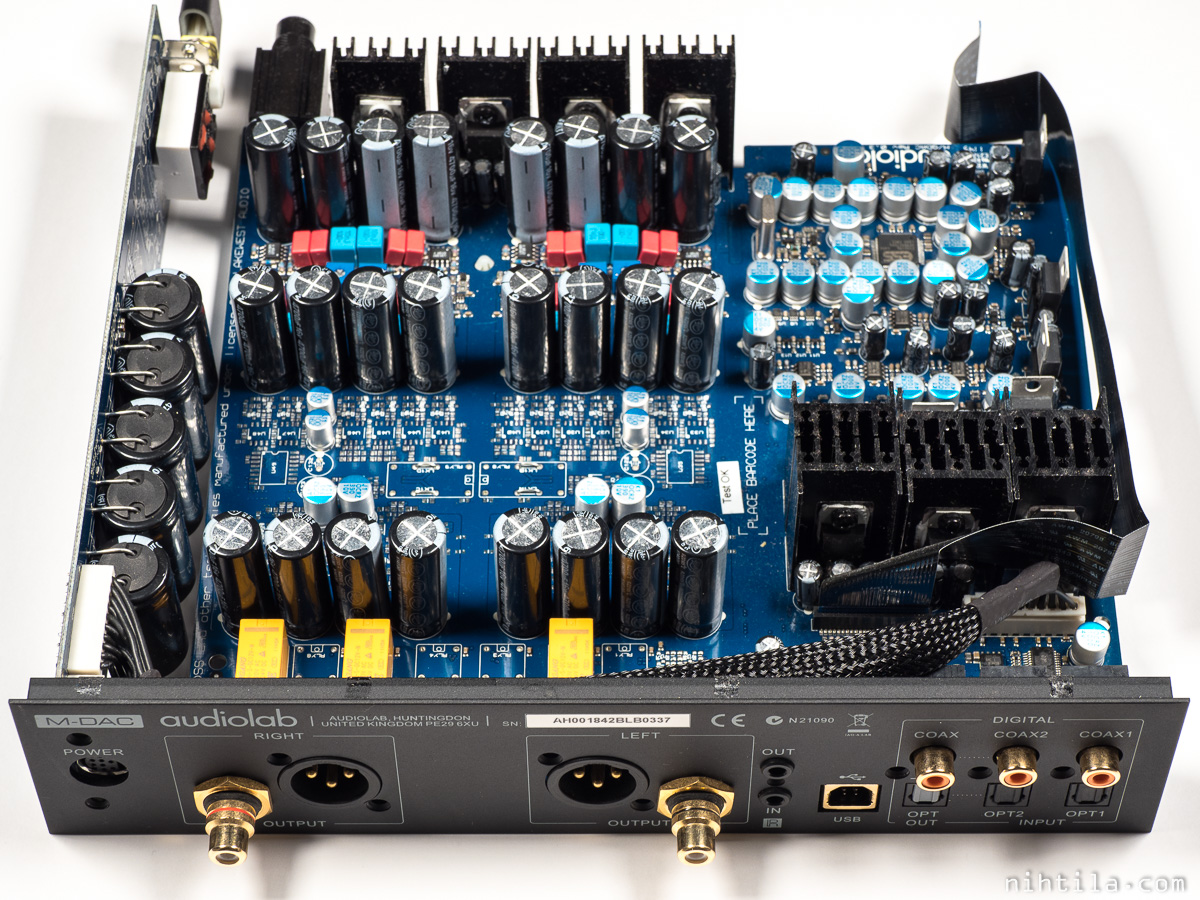

I'm very interested in buying an Audiolab M-DAC.
I can find many foto's from the oustide.
But does someone have a foto of the inside or the PCP?
Thanks very much,
Willem

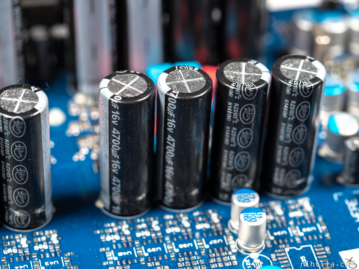

They will all have bad capacitors now - unless they have been recapped. Ironicaly its the Black 105deg Low ESR types (which are more expensive then standard Genral purpose caps) that fail.
It also seems in this case, that the lower the voltage the caps are operated at the HIGHER the faliure rate - with the Caps on the 1.2V rails that start to fail first.
It seems the capacitor manufacturer was victum to fake electroylite - (ironic as these Low ESR 105 deg parts where x4 to x5 as expensive as standard general purpose caps)..
The Capacitor issue is ONLY a problem with the standard black pastic sleeved eletrolytic capacitors, after maybe millions of capacitors used, I've never seen a bad Orgainc capacitor (the silver bare metal capacitors with light blue prining on the top of the cap case - these are VERY good caps).
Every product has its "Stock faults" - known issues with the MDAC:-
1. Capacitors leaking (Seemed to be a period of bad production batches of capacitors)
2. Bad Mute Relays (intermittetent channel loss on power cycle)
3. Crystal going high ESR resulting in no Master Clock (Comms Error message on power-up (typically when cold)).
4. Broken USB socket (Center section snapped off).
Otherwise no show stoppers as long as you can recap the board - its a 4 layer PCB with heavy Ground plane so its very hard to rework.. you need a decent desoldering station, a Micky Mouse hand operated solder sucker will not work here...

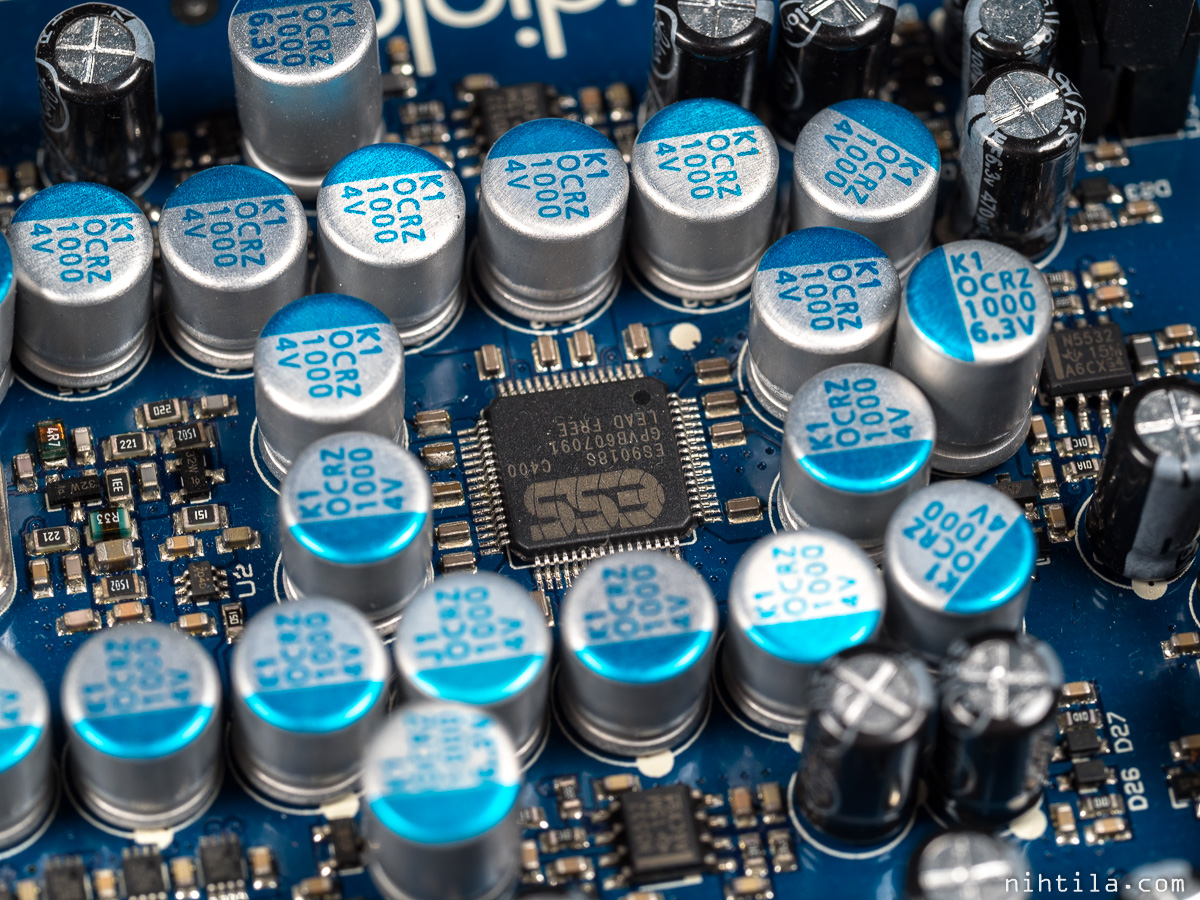

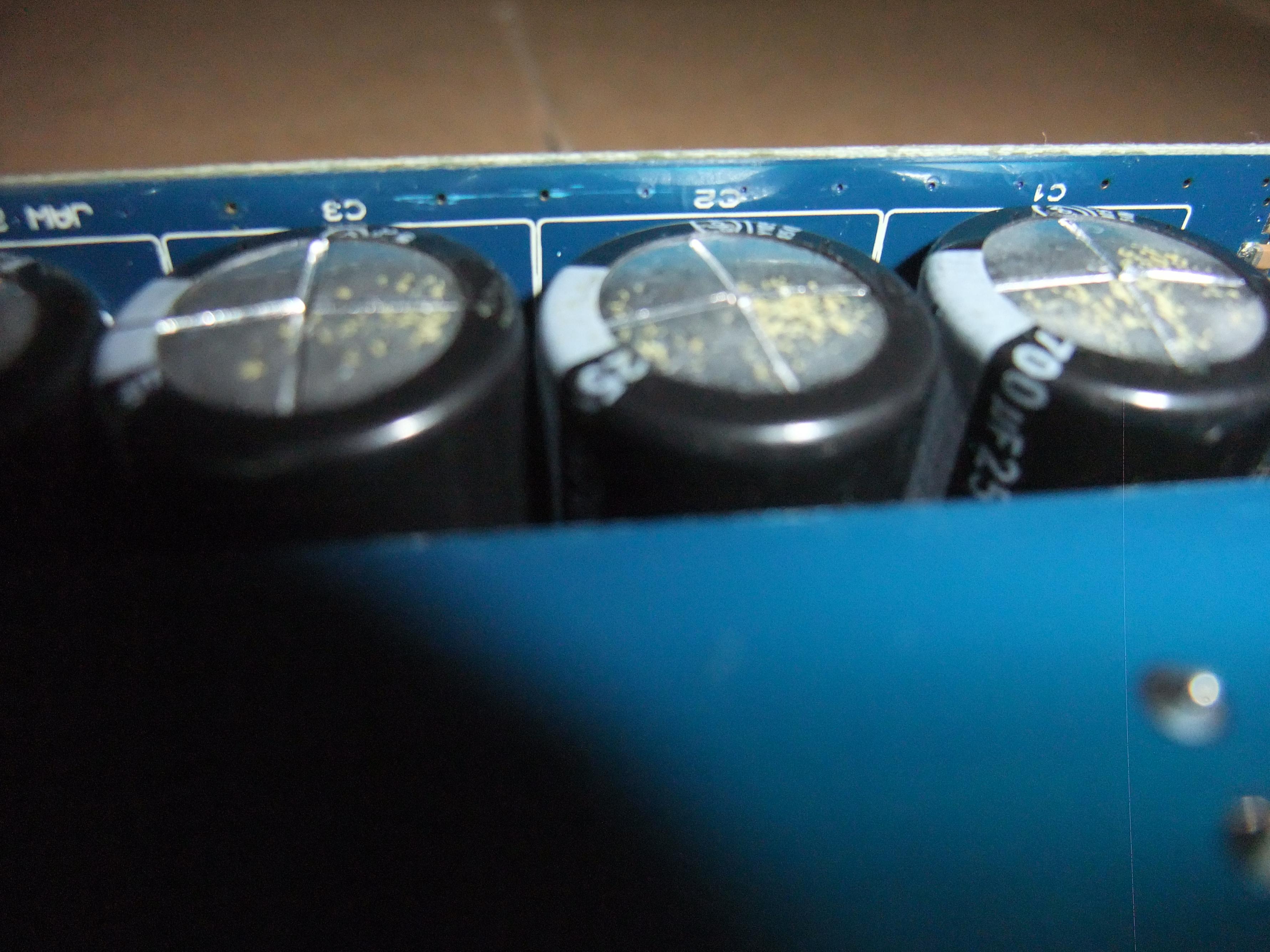

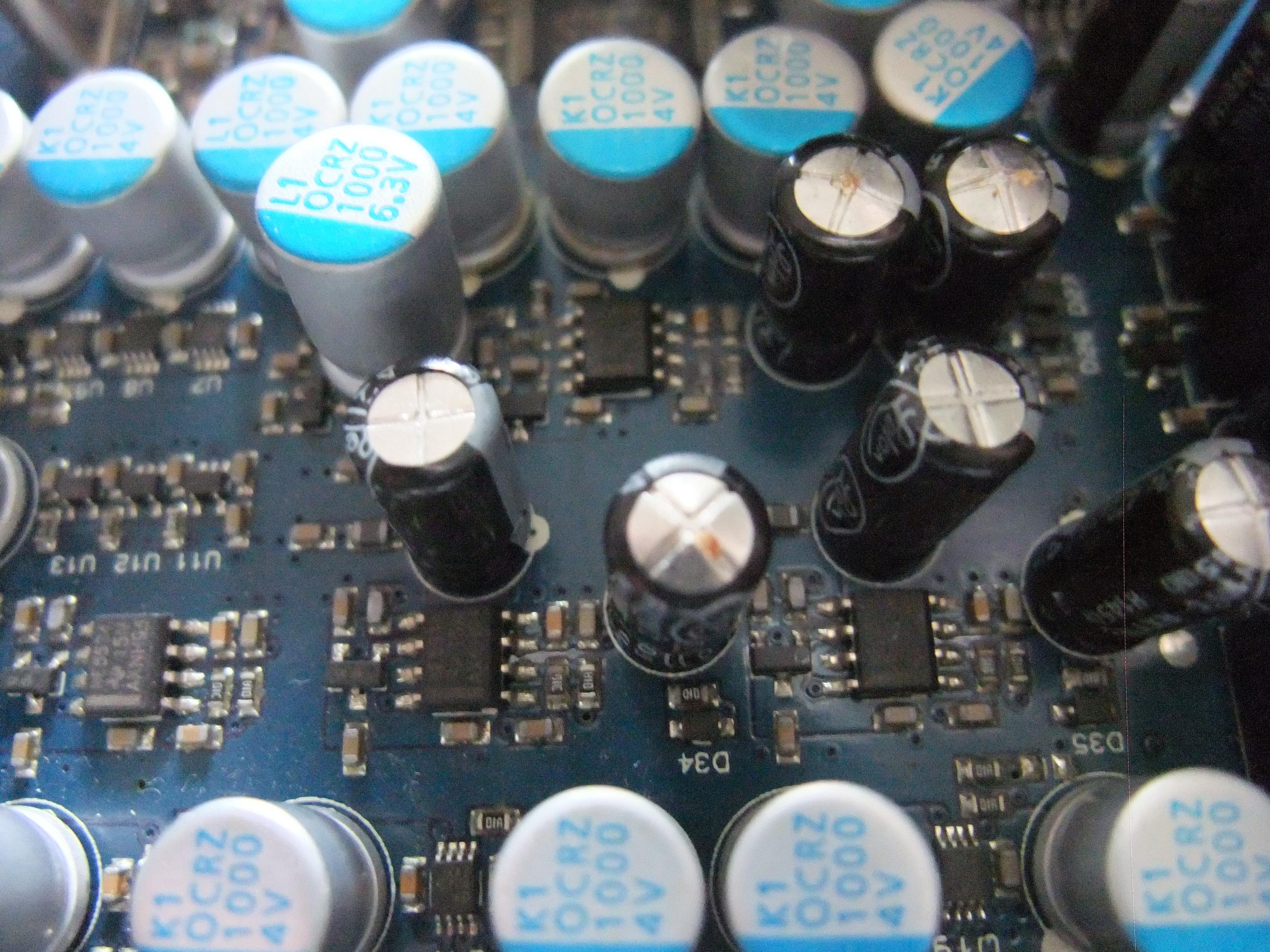

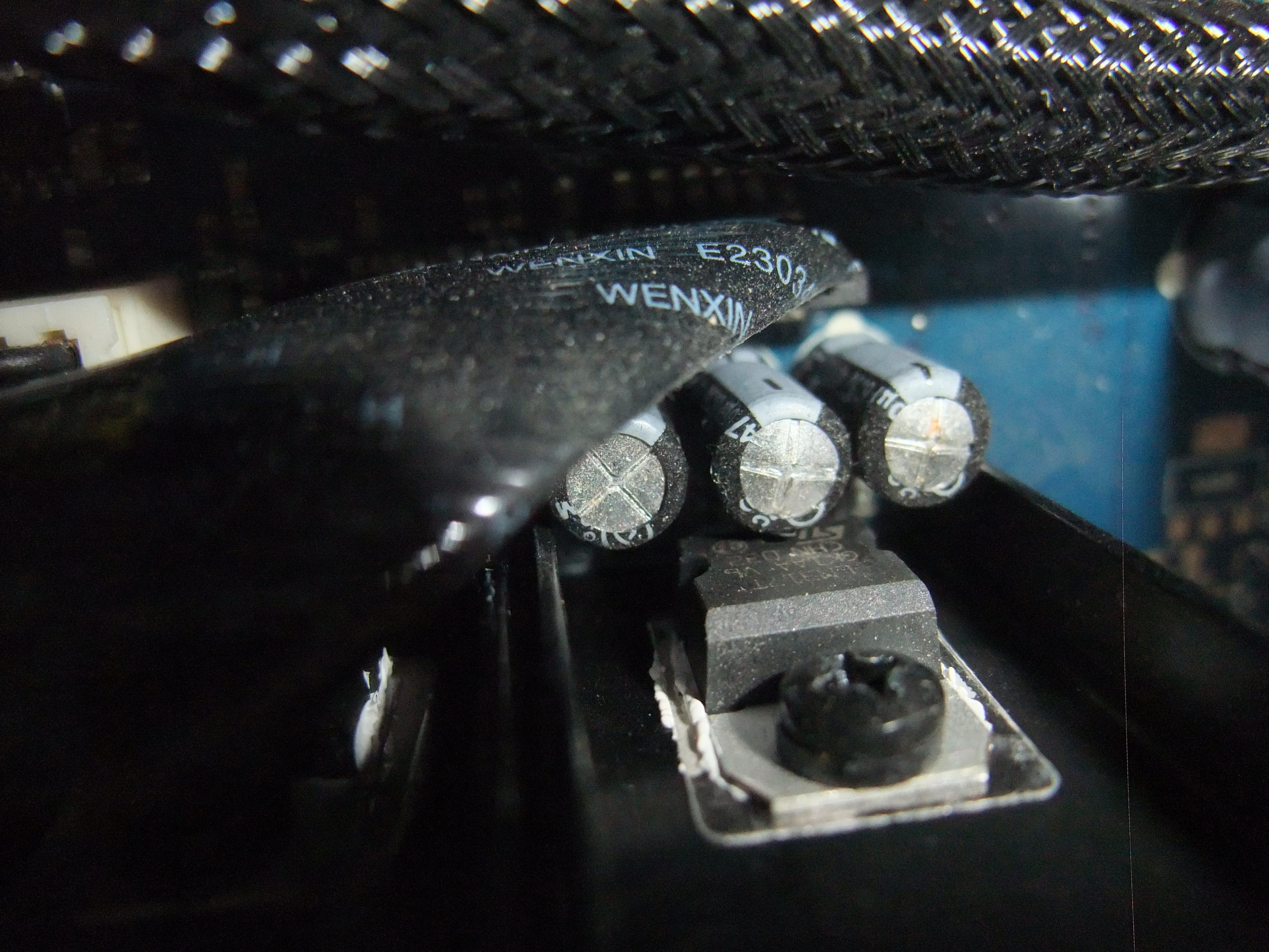

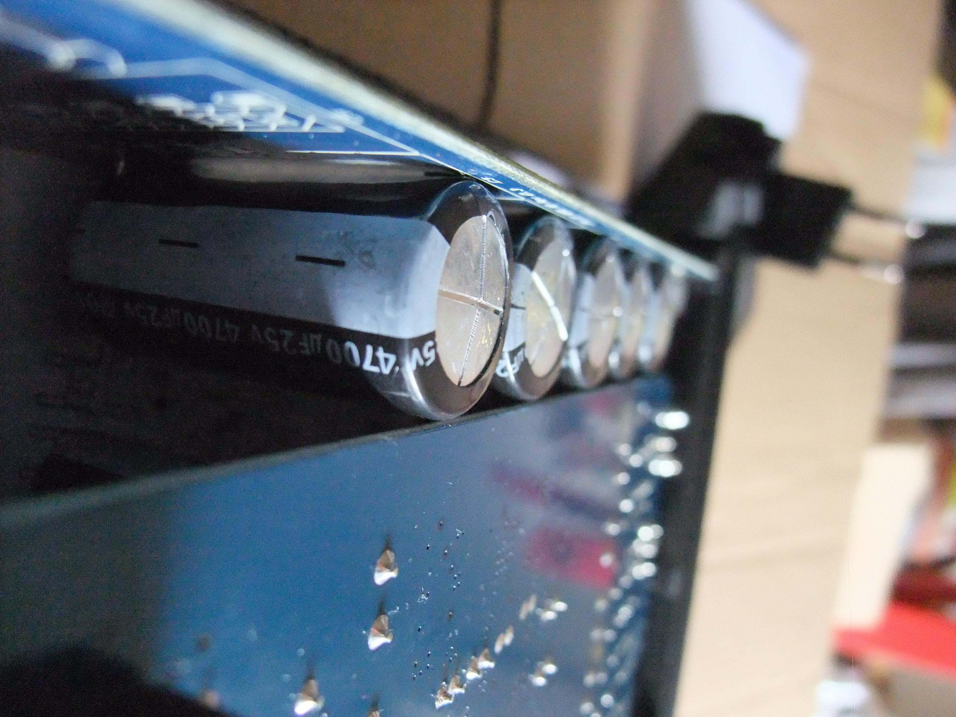

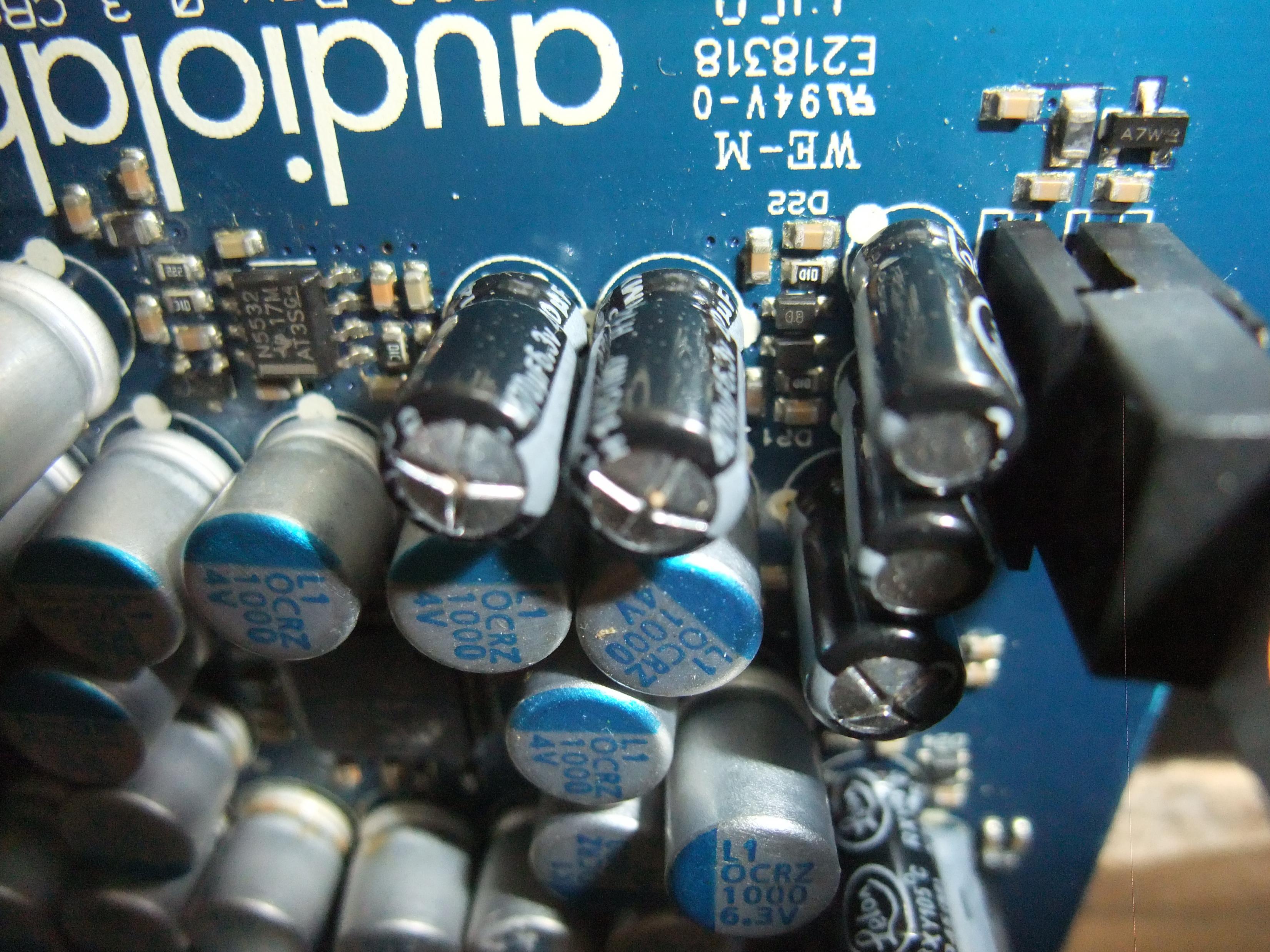

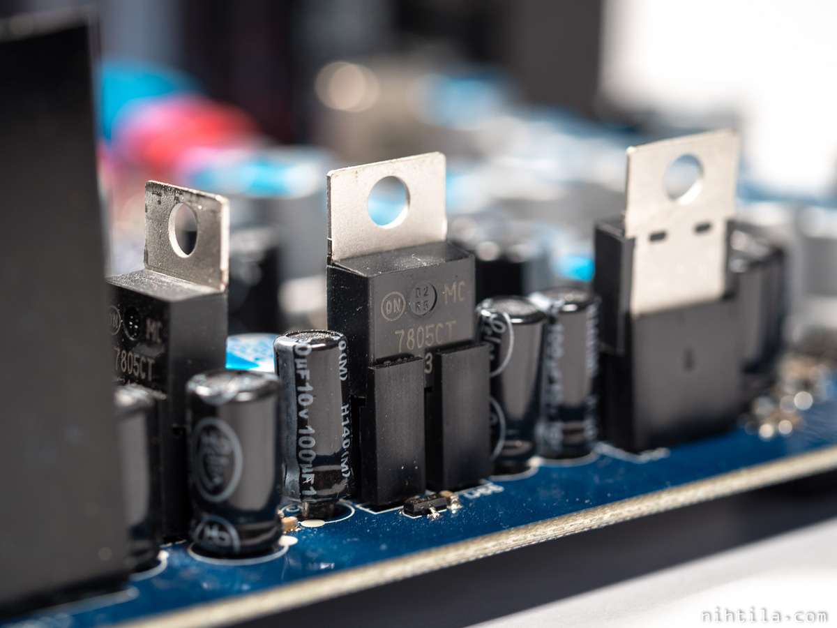

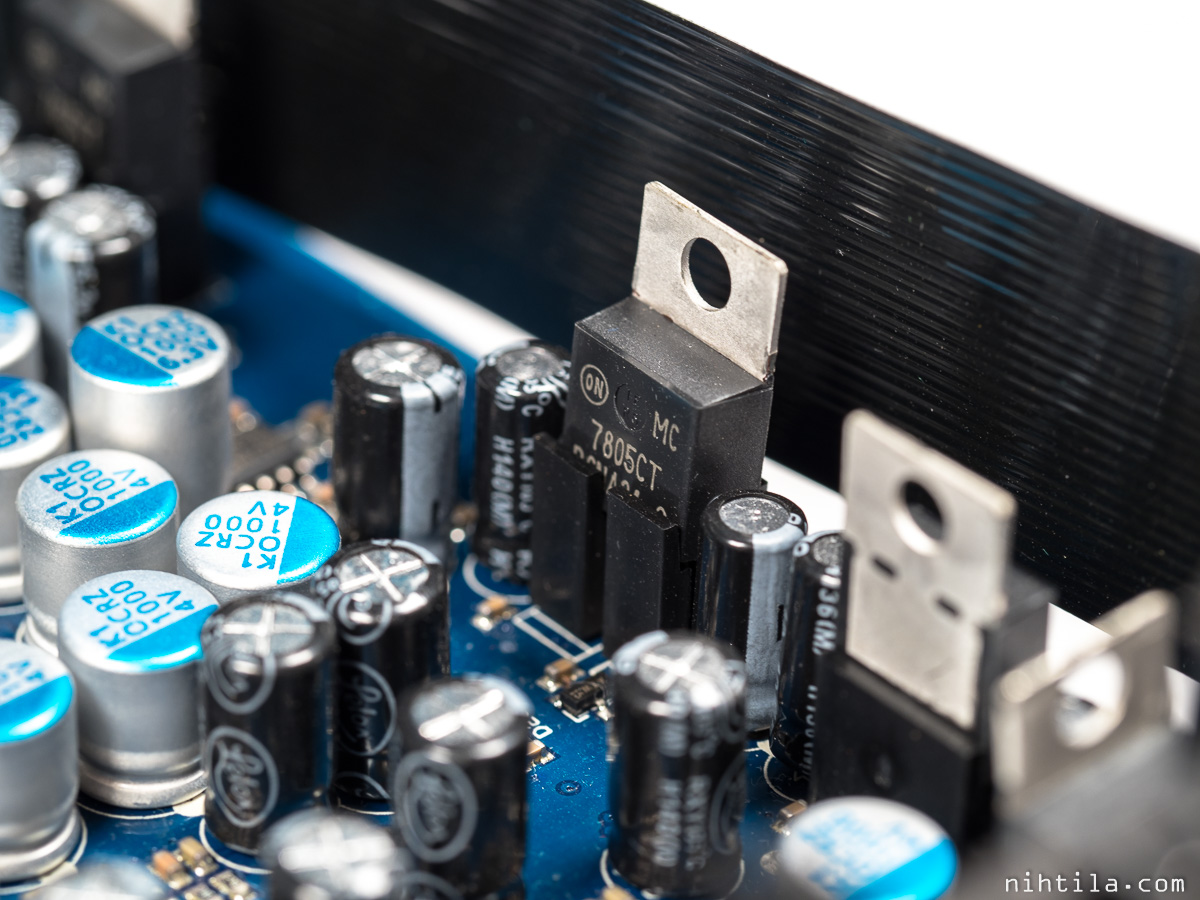

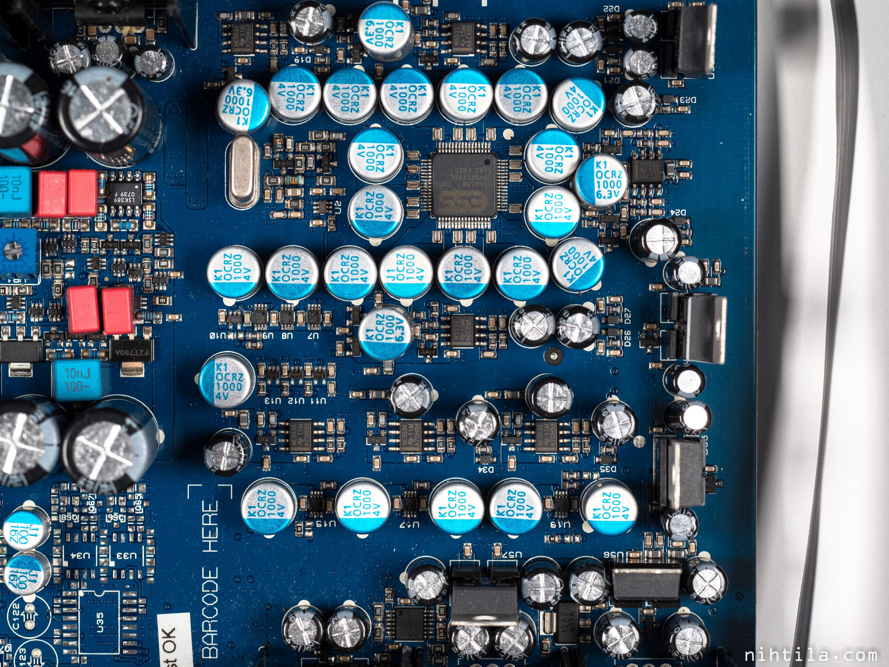

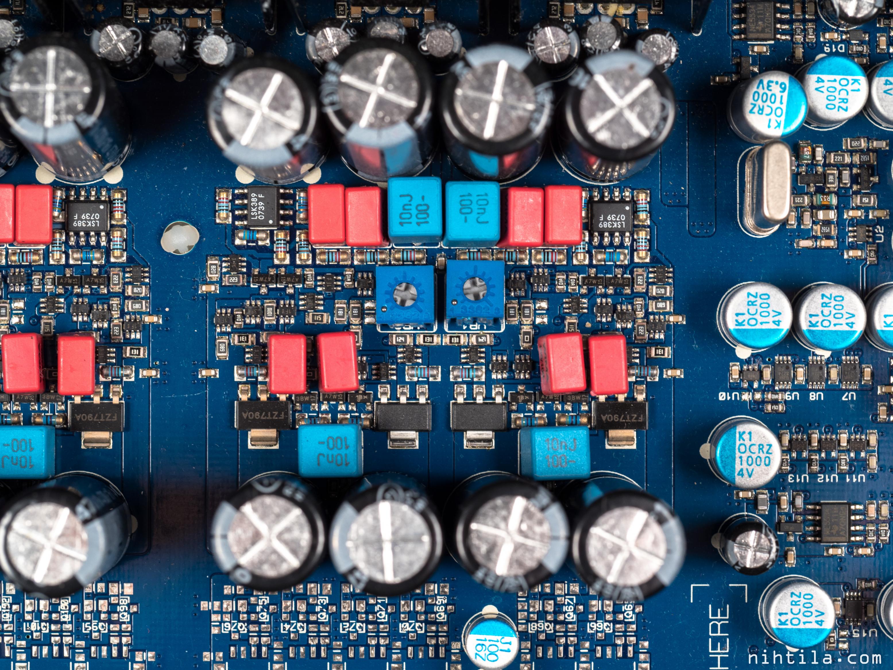

A closer look showed, that following capacitors have inflated resp. burst open (also in two other devices of this model):
1) 470µF / 6.3V (C44,46,47,50,52,54,55,60,62,71-73, 85, 86, 89 and 90 - quickly in the PDF schematic not recognizable whether filter capacitors or not)
2) 4.700µF / 25V (C1-5, clearly filter capacitors)
Why just this one and not those, which are close to the heat sinks (thermal stress) ?

Lelon (not Lelov) electrolytic capacitors are famous for unreliability.... Now not anymore but they used to fail after a short while. The brand got famous in the "bad cap" period and was produced under various names all suffering from cooking electrolyte. I am afraid they will ALL have to be replaced. Just like tantalum got a bad reputation from its past Lelon now suffers from the very bad past. Still the current ones are of normal/good quality.
Regardless of a known brand name of a device and audiophile looks (and supposedly superior quality) it is dependent on the quality of the capacitors. I have seen expensive devices all failing from using cheap bad caps and no name stuff with cheap but OK caps still working today Useless info to audiophiles as they keep buying stuff based on looks and name. It is clear to me that audiophile stuff, although being more expensive, needs replacement sooner than mass produced stuff.

Are these cap problems to limited to certain production dates (if the reason was a faulty cap production)?
What is a good replacement? E. g. Panasonic FC or FM or any other low ESR cap from a high quality manufacturer?

It is not an upgrade but sheer necessity as they will fail without question. If you wait for them to fail you might run into higher costs than replacing them before the POS device with fancy looks/name fails. On the path to failure the device will produce less optimal results and it will use more energy than necessary as the caps will start to cook internally. Compare it to how long you can drive your car with oil level below minimum.
Although Lelon is good today I got to distrust them and always replace them wherever I see them (sorry, Lelon!). Only in devices younger than 2018 I leave them where they are. No technical explanation but I have just seen too many Lelon capacitors bulging and eating away PCB tracks and simply set a safe limit. Same counts for Capxon and such crappy brands.
As usual you can not go wrong with Panasonic FC/FM with a slight preference for FC. You do need a good desoldering tool. I had a Den-on 7000 for such jobs but it is defective unfortunately. It is not easy to replace them and it is not cheap either which goes to show a simple DAC with as least electrolytic caps as possible will pose less problems and less costs to its owner from start to EOL

It may help to pre-heat the whole board to make heat-sinking effect of the ground plane reduced. Obviously, best to practice with a test board to get the technique down first.
Also, with two solder irons and two people, it may be possible in some cases to heat the board from both sides. That may require destroying an electrolytic from the top to get access to the PCB surface.
