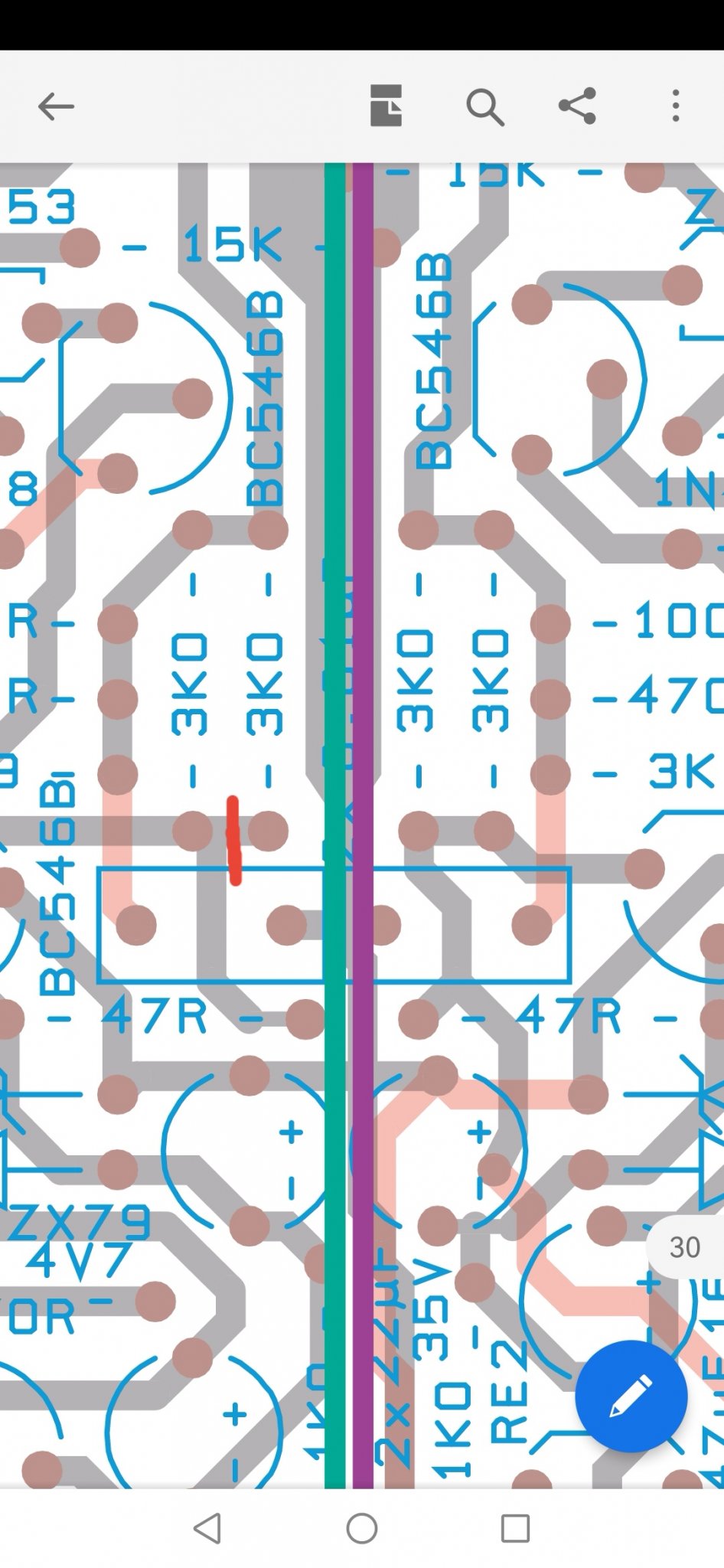

I think I have found the problem though. Like I described earlier I accidently soldered two resistors together and used a sharp knife to fix it. I see now though that it would not matter. Instead I have made a cut in the circuit. 🙄 See attached picture. I have marked with red paint where I cut.
It is easily fixed though.

Is it ok to use 50v capacitors here instead of 63v? I only have 50v at home.There are 4.7uF caps as decoupling on the supply lines for each channel (marked yellow ing the cut out of the diagram). Do you mean those?
I have ordered 2W 1K5 resistors and will raise them well. Thanks!

I have just replaced 4 of these resistors with 2w 1k5, the same that Anders used. Now that I looked at his picture he has only mounted 2 where there used to be 4 and you wrote that you replaced them with one 3w. Should I just use 2 instead of 4?
Remove each pair of 3K0 resistors and replace with 1 higher wattage 1K5. There are 4 pairs in all.

No, I use 3w, just make sure that are 1K5 ohmsThanks. Will it be too much with one 2w for each pair?
It's probably a mixture of both. From the colour of the gears I'd say they were heavily greased and Audiolab by design run hot inside the case. You're right it should be a good quality cleaner that contains a lubricant.Pretty sure that the grease on the contact switches isn't the problem and it's a contact grease intentionally applied. Rather, the issue with the switches is that they're tarnished. Cleaning the contacts obviously solves that problem but leaving them dry risks longevity.
Thanks. Yes they are 1K5 ohms. Replaced them yesterday together with some caps and now it plays perfect!🙂No, I use 3w, just make sure that are 1K5 ohms

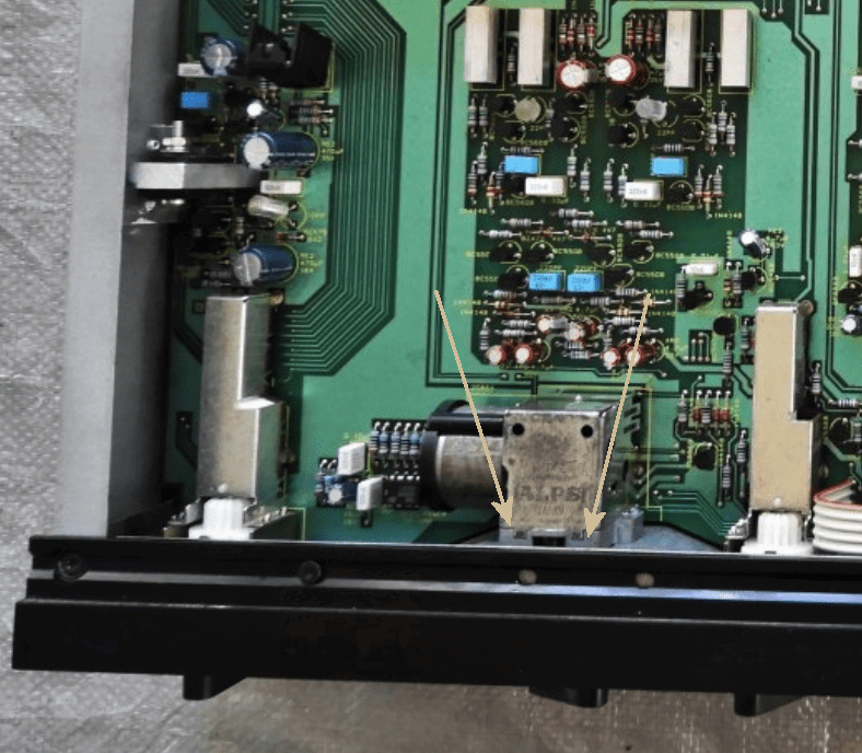

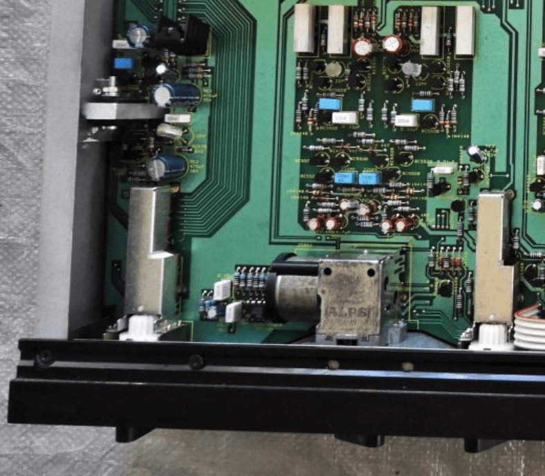

I have the same problem. Are you able to indicate on the picture whereabouts are the "small lugs" you speak of? I notice you're Kapiti Coast, small world, I run a computer support business there 🙂...I admire your patience in removing that selector switch. I recently bought an 8000S with the same selector problem and the seller was convinced that the internal gear was "slipping" and I needed to replace it with a metal one. Hence I got the amp very cheap. Proved to be the same problem you mention. grease on the selector contacts but I was in no mood to desolder that assembly from a double sided board. I discovered there are some small lugs on the front of the switch which once straightened allow the shaft to be pulled out and the gears removed. This also exposes the selector bank. You can't remove it but a good wash with contact cleaner solved the problem. In this case the plastic gears were fine and once reassembled it all worked fine.
The second switch bank you mention drives what Audiolab call a 'sense'. It does indeed mute as you change selections. I came to the conclusion it is a feature not a fault. As the remote control commands the motor to drive the input switch to your desired selection it may pass other live sources and without the mute would briefly feed those to the speaker. Yes, all rotary selectors do the same but manually we turn them quickly.
Agree it is a great amp.
I no longer have the amp but looking at your picture I recall removing the front panel, then a secondary panel supporting the front controls, easing the lugs around that front casting on the switch which then comes out with the shaft and gears. I'll try and PM you as you are so close, cheers.Are you able to indicate on the picture whereabouts are the "small lugs"
