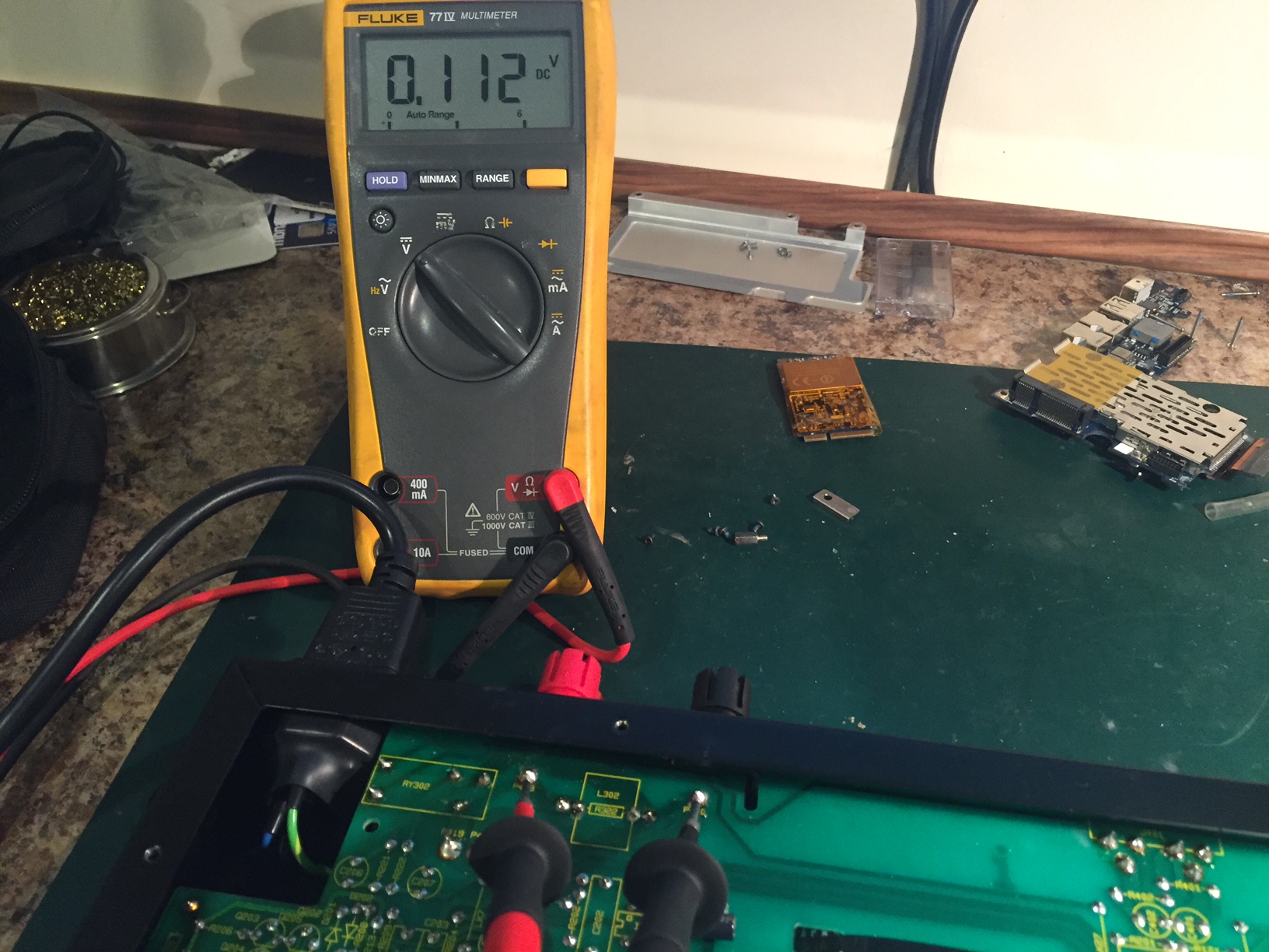

Something is broken.
A DC servo controlled output offset should be around 0.001Vdc (1 milli-volt DC), not in the tens of milli-volts and certainly not in the hundreds of milli-volts.

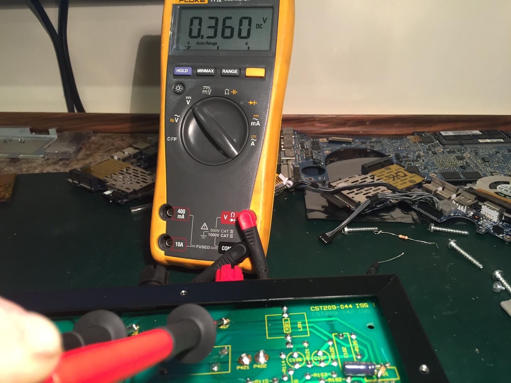

Where did you get the pictures in posts 1 & 2.

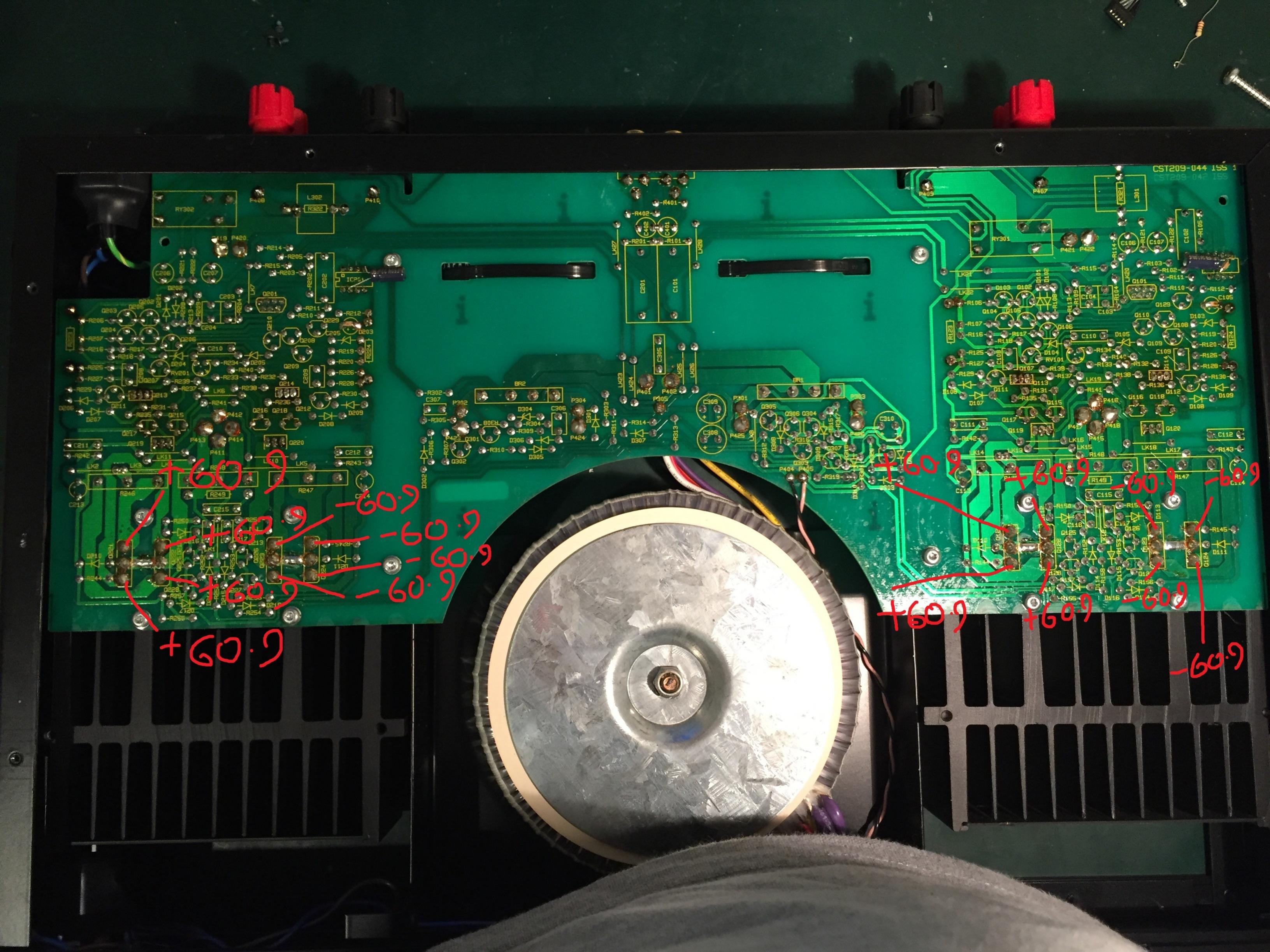

The red witing seems to show 60.9V dc? at various points around the PCB.
These are probably the supply rail voltages.

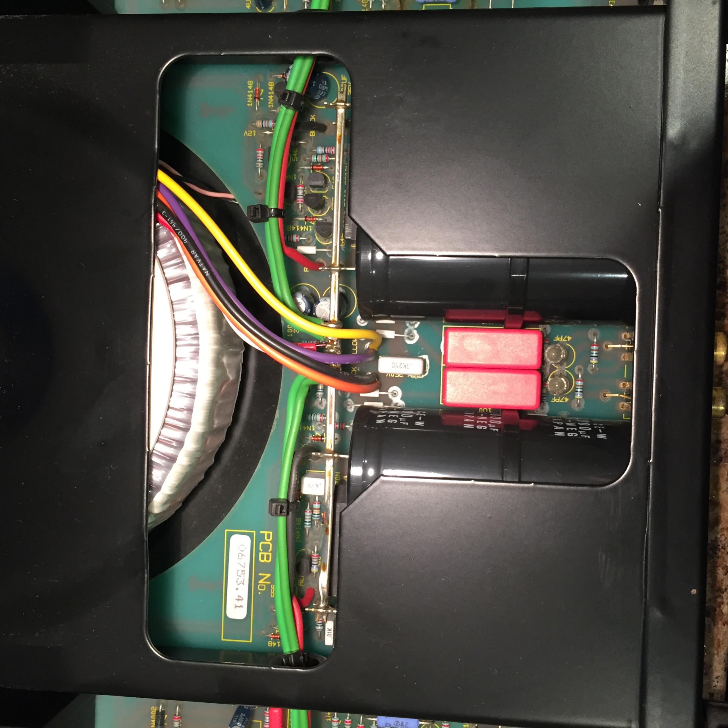

Check the voltages on the mains smoothing capacitor terminals. These should be similar.
Hi , yes the voltages in post 2 are the main output transistors , I will check on the capacitor terminals after work .
That's a bit high for a 40Vac transformer.
Maybe they specified a special of around 230:42-0-42Vac and when running from a 245Vac UK supply gives that higher voltage.
Some manufacturers specify a maximum output power when the mains is at the nominal voltage. Others do that for the minimum mains supply voltage, with the result that at nominal supply voltages the amplifier gives a lot more power.

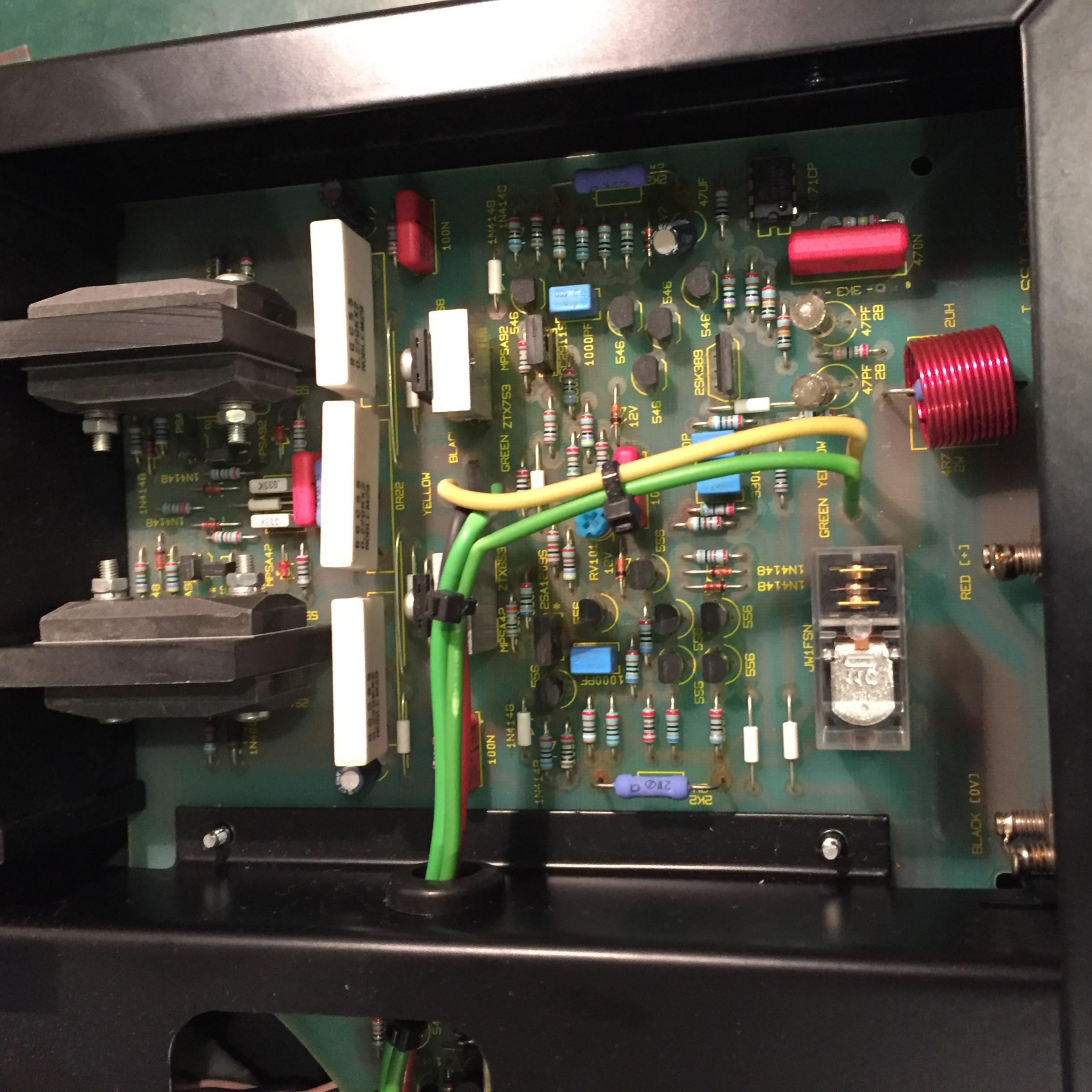

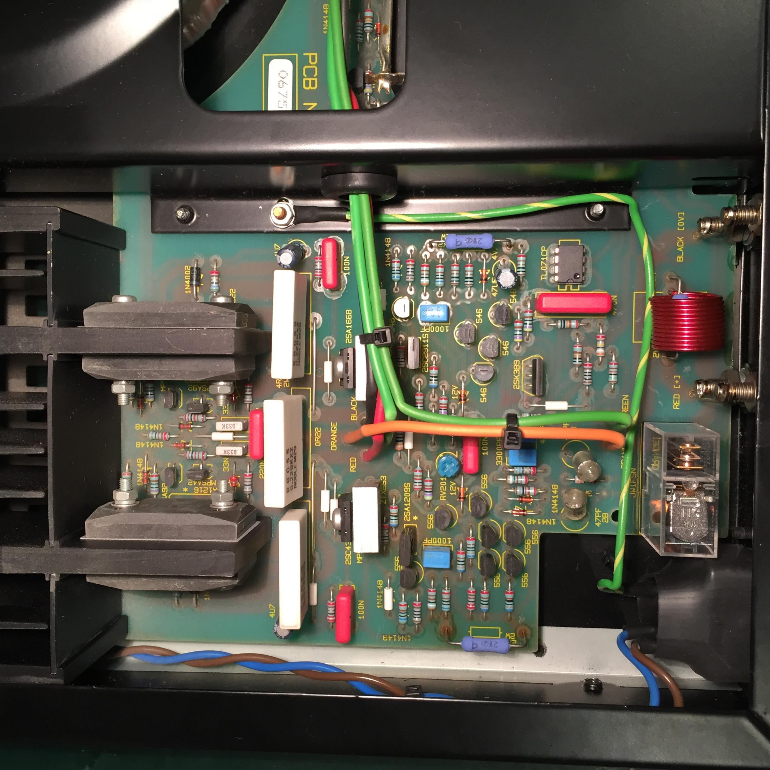

Most of the problems with this amp is the fact that the two transistors responsible for the voltage amplification is NOT fittet with a heatsink. As a result they run VERY HOT, and eventually break down. I can`t see the number, but one is a 2SA1209 and the other 2SC2911. Replace with 2SA1358/2SC3421, AND add heatsink.
regards
Roar
Good call , i took out the 2SC2911 transistors and sure enough their shorted between emitter and base
Hi Again , thought i would give an update on this ,. I replaced all 4 transistors with the ones RM suggested (thanks again for your help RM) and added diy heatsinks, the temperature these transistors are running at is around 51 degrees C , not sure what the acceptable temps are ?
