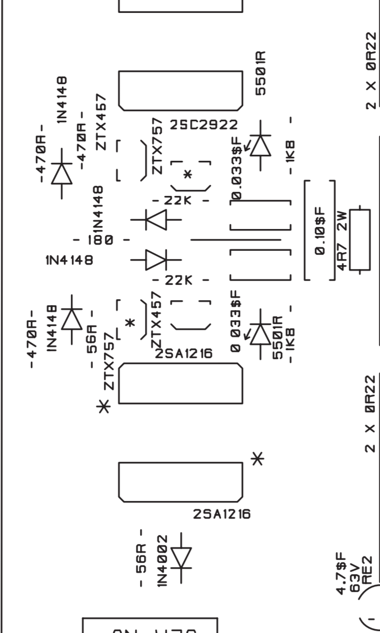

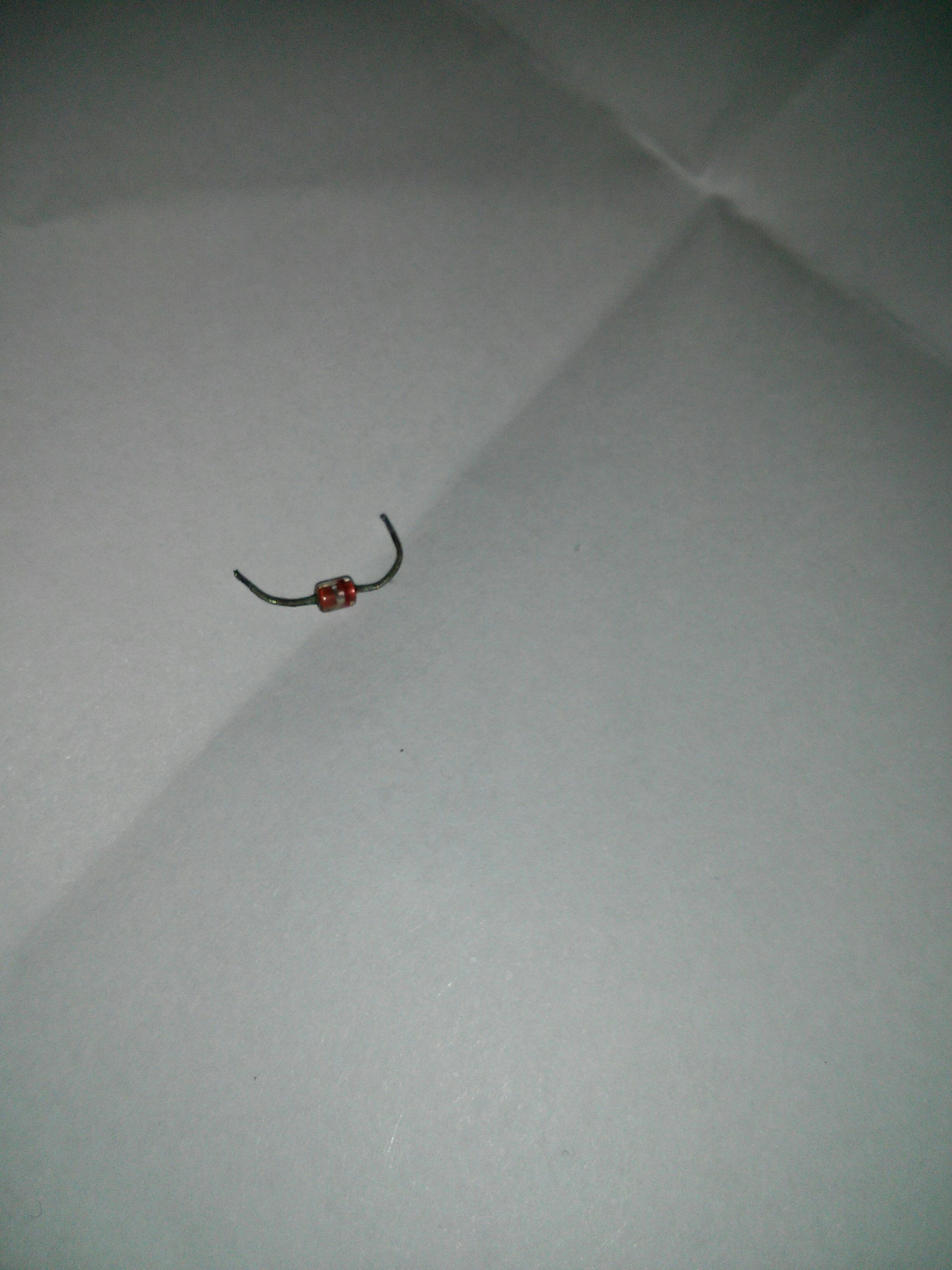

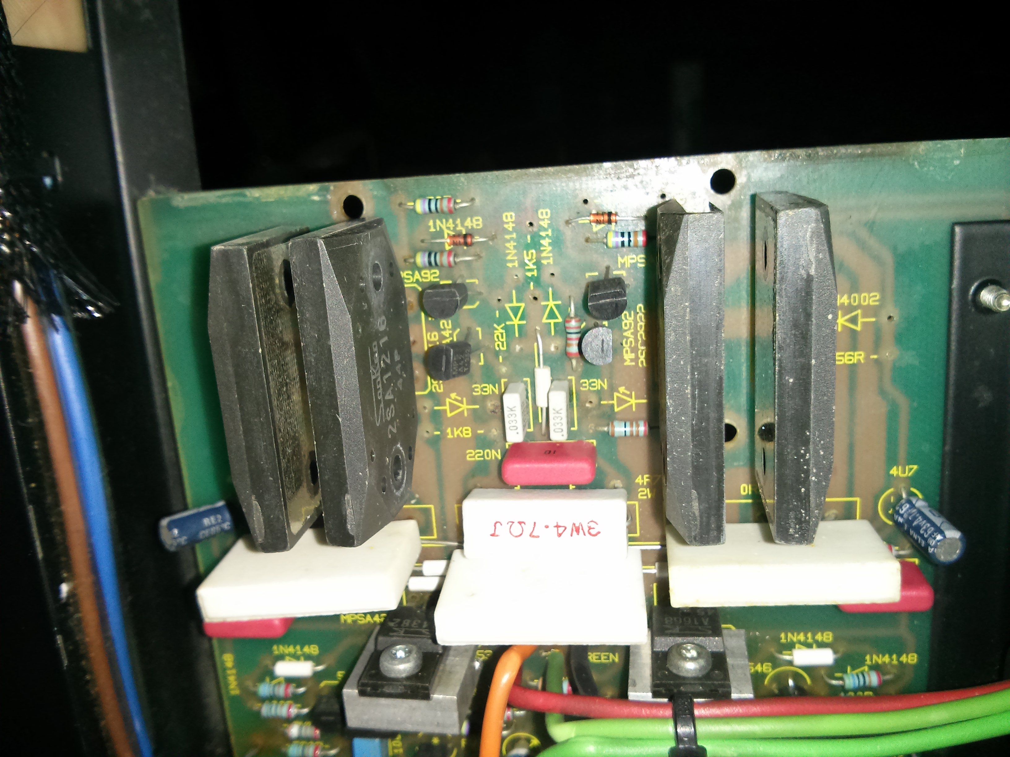

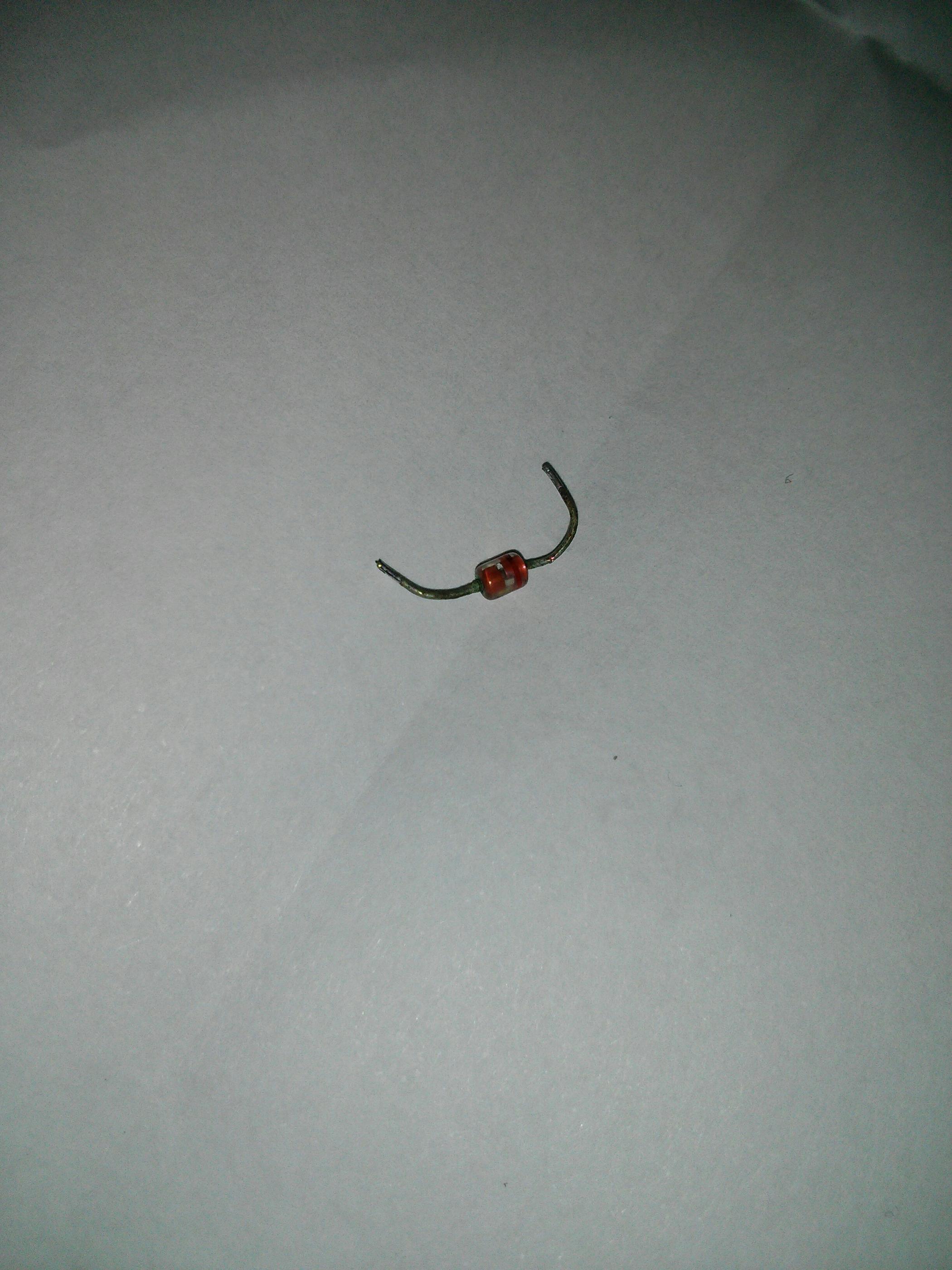

As the title suggests a coffee spill led to parts failure that I now wish to fix. Thinking of using Takman resistors for replacing the dodgy side and doing likewise on the other to match up both. The main problem is identification of a supposed diode, see pics attached, one of these diodes had blown and some resistors nearby had gave up the ghost. This is my first post and hope to be here for a long time picking up the soldering iron and modding and repairing hifi for the foreseeable future.
If anyone has schematics or a service manual for my particular amp it would be much appreciated. Cheers

Thanks Andrew, I'm replacing all the resistors diodes and giving it a good clean round the affected area. What do you suggest after testing with a mains bulb tester Andrew?I found the diode I was looking for online. Cheers Jw for the schematics, but it's the later version of 8000p similar to the 8200p.
If the bulb lights up you will find that your supply rails will be just a few volts instead of ~40Vdc.
After each power OFF you need to discharge the PSU using a resistor. 2k2 will get hot. Don't burn your fingers.
The first step is to disconnect the amplifiers from the PSU. Now the bulb should be out. Check the PSU voltages. A resistor soldered to two crocodile clips with short insulated flexible leads is a handy tool.
Then connect ONLY the good channel amplifier and see if the bulb stays out.
If it does, can you safely measure voltages to see how they compare to the service sheet? Be careful a slipped probe can blow up the good channel.
Disconnect the good channel and connect the damaged channel.
The bulb will probably come on.
The next step is possibly to remove all the output transistors in the damaged channel. This will disconnect the feedback signal so output voltage will probably go to rail. If the bulb is still lit then you probably need to remove the driver transistors as well.
It's usually better to measure parts before just replacing blindly. It's quite easy to create new problems doing this. Definitely check transistors for shorts before applying power. You can still burn up parts with a bulb limiter in circuit. This can be done in circuit usually. Normally you can check voltage drop collector to base and emitter to base in diode check mode. Compare between the good and the bad channels.

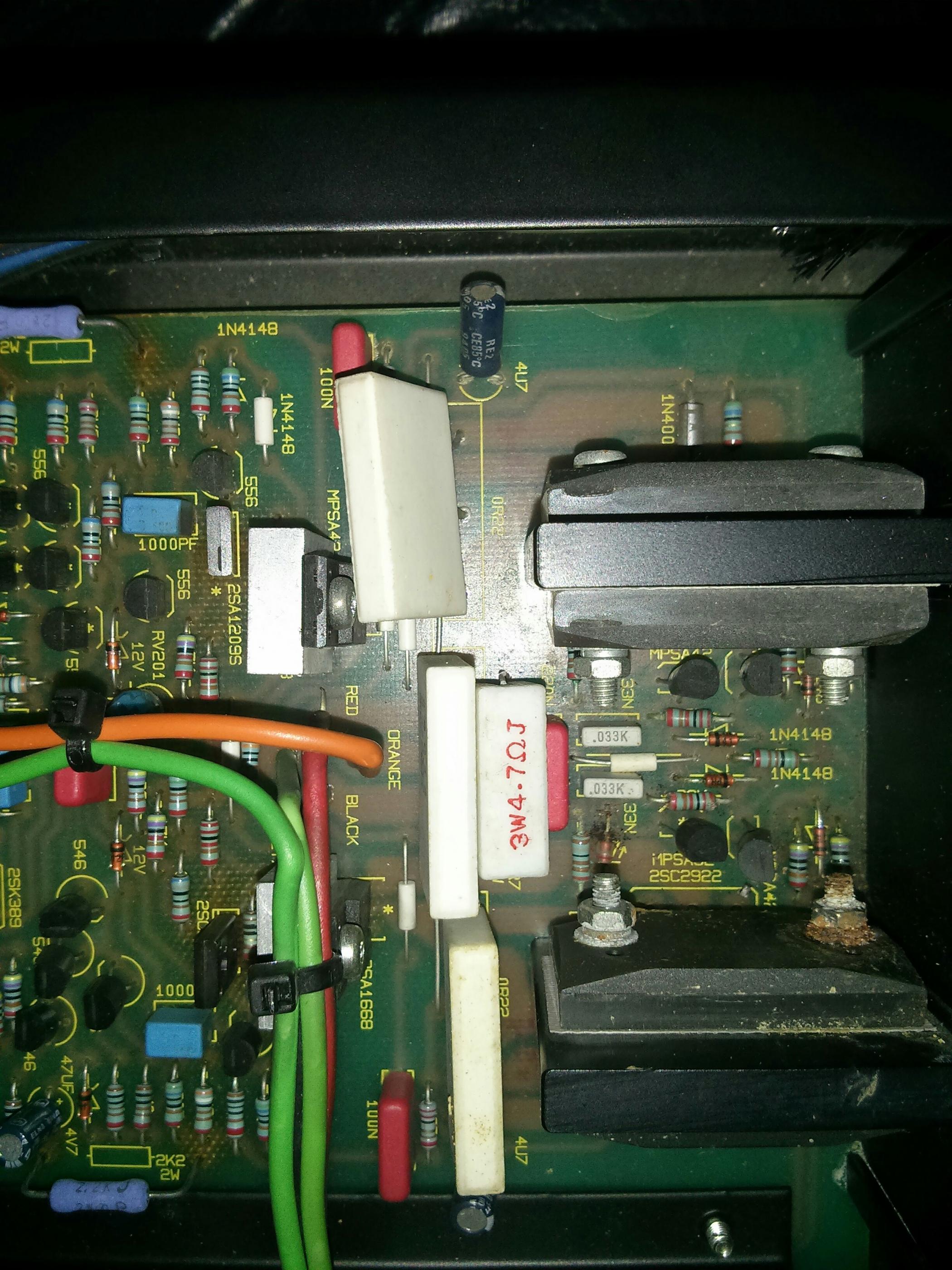

Thanks for all the info and I used contact cleaner and a small artist brush to get some of the residue off the board. It looks a bit better now, but don't like the idea of using soapy water though. Struggling to find this part or an equivalent DIODE BZV86-2V0 this is the part that spewed on the board after a dislike of coffee. Check the cleaned and partially stripped board.

Yes, repairs to liquid damaged equipment often fail in the future unless its all been cleaned properly.
Hot water and detergent is fine. Just pat it dry with paper towel to wick up most of the remaining water and then place on a warm to hot radiator for several hours.

Just finished replacing all the resistors from my previous pics including the 2V0 diode that was hard to find. Turned the amp on without speakers or source connected, turned off with no issues. Now have the amp sourced up, speakers connected, sounds great, but one heatsink is heating up more than the other (used thermal tape on the transistors to heatsink) it's not normal for one channel to heat up more than the other, but what may be causing this? Any help would be appreciated. Cheers

Diode is BZV86-2V0 it's what is stated in the service manual for that slot.
Thanks 🙂
I actually meant what does it do in the actual circuit. If its used as a voltage reference for setting a current (for example) then the replacement will almost certainly be a little different in terms of exact voltage. That could explain the bias being different, hence the heat.
I have an 8000 circuit but couldn't just see such a device on that one. Maybe the P version is different.
I'm just looking at the circuit in post #2 and I can't just spot it on there either.
What you need to do is measure the bias current of both channels for starters. That's easy to do by measuring the volt drop across either pair of the 0.22 ohm emitter resistors and calculating the current using ohms law.
