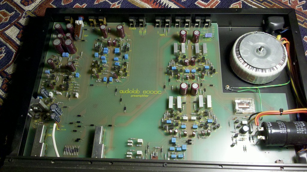

Hi all need help I have one audiolab peramp model 8000c, but the transformer is burnt. Any model can replacement for this model 9142-P1S2?
may I know what is the spec of this model (Example: What is the voltage) Thank .

Several well known websites only show the audio circuit .
Hi-Fi Engine does not have that version (C) but it has the 8000A( use version 207 ) schematic .
2 windings on the secondary = black/red and orange/yellow .
Output from the bridge rectifier is +44 Volts (raw ) and -44 Volts (raw ) smoothing capacitor rated 50 V (working limit ) .
