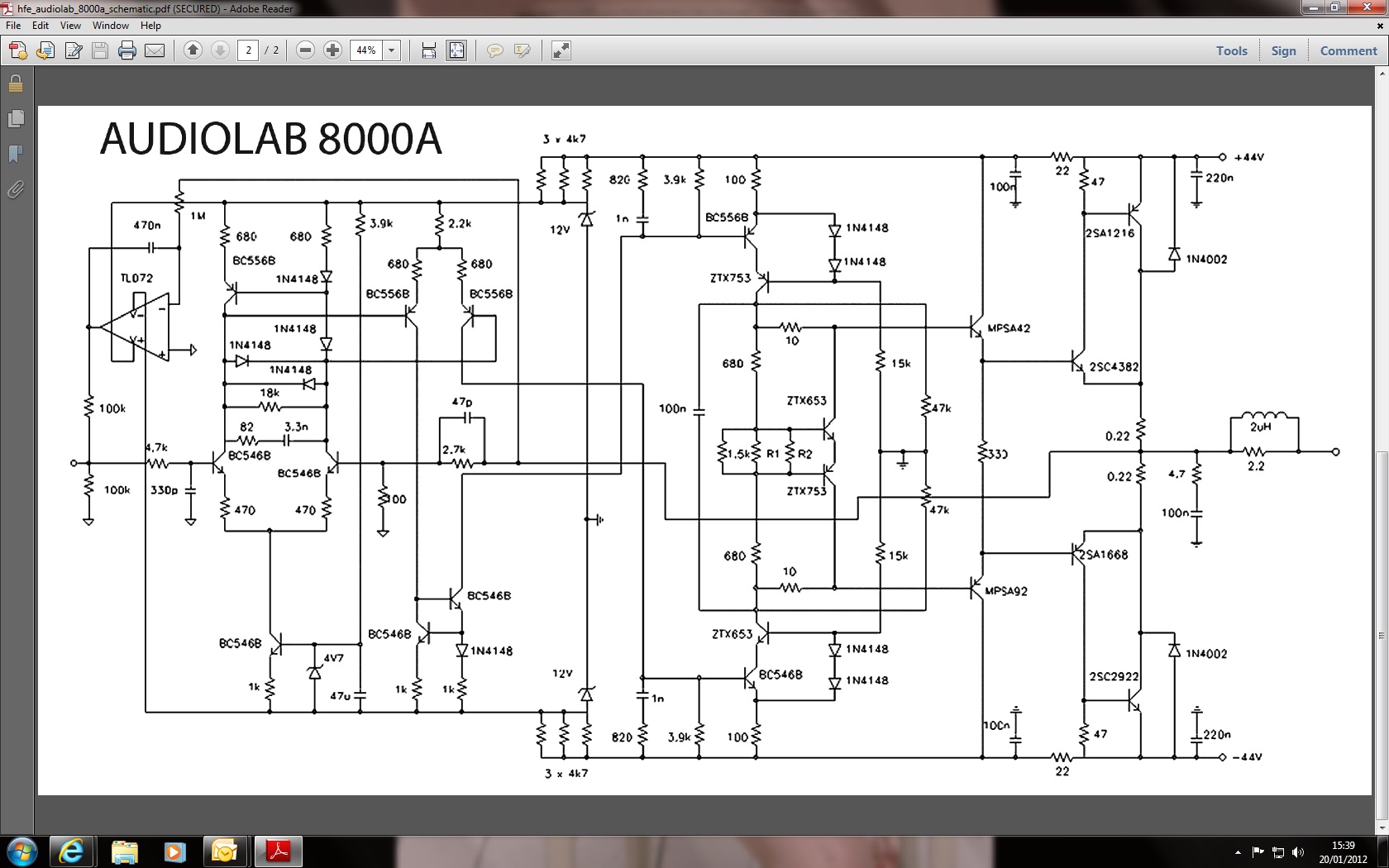

There are 4 signal diodes in the input LTP.
The top one mimics a current mirror.
The middle group of 3 look like some anti-saturation circuit.
Could some explain how this works?
