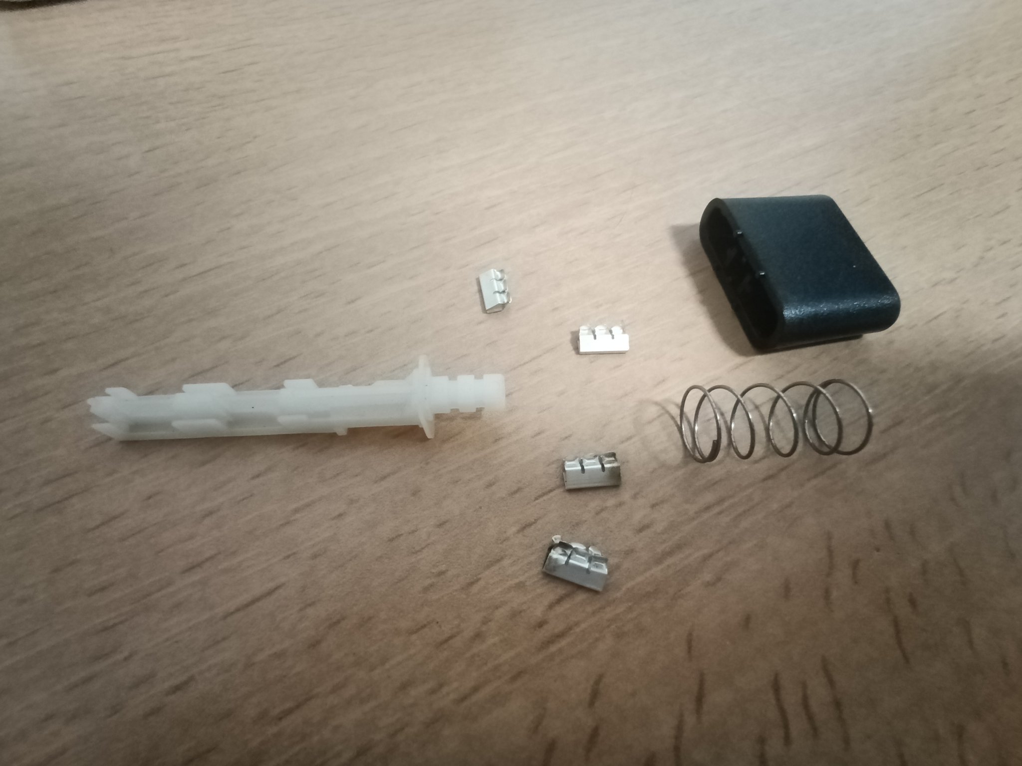

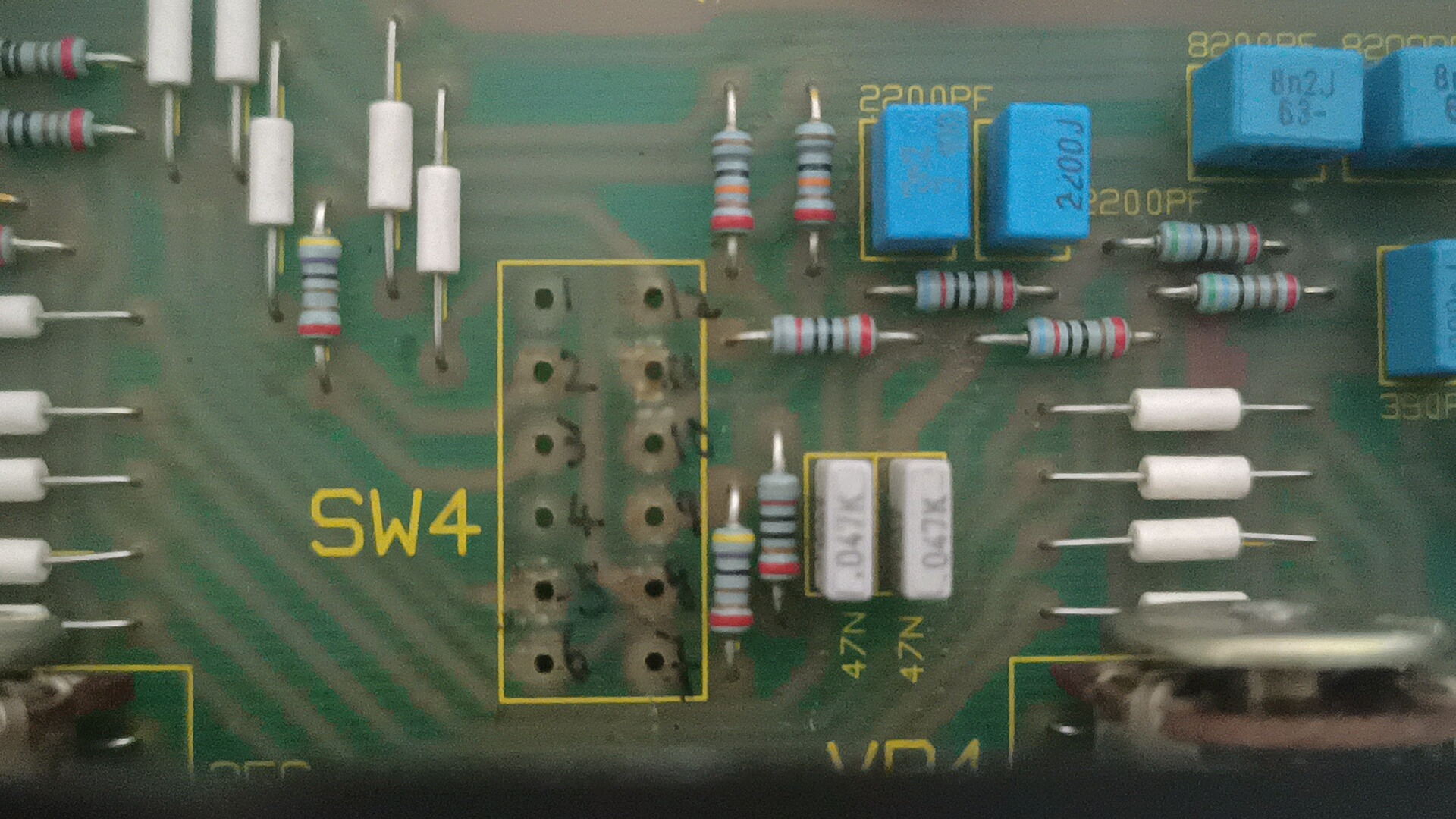

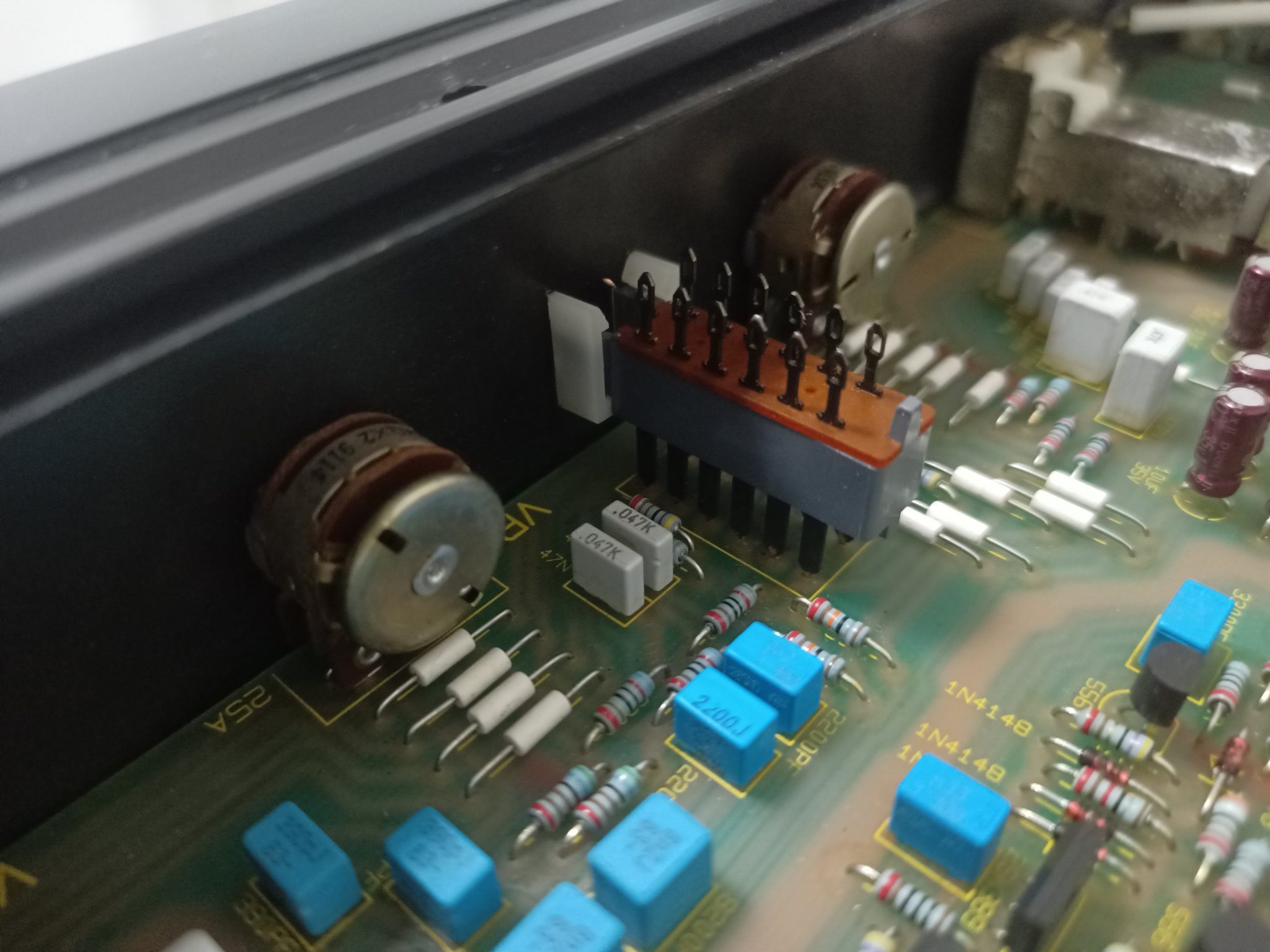

Hi brother , my audiolab 8000A ,the tone button broken down, I removed it out , now need you help to advice me , which point to point need to solder together ,so can have the sound back again.. thanks for the helps ,I do mark a number on the picture , which one should I solder together? Thanks.. urgent.
