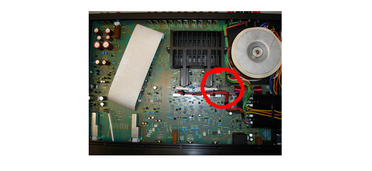

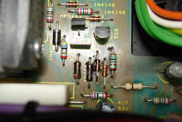

hello all..
i am new here also and new to hifi / electronics in general..
my father has passed me down his audiolab 8000a amp, which altho is abit of a relic still sounds really nice.. the problem i have is that the amp seems to fail to deliver signal to both speakers.. one sounds nice the other sound distorted, if i swap the leads over the problem swaps speaker (exactly the same happened when we tried the amp with my dads new system) suggesting a problem with the amp..
upon opening her up, there was noticeable damage to some of the resistors.. the problem i have is that i cannot tell the value of the resistors as they are completely black and charred!! i have looked at a schematic and altho im a draughtsman my knowledge of electronics is basic to say the least.. if i were to photograph the problem resistors and their location on the pcb would someone be able to assist me in identifying them?!?
im young and dont really have the budget for a repair let alone a new amp, i was really hoping i may just be able to replace the resistors at a fraction of the cost!! PLEASE HELP!!!

You could probably identify them yourself by looking at the good channel. But post a pic, can't help without that.
I would also add NOT to connect speakers to this until it is repaired. You've been lucky up to now... a DC offset fault would destroy the speakers. Replacing just the resistors and hoping its fixed could produce a DC offset with disastrous results.
attempted posting images...
1st image is from a distance, 2nd a close up of the burnt out resistors..
thanks for the response, like i said im no electrical engineer, im a noob with an interest!!!
im all ears to sound advise guys!!
Looks like the 470R resistors in the protection circuit. There is going to be more wrong than just these burnt resistors, you will need to find what caused this. A good place to start will be to check the output devices are OK.
