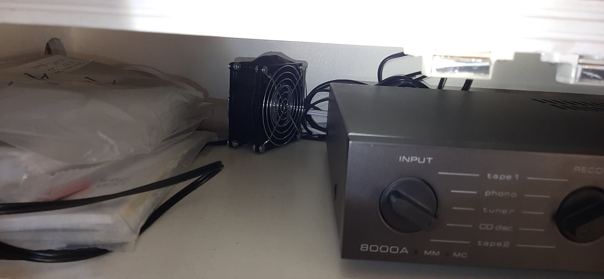

I ajusted recently the bias current on my Audiolab 8000A (version of 1988, issue 3).
May be my particular personal experience doing this can be useful to someone. The amplifier runned very hot. So I'm sharing this experience, so the following is my particular personal experience.
This version has not presets and bias current is set by the pair of SOT resistors R809//R811 on L channel, and R810//R812 on R channel. In each channel, the pairs of resistors are connected in paralel (//). In my amplifier, R809 was 6k8 and R811 was 43k. Also, R810 was 6k8 and R812 was 43k.
Please note the pairs above are also in parallel with another resistor (placed on component side) of 1k5 , labelled as R807 on L channel and R 808 on channel R. Then (considering the 1k5 resistor) changes on the 43k resistor have very very small effect in the bias current. After some tests, performed as stated in the service manual, I set at 7k5 for R809 (L) and 7k15 for R810 (R), both preferred values, the first on E24 series and the second on E48 series). The 43k resistors were not changed.
SOT resistors were selected with the amplifier cover and baseplate mounted, but without screws fitted (as specified on the service manual). There is (by construction) a "heat chamber" inside the amplifier and this temperature rise inside controls the bias current in such a way it reduces slowly the bias, taking about 30 minutes to stabilize. As a curious test, taking the cover off the "heat chamber" lowers its temperature and the bias increases (ambient temperature was 26 ⁰C). So, a bias setting with cover off is not valid. And gives place to a too low bias when the amplifier is working with its cover in place.

Thanks, Cumbb,
As I specified above, I already adjusted the bias for about 20 mV across emitter resistors (=45 mA). Sounds OK. The amplifier runned too hot, now is more on the warm side.
On the power supply capacitors there is now 44,7 V/45,5 V, when mains is at 234 V. Offset is at 2,7 mV at one channel and 8,1 mV on the other, and this seems OK.
Tone controls are IMHO a usefull feature. I rarelly us them, but not all recordings are tonally equilibrated, and in some recordings they are usefull. And in 'purist mode' we can cancel them with a direct flat button. But many manufacturers, including Audiolab in recent years are prone the 'convince us' that such controls are evil... Even when we do not use them, it is good to know they are there, just on cause...
I also put a 92 mm fan, just in cause (attached image), to use if necessary...
