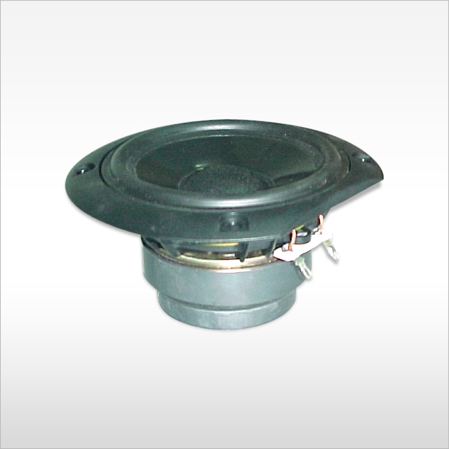

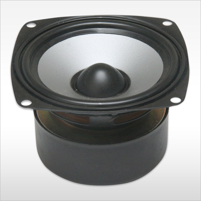

For a starter these drivers are OK to work with. Try inserting the
numbers to simulate a box response around Fs and see for yourself
how big a box is acceptable.
Peerless M10NG(BM)-8-lg an 8 ohm 4 " bassmid,
Peerless SO8PESH-04 a 4 ohm 3" fullranger in a 1 litre sealed box,
Peerless TH T26S-X a nice dome tweeter
