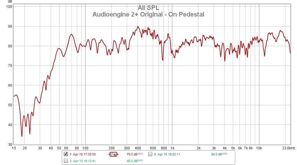

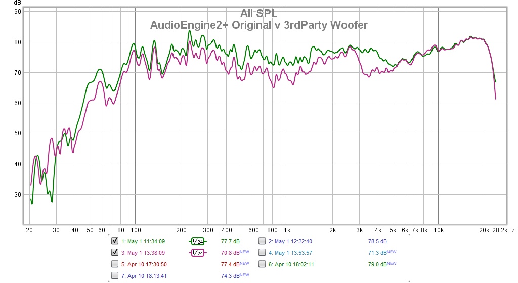

Today measured with REW and UMIK-1 with Audioengine 2+ plugged into laptop via USB.
Measured Left Channel (with active components) only, in situ sitting on bedside pedestal with UMIK-mic 0.5m away, on axis with tweeter.
Used single sweep, with length 512K. All graphs smoothed at 1/48.

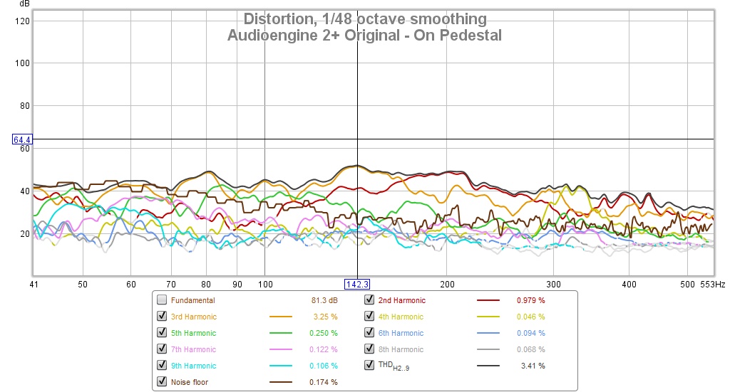

Distortion

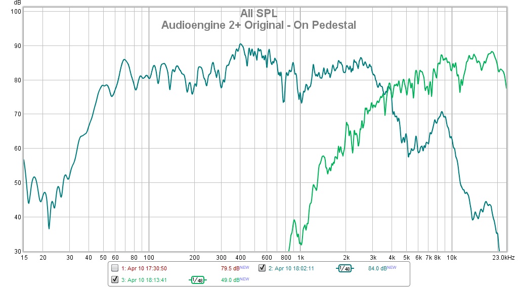

Re-measured - disconnecting each driver in turn.
At this modest volume I believe the THD over 3.4% at ~142Hz is considered fairly high.
I would welcome opinions and what I should be looking for or measuring.

I'd look at reducing the raised area around 500Hz, either with a notch filter in the crossover or EQ, and would probably call it good at that.
There's also a dip in the upper midrange area, which might be crossover-related. Changing the height of the mic might alter things, though, as there'll be some lobing between the drivers.

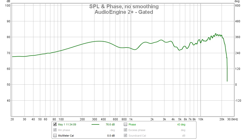

If you ***really*** want to know where there are problems, you need to perform a gated measure. Most dips/bumps can easily be related to reflections.
For sure the woofer breakup seems severe enough to be tamed.

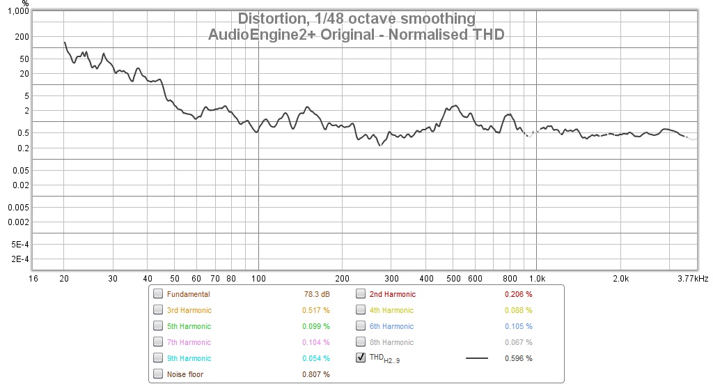

In addition to remarks already made: that distortion plot looks fishy: any 6/5/4" or so woofer has a rising profile south of 100 Hz, even at low signal levels.

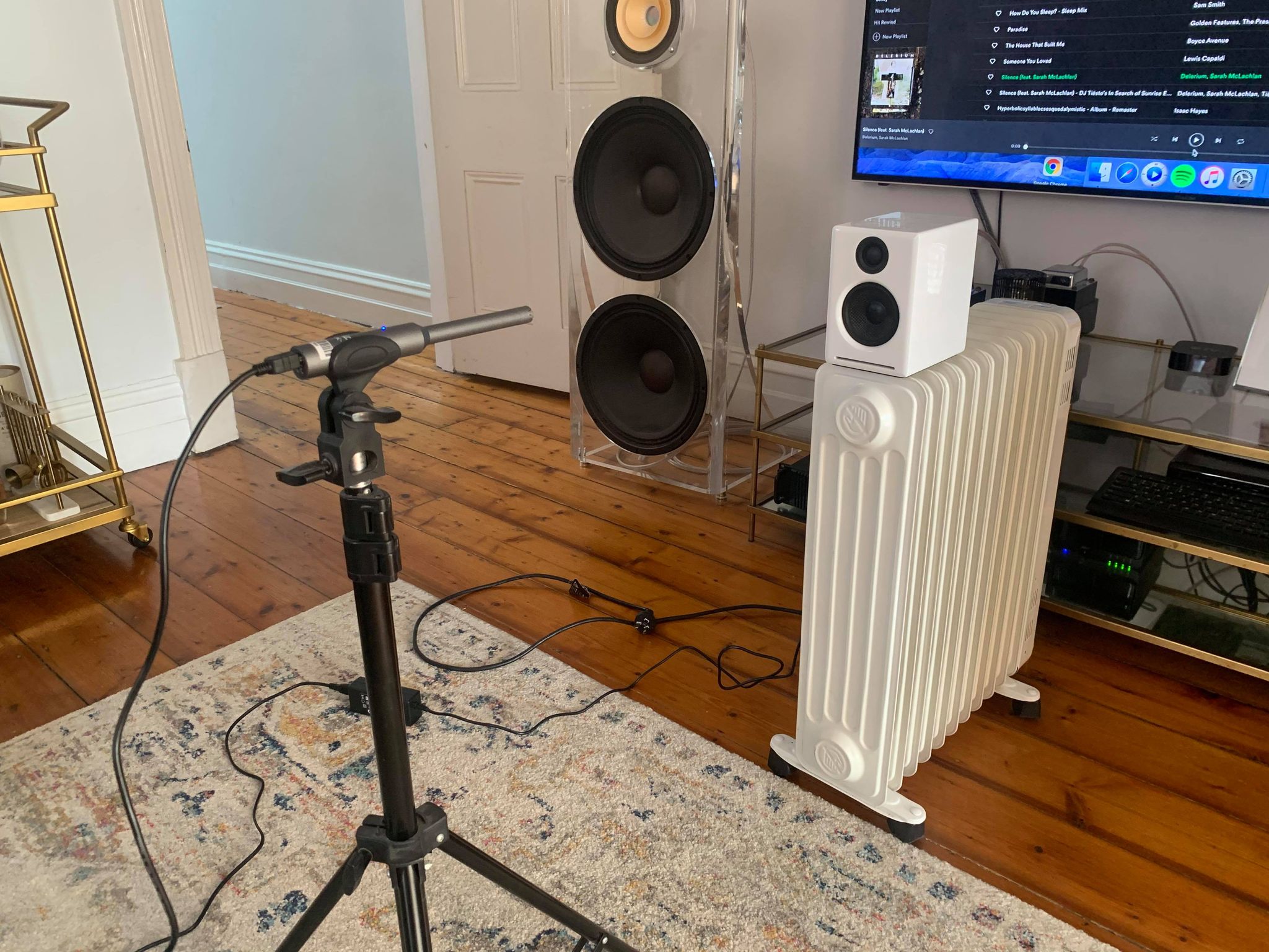

In the first instance I decided that Id measure in a different location - the bedroom location has hard wardrobe door very nearby. I decided to measure in my lounge - a slightly bigger room, with surfaces further away, and also thought id try it on a crude stand (a portable heater!) to see how much the bass is being augmented by sitting on top of the flat bedside table surface.
This totally removes the ~500Hz hump. The dip in the upper mid-range ~5K is still there. Next I might check the cross over and see if any changes can help.
The bass clearly receives huge benefit sub 100Hz sitting on the bedside table flat surface.
Thanks, I did a little reading and applied normalisation. Is this more what you'd expect to see?

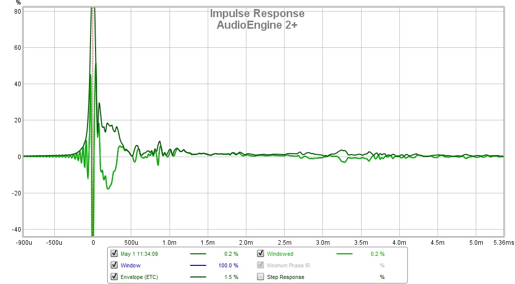

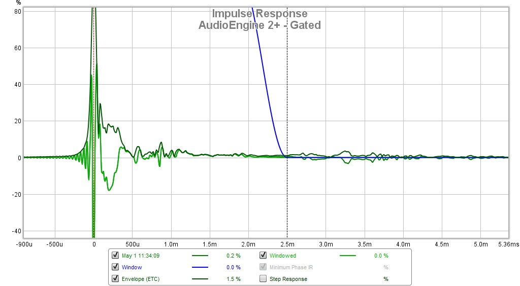

Cheers! While I moved to a less reflective location and setup for these measurements, I did try gating to learn - I've not done it before so I hope I did it right!?
There didn't seem to much obvious on the Impulse plots other than the ripples around 3.25ms, I assume at the low output level used, and less reflective room, there weren't significant reflections. I tried gating at 2.5ms.

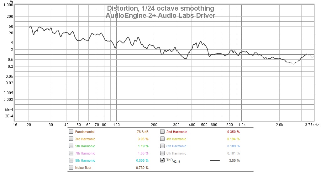

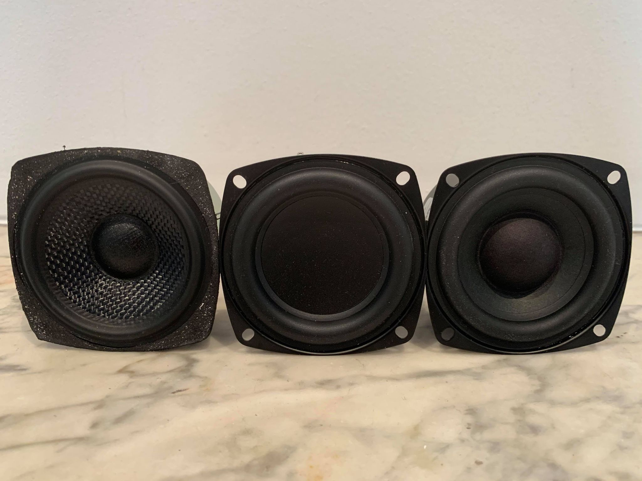

I also decided to swap in some low cost 3" woofers purchased from Ebay and AliExpress. These were selected based on

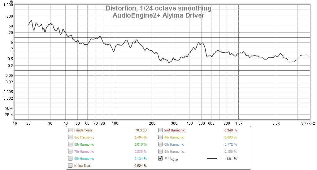

These were swapped and remeasured.The two alternative drivers had indistinguishable frequency response plots from each other, and both a little worse than the original, lower sensitivity, with peaks and dips in the mid-range.
The distortion however shows much bigger differences! The two alternative drivers have significantly worse distortion!
While I didn't expect the differences to be so great I really must commend the little factory driver in this comparison.
- Having the exact same frame size as the original
- Having the lowest claimed Fs, and being marketed for bass.
- Left(silver magnet) = Original
- Middle = Audio Labs. Purchased from Ebay, described as; "3" inch 4Ohm 4Ω 25W HI-FI Bass Audio Speaker Stereo Woofer Loudspeaker
- Right = Aiyima. Purchased from AliExpress, described as; Subwoofer 3" Inch 25W HiFi Subwoofer Speaker 4 8 Ohm Woofer Audio Sound Speakers Bass Loudspeaker Square DIY
