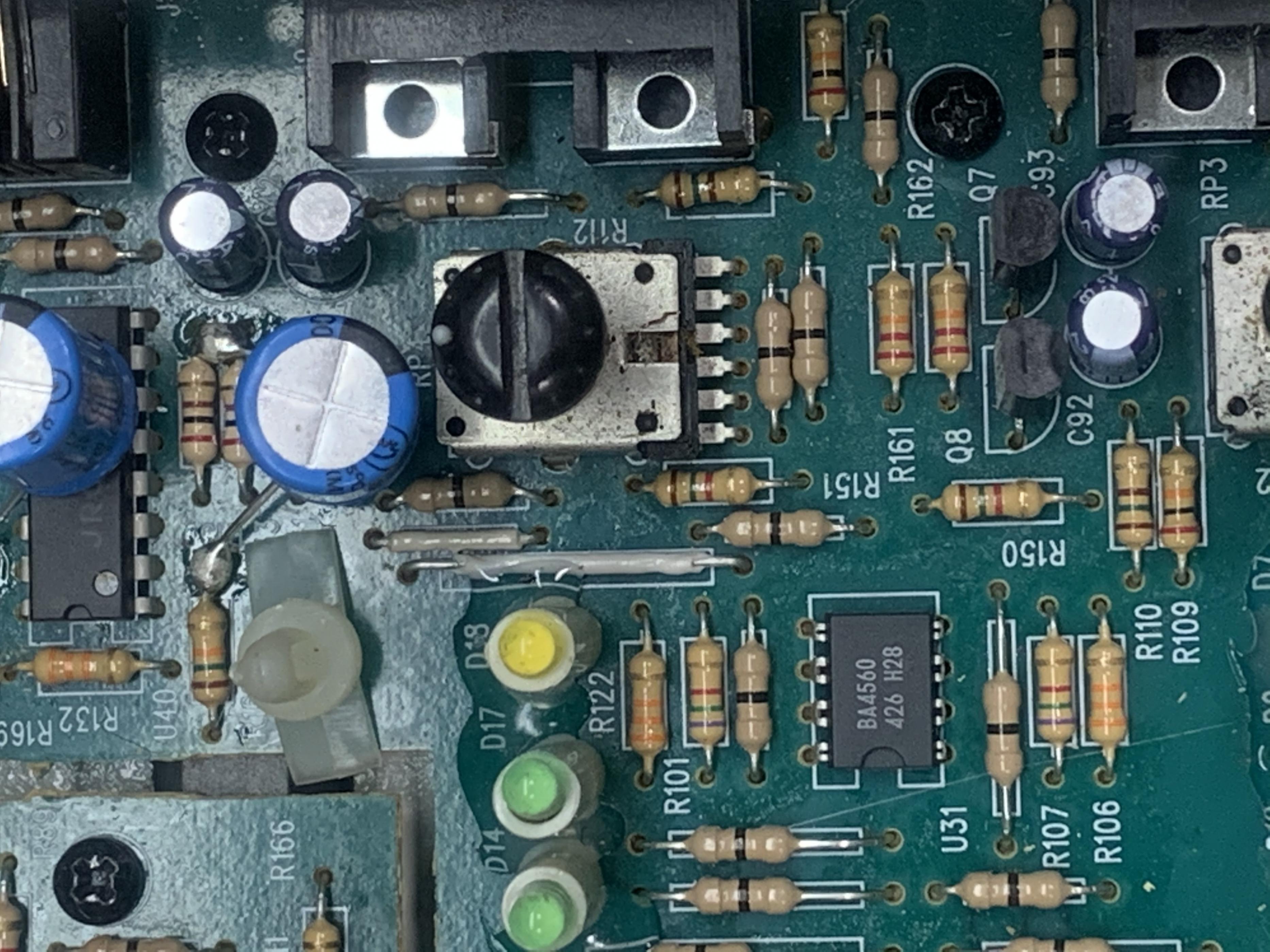

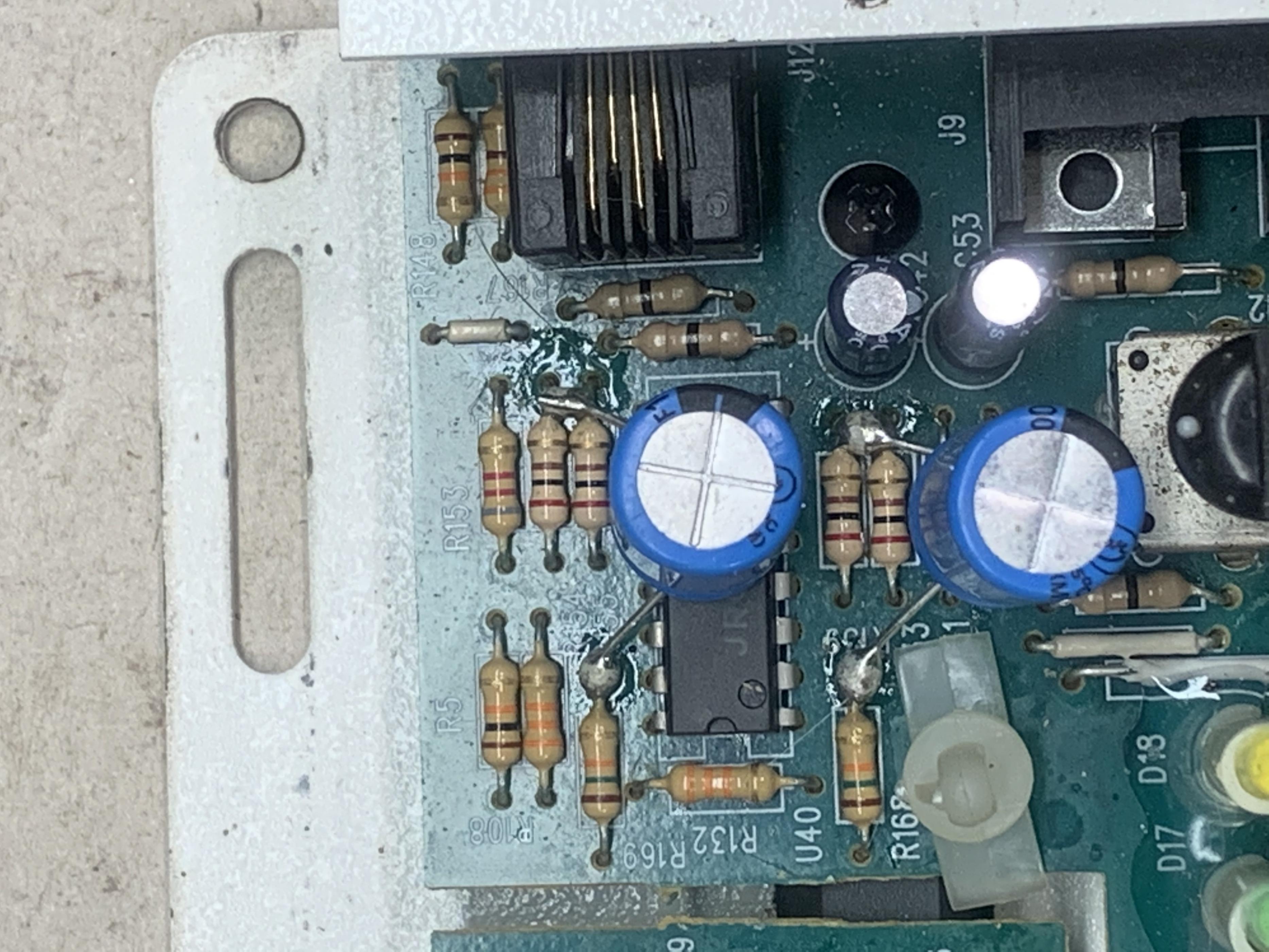

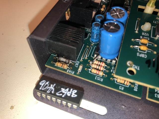

I just bought a used Audiocontrol 6xs crossover. Upon opening it up to see what frequency modules were inside I noticed a burnt resistor next to the remote level control jack. R167 is burnt to a crisp and R148 next to it looks like it got warm as well. I haven’t pulled the board out yet to see where the traces go but I assume it is part of the remote level input. First does anyone happen to know the values of these or at least the burnt one? R148 is a 10k, the other is unknown. Does anyone know if they had problems with the remotes burning resistors on the board or maybe have a clue what might have happened here? Any help would be appreciated. Thank you much. Mike

Awesome thank you very much. It’s a starting point and see what happens from there. I don’t plan on using the remote so as long as that’s what those are for I should be ok. I will replace them, it would be nice to know what exactly happened. I contacted the seller but of course it worked fine for him. Funny thing is the pins were bent pretty bad on the subwoofer module and one pin wasn’t even making contact with the socket. I know first hand they are easy to screw up and bend when your taking them out, the bent leg fell off when I removed the module. Maybe someone else may have an idea what happened. Thanks for the helpful information. Mike
Quick question at the end of the two resistors there’s a wire link with a white color on it, there’s actually a few on these boards. Is that all they are just jumpers with a protective shrink tube or something? Thanks very much for your time. Mike
