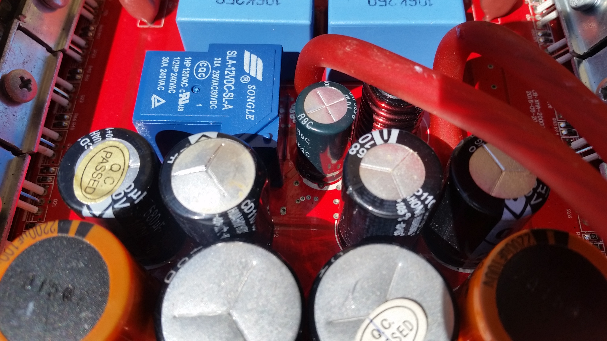

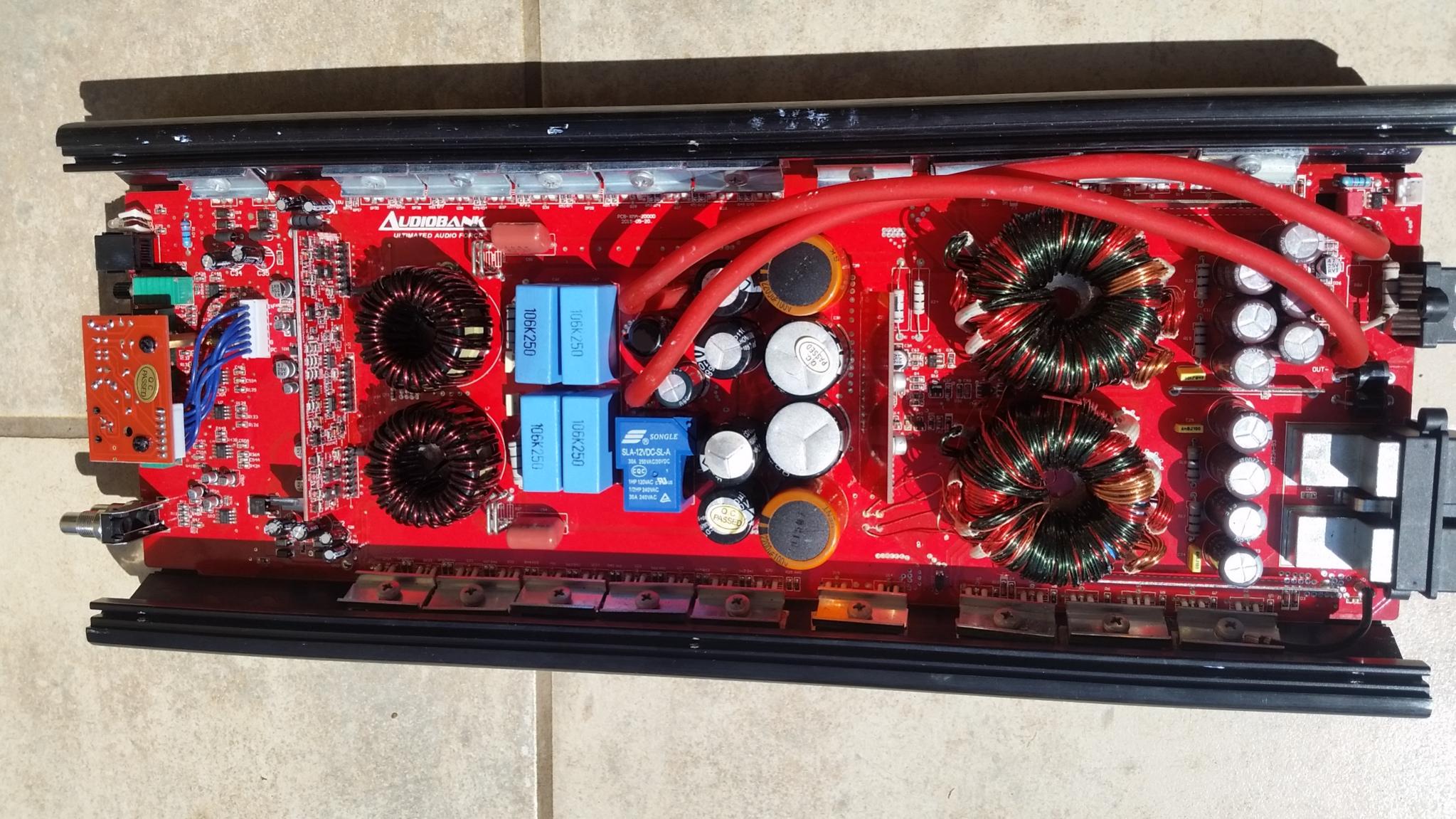

have another amp in blowing power caps
customer bought this amp and straight out the box it blew power caps on both rails.
sent it in under warranty and they replaced the power caps and sent amp back
3 days later it blew the power caps again
caps are rated 100v and rail voltage is + and - 75v
at 14.4v incar voltage never exceeds 14.5v
If you drive a signal into the amp (connected to a speaker or dummy load), does the rail voltage increase above the ±75v?
