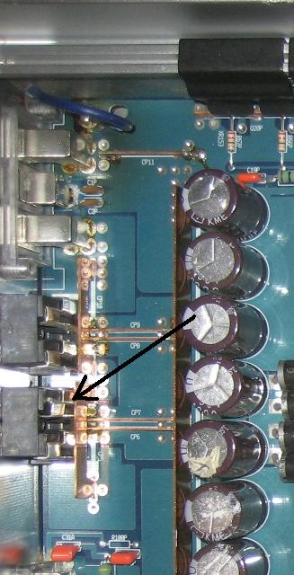

The amp appears to have blown the fuses again. Check them but don't replace them. Post what you find.
The fuses are good. The fuse holder in the amp had a brass piece that looked like it had popped out. I tried to fix it and no luck
there are 4 and the brass that snaps into the back of the fuse holder wasnt snapped it. That brass piece goes to the circuit board. All fuses are ok. Tried to fix fuse holder but no luck
A single fuse holder shouldn't cause the amp to completely lose power. Can you post a photo of the area you're describing?
Do i just measure by putting the probe on the brass bar going from the fuse holder to the circuit board? Right by where it states the name (Like CP6)?
With the black probe on the same point and remote voltage applied, are you still getting less than 5v to all pins of the 494?

OK, with the black meter probe on one of the non-bridging speaker terminals, what's the DC voltage on the center leg of the large output transistors?
Don't allow the meter probe to short to the clamps on the transistors.
Virtually all of the components clamped to the heatsink are transistors. The large transistors are the output transistors.
