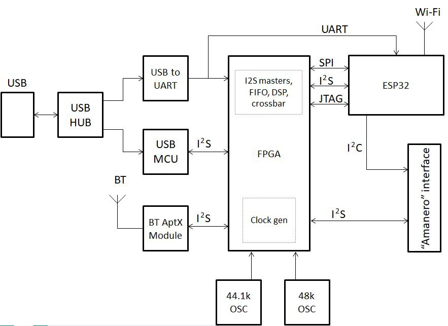

So, this architecture was born:
Hardware Features:
USB Audio interface (44.1-384kHz stereo)
BT AptX Audio input (in I2S slave mode)
FPGA reconfiguration (by ESP32 - no need for external programmer)
Amanero compatible interface
The device includes a module for AptX Bluetooth audio, addressing the ESP32's lack of support for high-quality codecs.
While the hardware might seem overkill with an 8K FPGA, it provides ample room for experimentation and DSP capabilities. It is very nice for experiments and hardcore DSP fun!

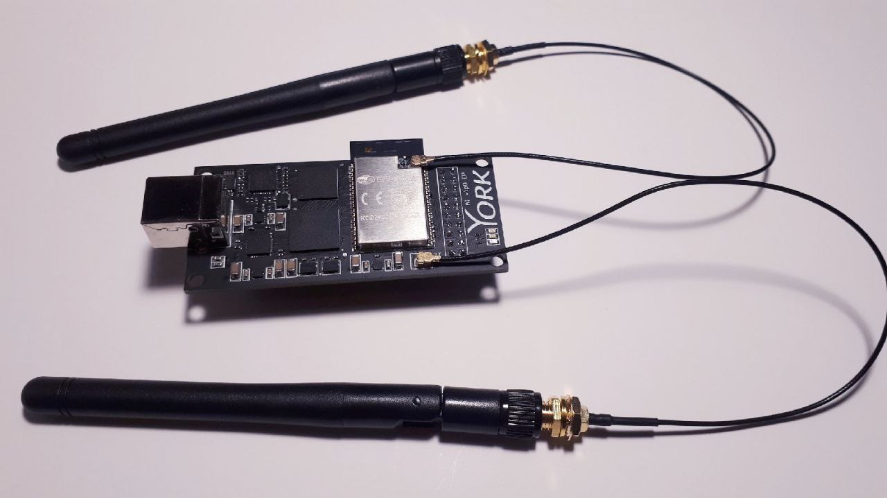

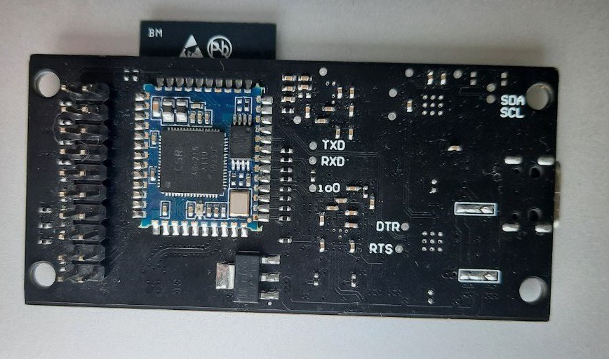

Photo of the first revision:
The BT module is underneath:

It is clear that the current hardware does not make much sense cost-wise: it needs an MCU for Amanero, an Amanero license, USB HUB and USB-UART chips.
Amanero MCU also requires an FPGA. Yes, the FPGA handles all stuff related to I2S multiplexing and clock generation, but all these functions can be implemented with one chip.

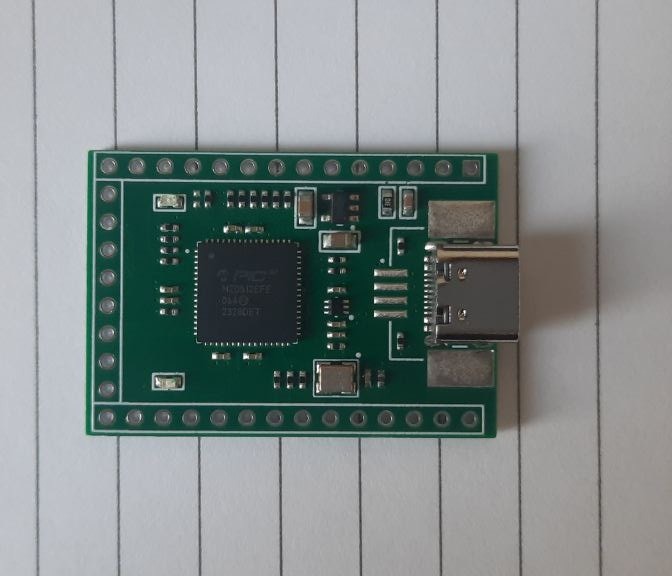

So for future version I'm going to use PIC32MZ MCU for as USB-I2S transport combined with VCP. That will consolidate four ICs into one MCU and expanding USB audio to support 8 channels (it can support both In and Out, maybe for future evolution)

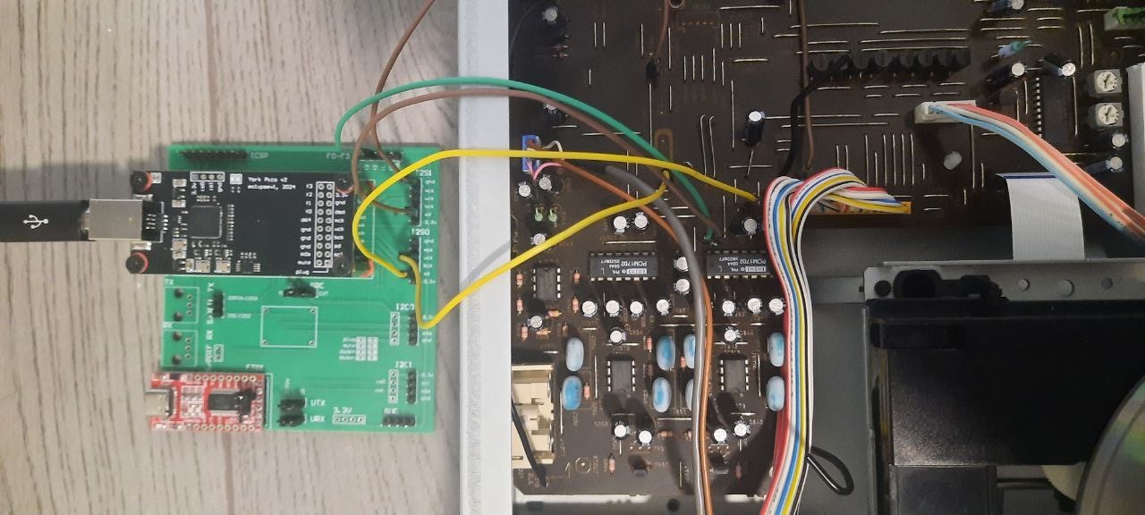

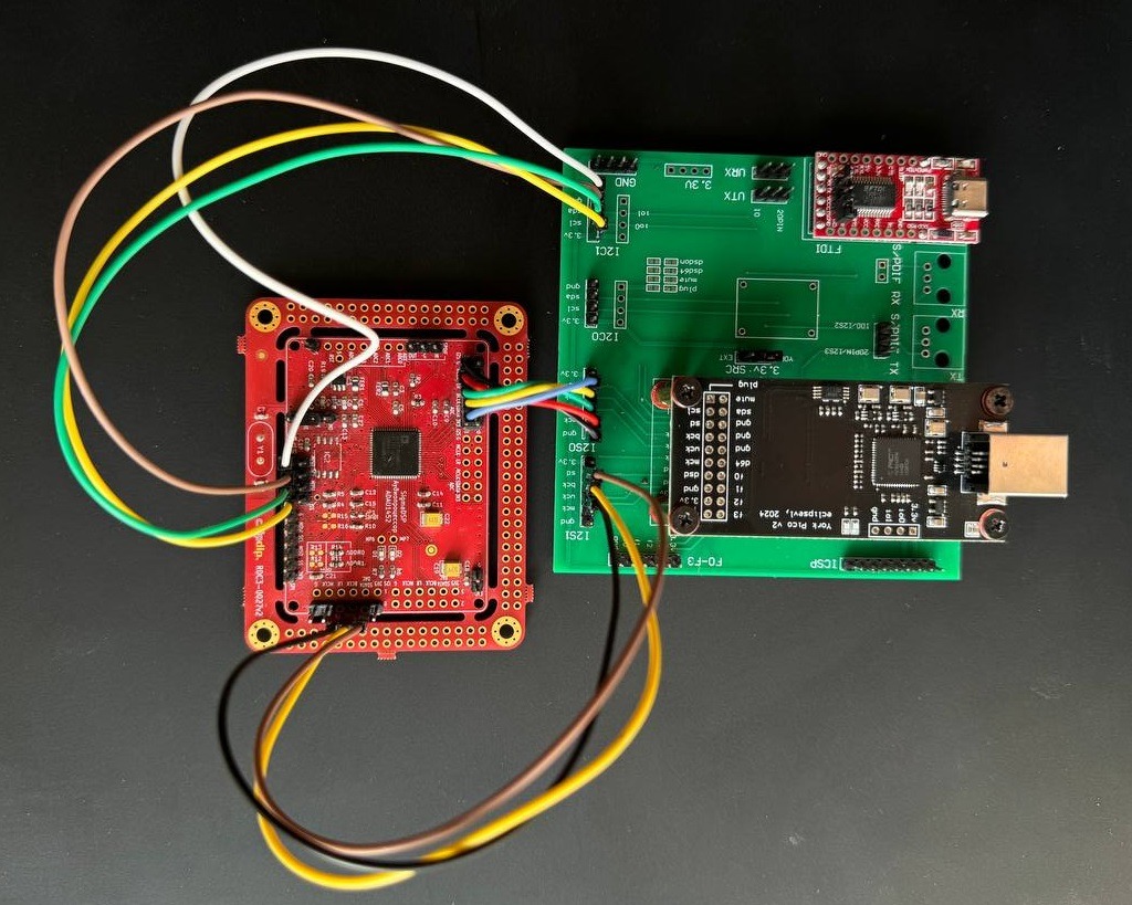

I have a prototype of PIC32MZ module based on firmware developed by Alexey (Dortonyan) posted on Vegalab forum.

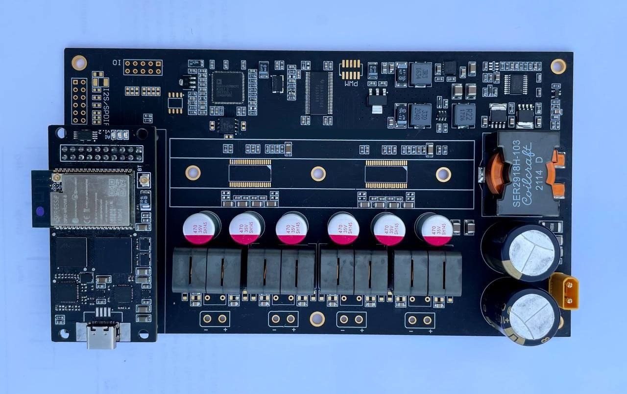

Here's a photo of the hardware in my 4 (8ch) Class-D amp with ADAU1452 DSP (probably worth another topic)

I wanted to share my audio transport module project called York.

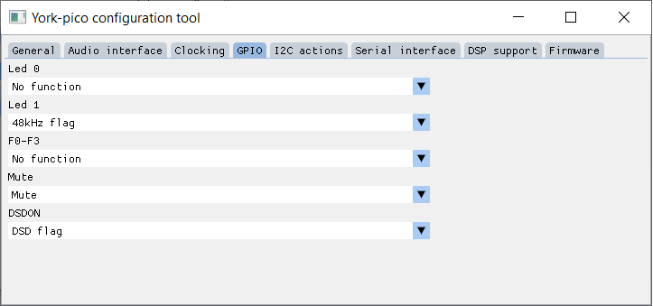

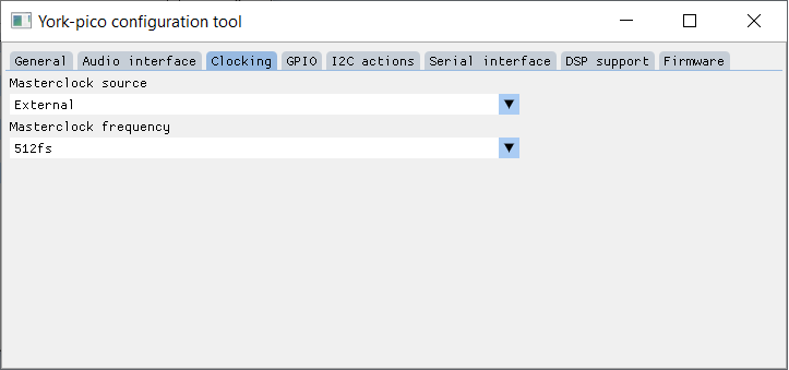

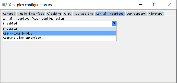

Alright, it is converging to something. At some point I should just stop putting new features and release it
As I said, I was working on the configuration tool and on the firmware side as well to support all these configuration options.

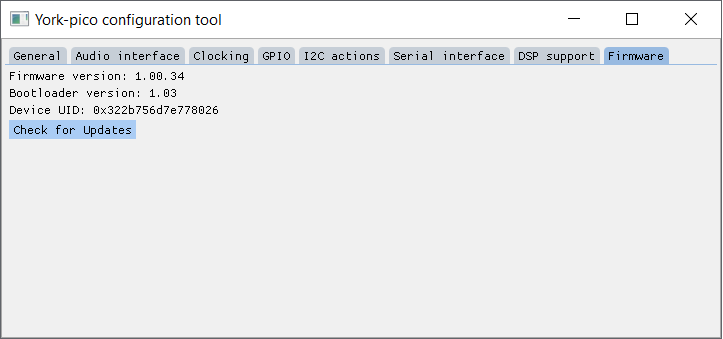

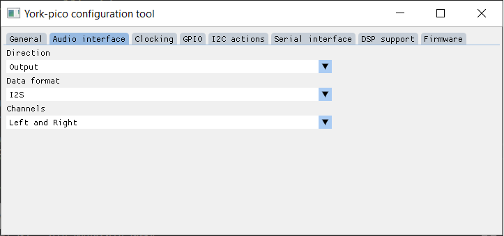

There are several tabs: general, audio interface, clocking, i2c, gpio, serial interface (UART), DSP support (for ADAU) and firmware.
Firmware update mechanism is already in place as well as many other features, currently I'm stiching everything with the user interface.
Screenshots attached.
I'm going to release some source-code and a library so that users could build their own custom apps for Windows/Linux/MacOS.

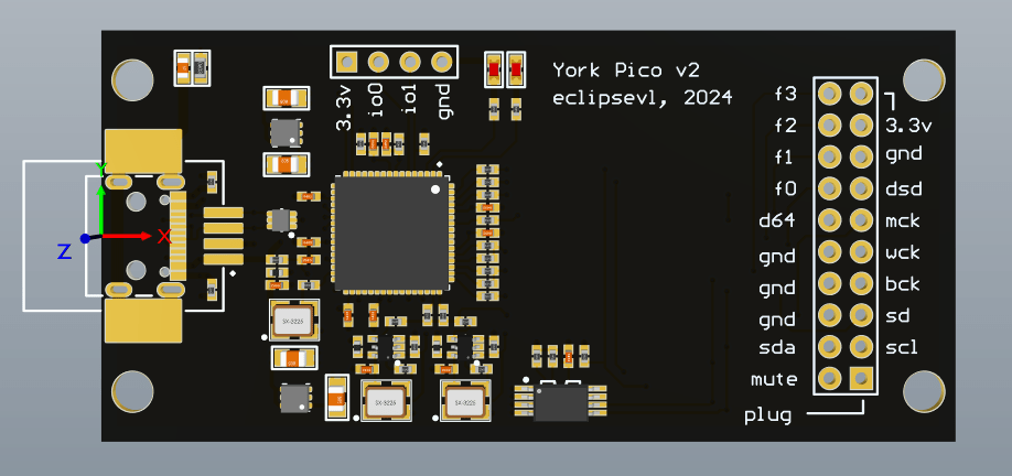

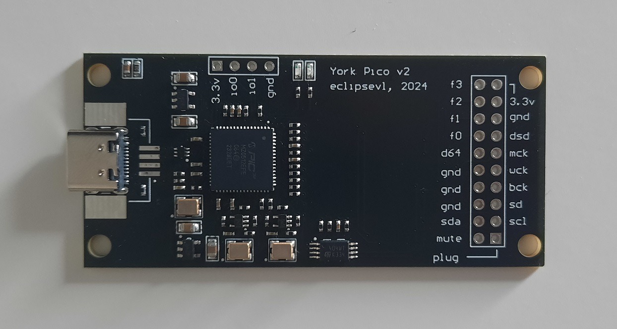

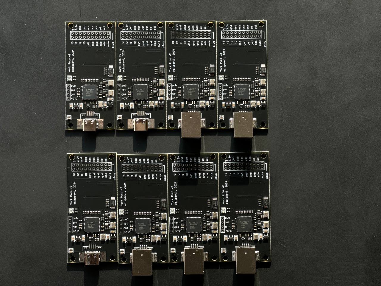

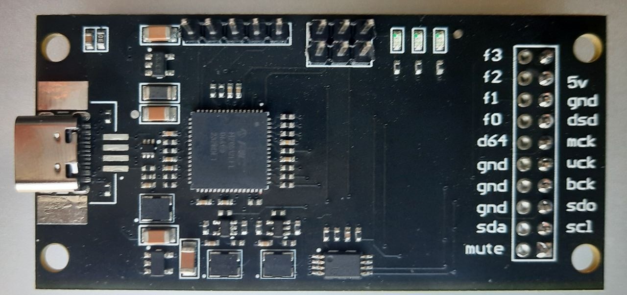

Second HW revision is ready for production. There are some important changes done to be compatible with FreeDSP projects and to enable TDM8 output. I also managed to implement SPDIF output.
IO0, IO1 can be remapped as GPIO/UART/I2C/SPDIF.
Also, a second I2S is available on pads F0-F3. Can be used as I2S input, for example. So the module could handle input and output streams.
