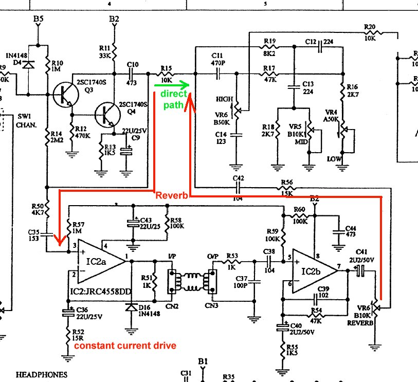

I suggest you check what 80% of manufacturers use (such as Fender/Laney/Marshall/Peavey) to get reverb in their amplifiers.
Most basic is just a TL072, go figure.
One half driving the high impedance tank constant current, which makes it happy, the other recovering delayed signal.
Here´s the Peavey example:
Didn't think the TL072 could put out the current needed to drive a four ohm tank. Good to know. Oh wait, high impedance tank. I was trying to do a low impedance tank.
We are talking the Organmate reverb tank here, and it´s high impedance.
