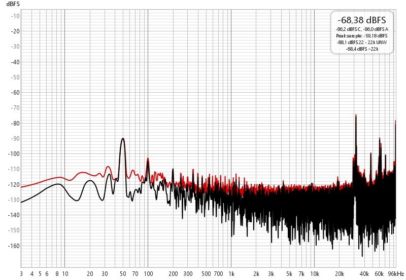

Trying to use ADC to I2S on WM8782 + SA9227 USB interface and this is what I get with floating input, any suggestions about high frequency peaks from WM8782 ? Powered by LT3042 with linear supply. Now it works without shielding, but I think it is not RF from PC at so low frequency.
