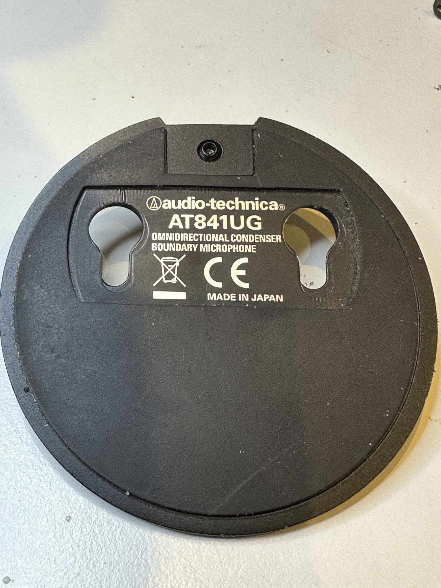

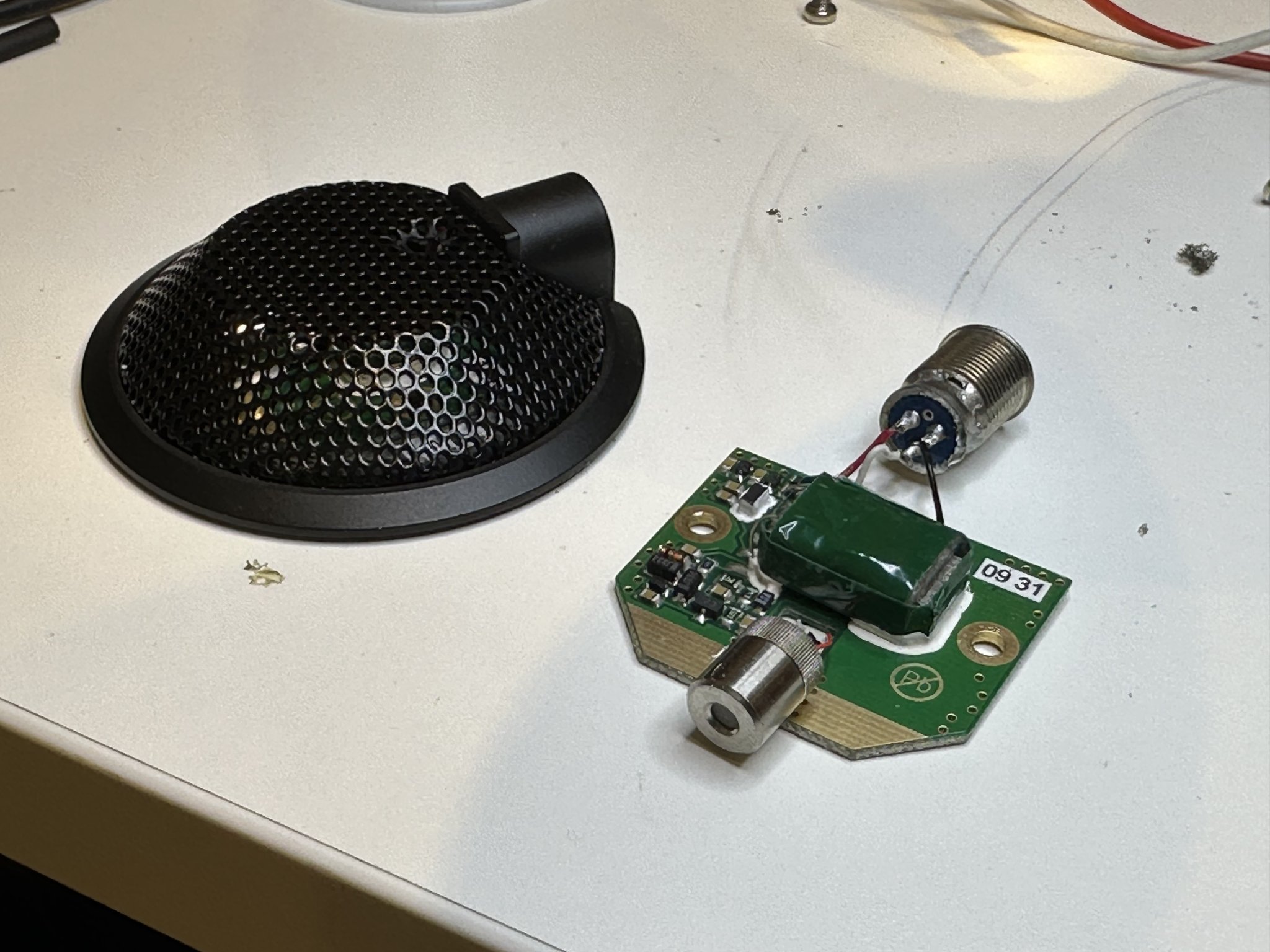

I am trying to set up a mic that might work as speaker measurement tool, and I remembered I had two of these AT841UG omnidirectional mics running on phantom power which can be supplied from Scarlet 2i2 I also have. The capsule looks like it means business. From test measurements SPL looks fairly flat but distortion figures are a bit concerning.

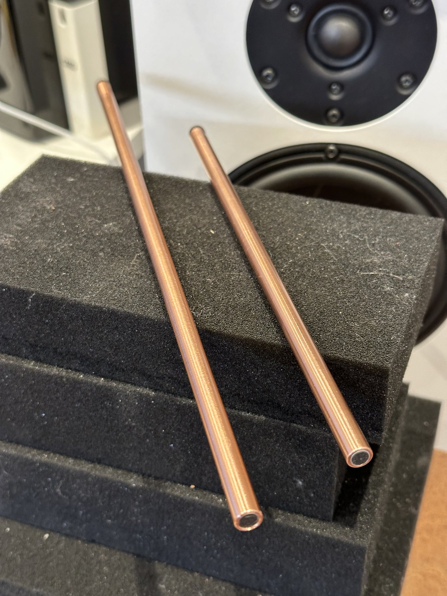

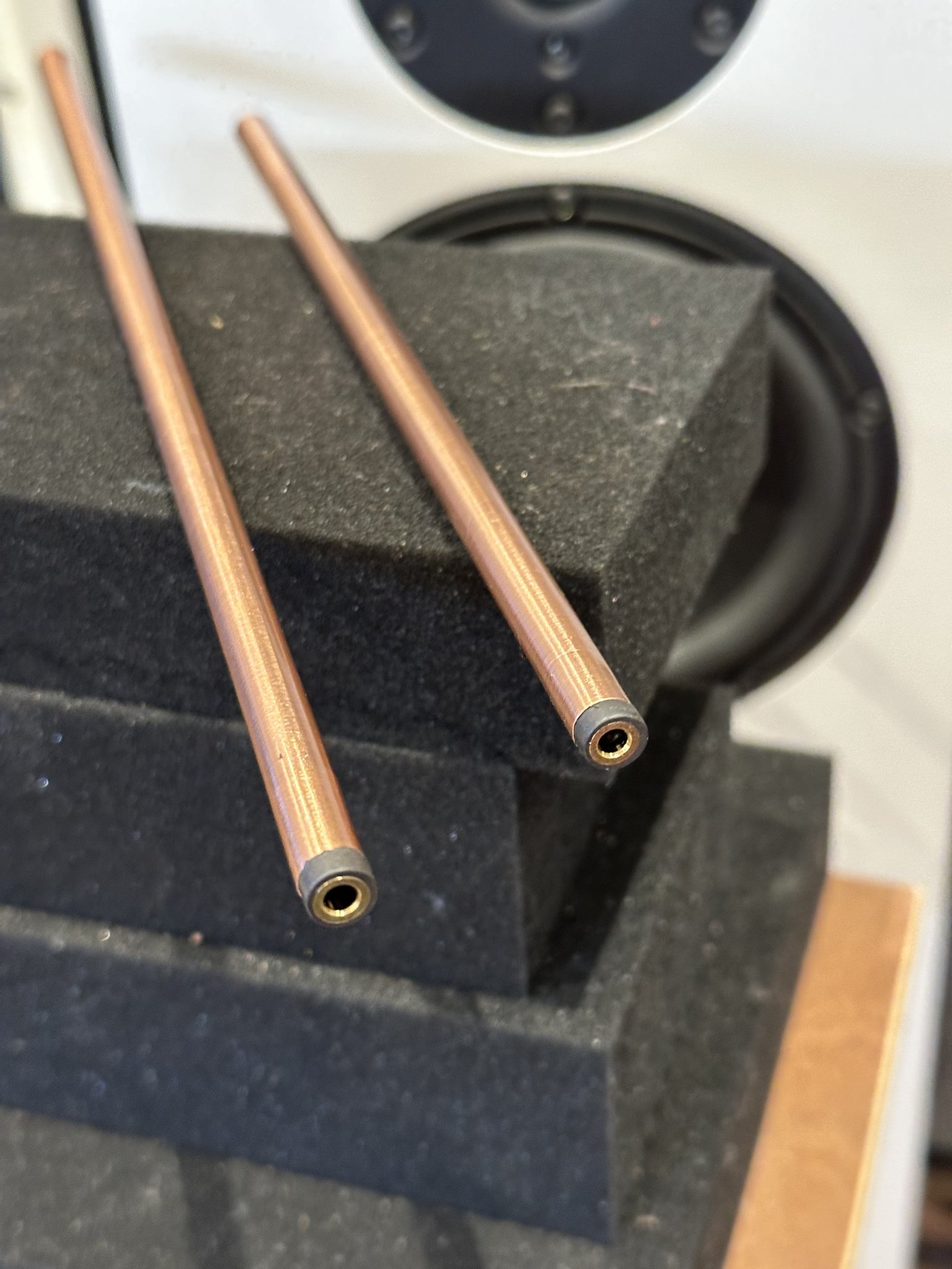

Thanks for the reply. In the meantime I found two capsules which gave a lot less distortion right off the bat, so went ahead and made two mics out of them. The AT mic in OP is omnidirectional conference room mic, so not sure it's worth the effort. My main concern now is how to calibrate the mics without having any other calibrated equipment I could compare them to.
There is no need for calibration.
The demand for microphone calibration is the approach of commercial participants to squeeze more money from the DIY community. If one of their products is inferior, the DIYer can find out without calibration. Start with your distortion measurements. Join the challenge. Do not get deterred.
The approach i show in LRDDMC is designed to deliver a meaningful result with any microphone. I repeat: any microfone. It just happens you already own the AKG. The beautiful sticks you build are a really competent approach. Join the Challenge, we will find out about your microphones.
Btw. your measurement looks very promising ;-)
Of course you need calibration in case you want to measure a loudspeaker's frequency characteristic (SPL) . A relativley easy way is to have a known system measured by some ref mic and compare the measured SPL curve ( file) to your mic. The difference between one and the other measurement (an .frd or .txt file) will be your mic calibration file as applicable in e.g. ARTA. That diff file, your calibration file, could be generated by VituixCad or REW.
