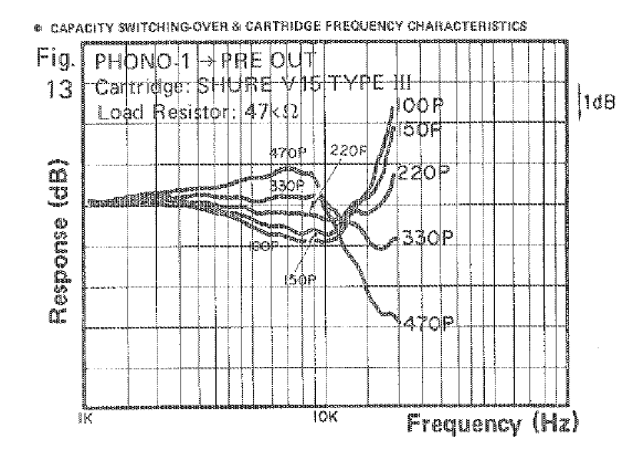

On the topic of cartridge loading.
The typical capacitances are as follows:
1. Arm tube wiring capacitance ( 30 pF ? )
2. Connector capacitance ( 10 pF ? )
3. External cable capacitance ( 120 pF per meter ?)
4. preamp input capacitance ( varies .... 47pF min ? )
So we might get up to about 200pF very easily .
Is this correct ?
Looks like the ones that are controllable are 3 and 4.
We could probably find some 60pF per meter cables and manipulate the preamp input cap.
Actually a cartridge manufacturer suggests a load for their cartridge,that totals all you have mentioned.In the end,it is the ear that will decide if you will use more,or less capacitance,depending on what you hear from the system.If it is something that can be controlled by the capacitance,then you are lucky!!!!!!!!!!!!!! Usually,amplifiers have around 100pf at their input.
The resistance load also matters. Lowering it can soften the sound.
I have just got a 440MLa . It does sound a bit bright. I should reduce the resistance and try. Increasing the cap will decrease the resonant frequency.
Since most modern cartridges seem to work better with a lower capacitance load than older cartridges, maybe the basic input cap of all preamps should be lowered with the option of increasing it in 50 ( or 47 ) pF steps. Mine starts at 47pF.
ART cables (American Recorder Technology), use Mogami cable and have 17 pF per foot. They are cheap at KABUSA.com.
Belden 89259 also has similar specs in case you need to lower the total pF between your headshell and the Phono Stage or Preamp in.
I have an old NAD 1020 which has a very decent Phono Stage for an old, cheap Preamp. It has an nice setup. At the Phono input, it gives three choices, 100pF, 220pF and 320pF. That would be nice if they were all like that. But people like us wouldn't be happy and we would change it anyway! LOL

Some people ascribe a "bright" tonal quality to these cartridges, citing a +2dB frequency rise above 10khz.
You can always get rid of this by using the correct termination capacitance. For the 150MLX I think 150pF are correct and usually achieved already by the phono cable itself. So most 150MLX have to work with too high capacitance and produce therefore this phenomenon. It's just improper setup.
All the best, Hannes
You never get rid of brightness using capacitance without drawbacks.There are too often cases where capacitance "tames"some brightness on paper,but in the real listening world things sound compressed, aggressive and harsher.You might prefer the "original" brightness eventually.So,careful with those caps.
