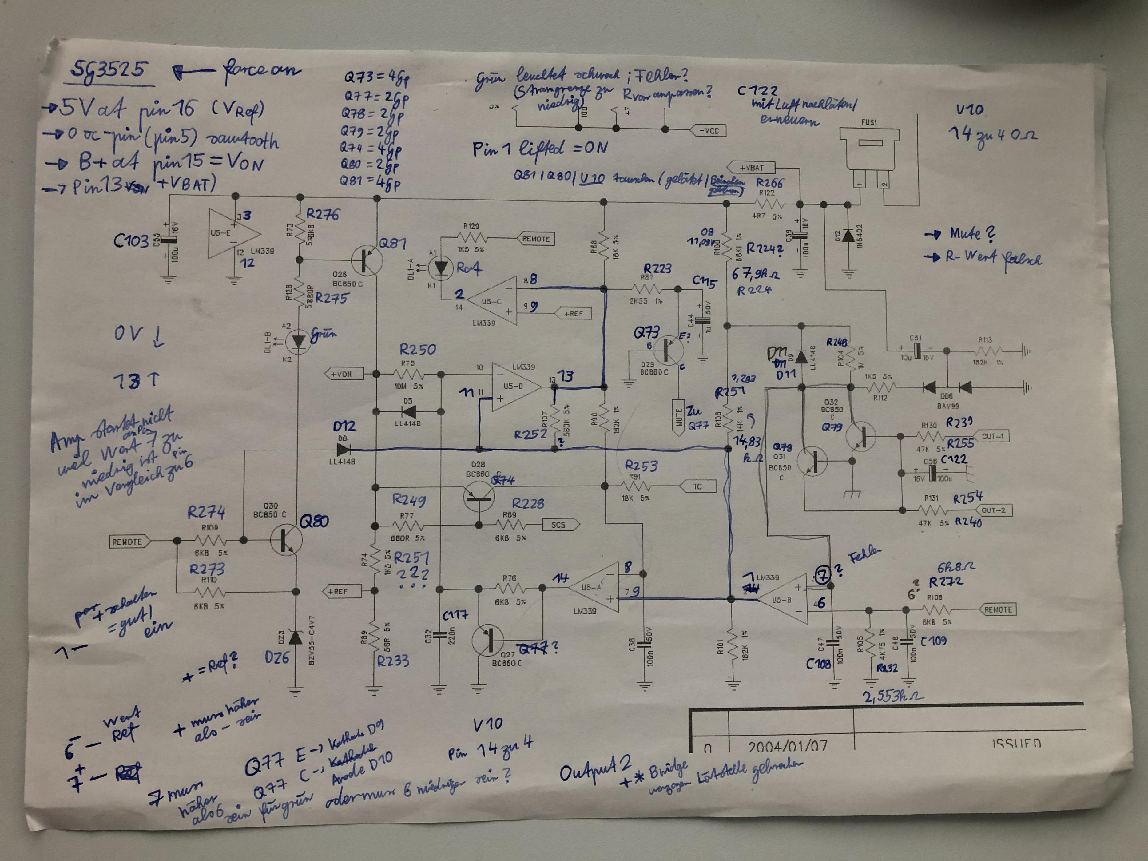

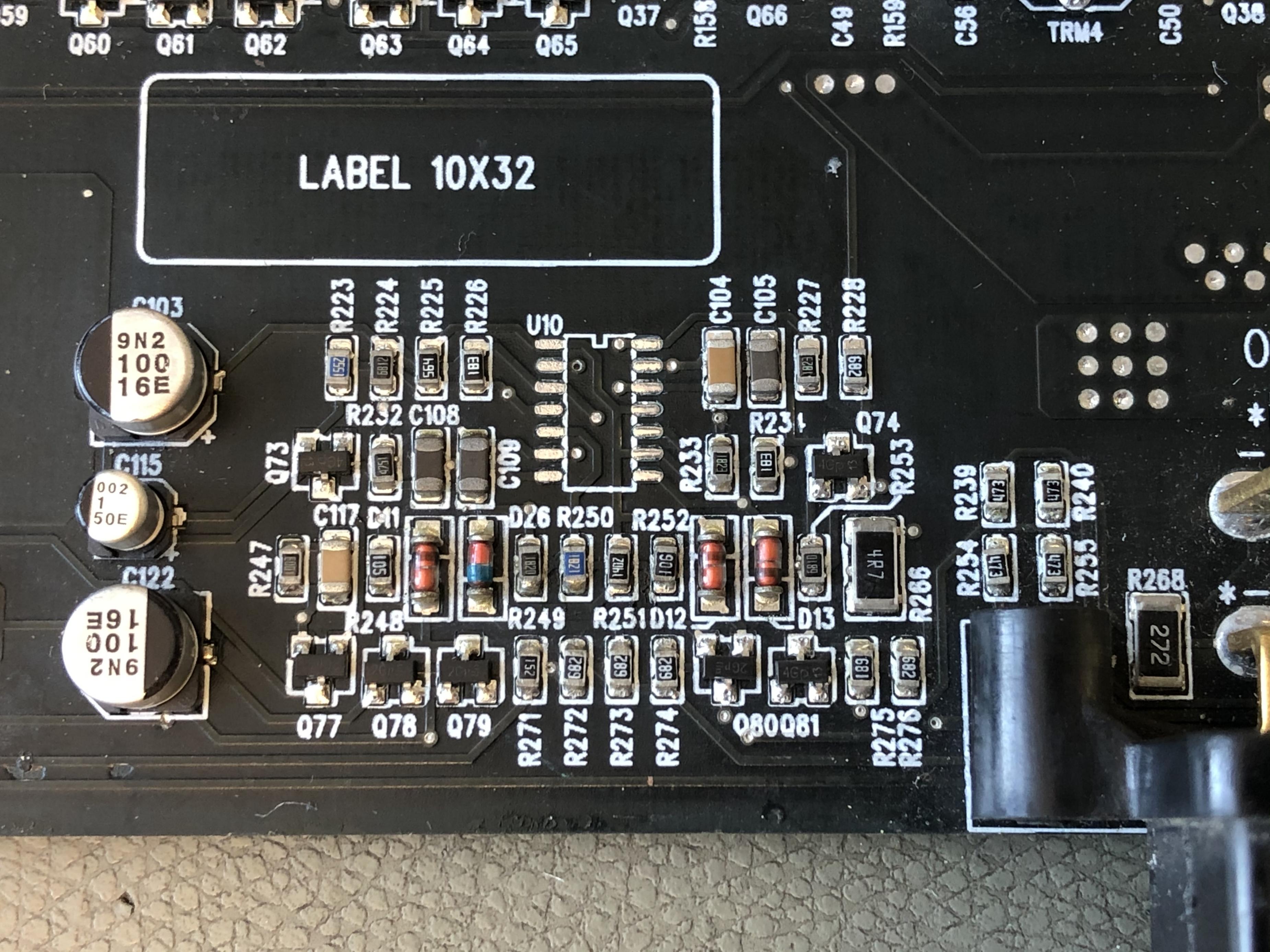

I switched it on, only protect lit up. No life sign from the power supply.
I wasted a lot of time on the protection circuit, in the end I tried everything I could think of.
LM339 (U10) Quad comparator
Triggered the comparator outputs, Replaced the LM339, measured every SOT23 (2Gp - BC850C NPN, 4Gp - BC860C PNP) transistor out of circuit and checked the resistors on the paths.
I used the schematic of the F2-190, backtraced as far as I could.
In the end I switched the Remote after the B+ on. That "solved" the problem. No Amp before had a problem with Remote and B+ on at the same time.
Should I look more into this?

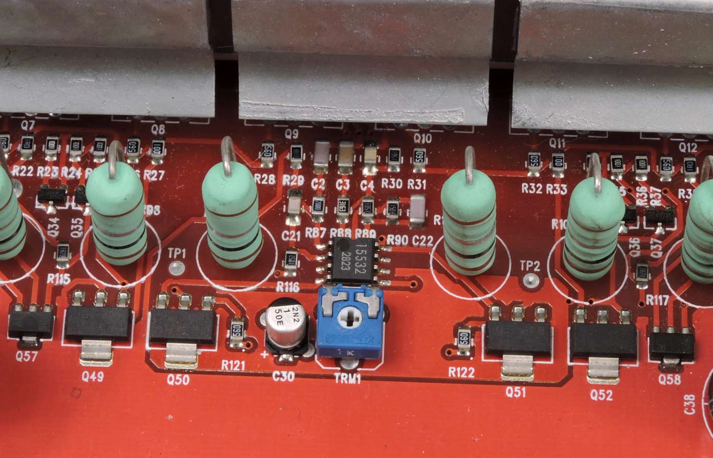

This is good reminder for those working on GT trading amps. I didn't see many (any?) Twister amps here but Boston and Polk(?) had amps that used similar circuits and wouldn't turn on when remote and B+ were applied at the same time.
If the boards don't have GT Trading on the board, the layout with the op-amp very near the outputs and the bias pot is a good way to identify the GT Trading amps. This is for a Boston amp.

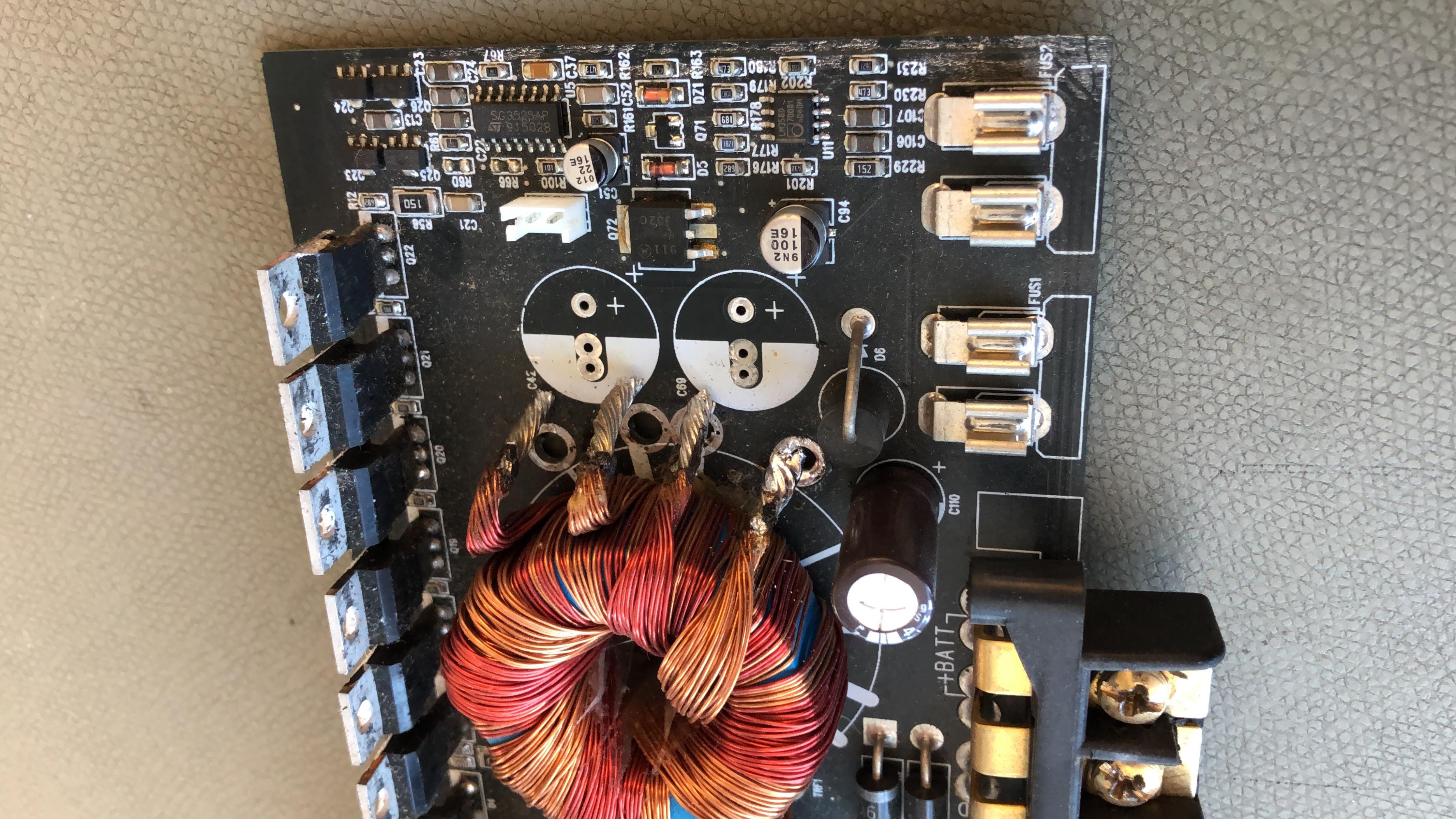

Audio System Amps are build pretty similar in shape and design of the channels and drive circuits.
I used this schematic as a reference. Picture 2 is transcribed to the notation of the F4-560
