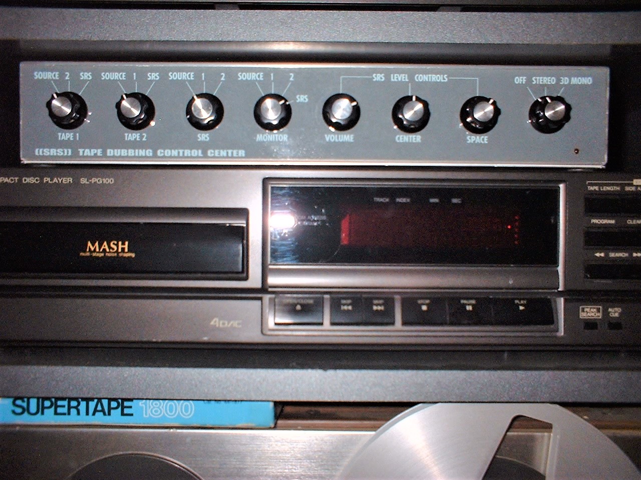

My way of doing the grounds is this.......
All in-out jacks - grounded to their appropriate end of the signal board (input ground/output ground.
Case grounding to the main power supply ground.
Almost every device that I've built or modded is done this way and is dead silent.
