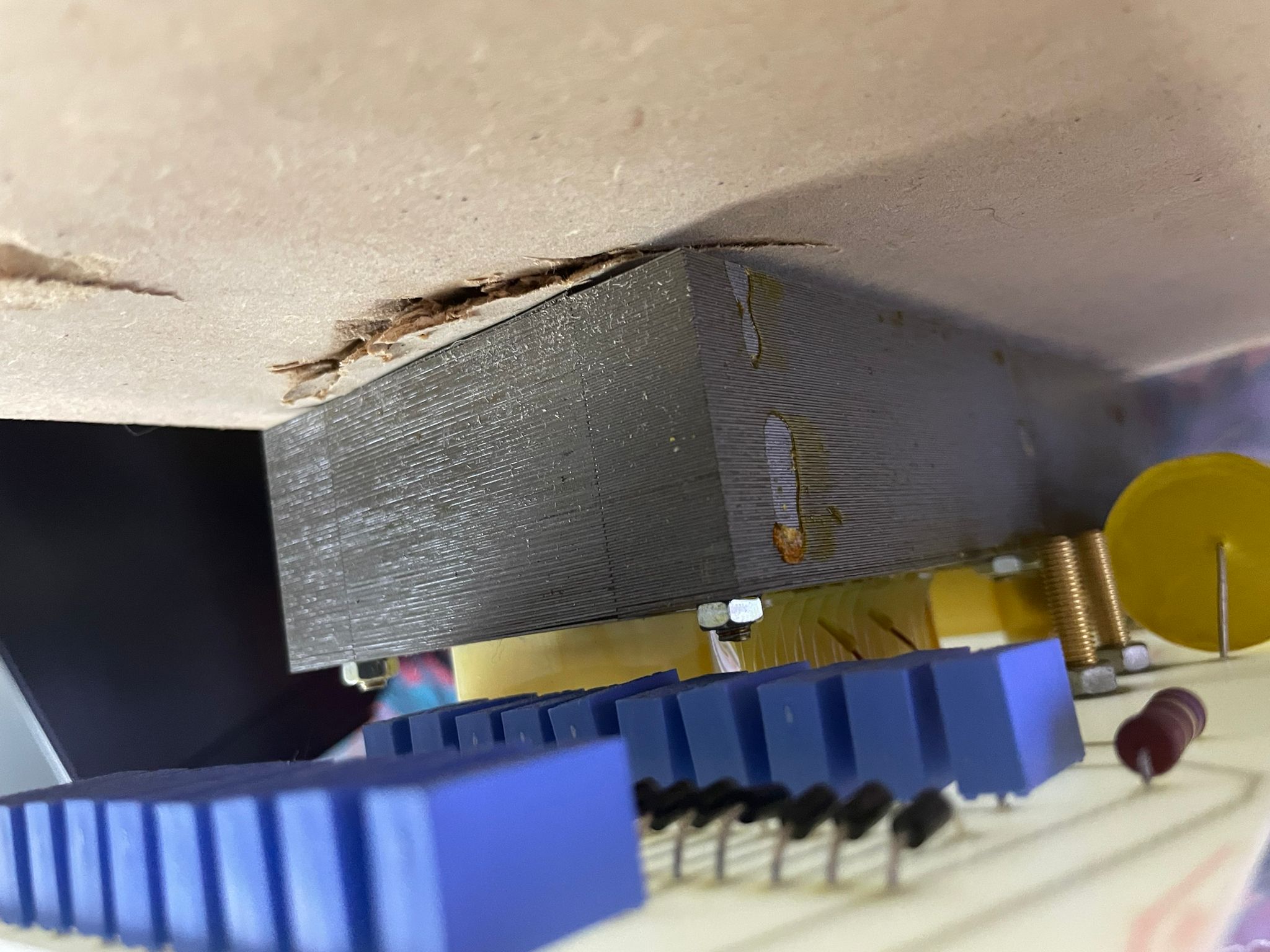

Hi all,
please help.. 😱😱 During the refurbishment project I managed to damage one of two transformers windings on the ES100 driver. Does anyone know the original specifications or suggest transformer replacing all of them?:scratch:
There's also a hole in the mylar so I need to get them replaced as well.. I already reached out http://loudspeaker-repair-service.reromanus.net/ but had no answer. I already removed the panels from the sides and no I didn't made the hole during the removal 😉
Thanks for advance!🙂
Best
Jarkko

Did you measure the transformer? Chances are it is still ok. Secundary should be around 1kohm. Primary winding a fraction of an ohm. In that case you're ok.
Best way to remove the pcb btw is to unsolder the transformers, leaving them in the wooden base.
For replacement of the mylar you can order all you need from ER Audio and diy a new membrame. Lots of work but no rocket science. Otherwise you will have to find a specialist to do this for you. Where are you located?
