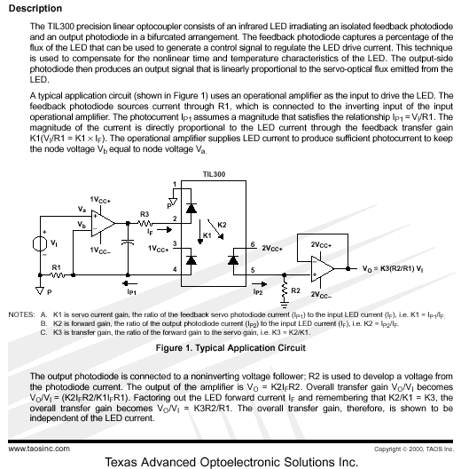

Texas Instruments TIL300 is another.
This one is interesting because it allows feedback correction of the signal. Light is shared by 2 light sensing fotodiodes.
This TIL300 was used in a circuit in my Swedish Elektor 1/98 (can be last editon of 1997 in original Elektor).
See the diagram of the princip, taken from TIL300 datasheet.

The circuit used simple OP-amps TLC271, but still distortion was low
with a signal 10Vpp at single 12Vdc supply.

since you are using an op-amp with a photo-diode (and what the PDF's don't tell you) is that you have to be pretty careful compensating for the photodiode capacitance. these things are easy to get oscillating. Burr-Brown (at www.ti.com ) has about the best application notes on taming photodiode amplifiers.
the TIL300 is made by Texas Advanced Optical ( www.taosinc.com ) -- they purchased a lot of TI's analog optics product line. I use their TSL230's and TSL235's. They also make pretty acurate RGB sensors. The TIL300 line is distributed by Future-Active in the US. There is another product, the IL300 from Vishay, but I haven't played with these.

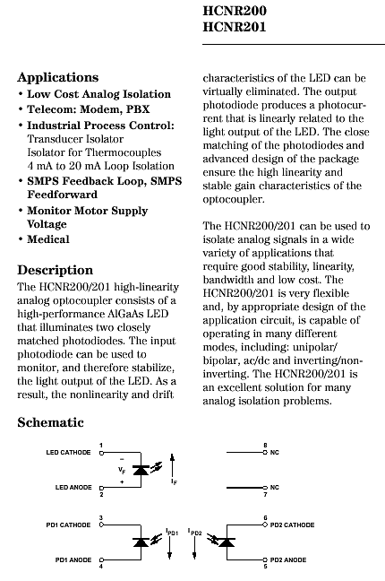

High-Linearity Analog Optocouplers Technical Data - HCNR200
/halo - bureau of investigation :cool: at work

I want to use applications that are more direct
that can be a part of a circuit like a component.
This is Hewlett Packard HCNR200
High Linearity Analog Optocouplers, uses 2 photodiode techniques.
One can be used to correct the signal via feedback.
