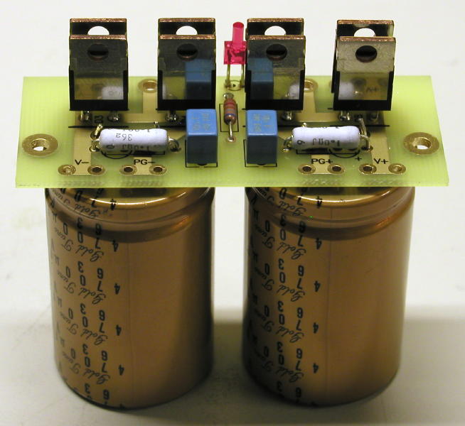

1 You don’t need to fill the whole board; 8 rectifiers and 10u caps are minimum required to run the amp. Additional parts are for snubber option, and the best is to follow Carlos' latest combination http://www.diyaudio.com/forums/showthread.php?postid=703003#post703003
I’d like to remind everybody that snubber idea was introduce into chip amp circles by CarlosFM. There is also the spot for bigger caps, that are used when snubber is involved (see picture below).
2 You can use LED holes even when not all components are mounted on the board. With LED connected, R3 has to be on board as well, as it’s in series with LED and provides drop from full supply voltage value.
3 If you use the snubber capacitors, C1 and C3 cannot be installed, as this place is used by R1, R2 which are part of the snubber. However, the bypass cap can be installed directly across the big cap, and the value recommended by Carlos should be used.
4 The advantage of using fully populated board will depend on your system and taste. I don’t like neither the snubber (not anymore at least) and I don’t like the Zobel, some people like it though and they claim it’s the biggest improvement to chip amps. Well, that’s why I created that option on my boards and you are free to experiment and make your own decisions.
Snubber seemingly increases dynamics, the bass response, and even resolution, but at the same time introduces some colorations that may not be accepteable by people who prefer more natural presentation. One musician who was listening to my amp with a snubber described it as synthesized sound with unnatural tonal balance.
Zobel is useful when your speakers or cables present unfriendly load (to the amp). It some instances the interferences occur and Zobel may cure it, but more than often, does not, and different measures have to be taken (like replacing speaker cables). Zobel also changes tonal balance, and some people prefer it this way.
5 It doesn’t really matter if you use 220R or you use 1K series resistor, you can also use anything in between. I find that lower value brings less sonic signature, but presently, I’m not using any series resistors at all, and the sound is even more transparent.
6 You need to install Rf, which is a feedback resistor.

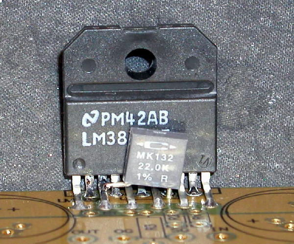

Sorry if this is a stupid question but is the Rf resistor the 22.1k resistor soldered between pin 3 and 8 of the lm3875 or is this another one, because I have soldered it below the the board if it is. The only reason I ask this is because I got 4 22.1k resistors and had none left by the time I got to the Rf one. 😀 and that would make sense.

Here's the preferred way to mount feedback resistor. Although it is intended for Caddock mostly, it should also work with regular resistors. There is a small hole right beside pin 8 for one resistor's end, the other end solders directly to pin 3 on the chip. This method eliminates the chip pins length (when mounted underneath) and allows shortes feedback loop, at the same time being easy to implement, without need for elaborate resistor pins bending. 😉
