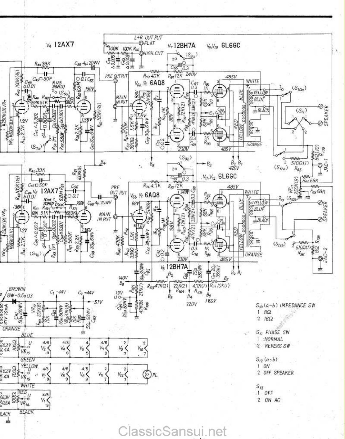

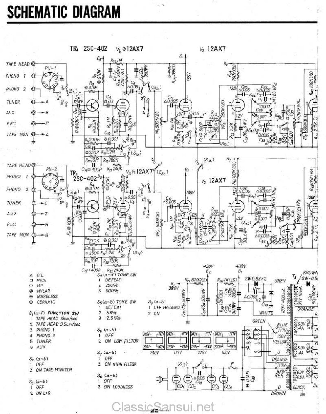

Using secondary winding as part of cathode feedback is an el-cheapo cost-saving solution, think again, it even do not fully de-couples speakers from high-voltage supply rails! It the past it was used in middle-range Sansui AU-70 amplifier costed around $150 (this kind of schematic requires 2 center tapped secondary winding 2x8 or 2x16 Ohm, grounding 4 Ohm tap of standard 4/8/16 Ohm transformer is IMHO is even more ugly). Top-class Sansui AU-111 and some Revox amps had full-featured separate CFB winding.
LinuksGuru
Probably you are right. But it is possible is connected and with indemnification of distortions at switching shoulders of the target cascade in class АВ, i.e. transition through 0. To me it too not so is pleasant .А to take a symmetric signal for NFB it is possible and as on the circuit.
It would be interesting to look circuits Sansui....

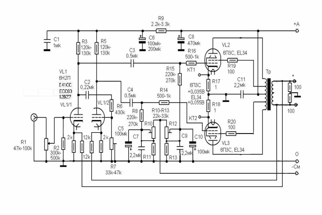

Very thank you!
Yes of course very similar to McIntosh ...
