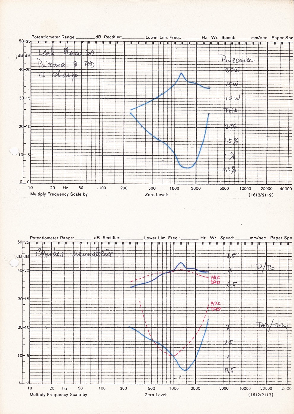

Attached are some measurements I did on my Leak ST60 long ago. The 2nd chart is normalized; you can see the ARC in red is more load-tolerant than the Leak.
I know, the X axis shouldn't be log, but that was the only chart paper I had at that time.
