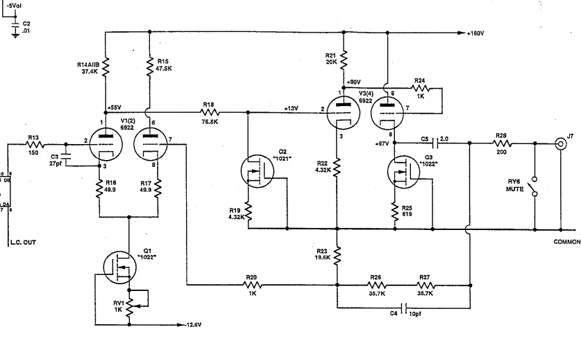

Since Audio Research did not respond on my fax requesting information about modifying a LS8 to MKII i am trying to find this out myself by the schematics of the LS8 and LS8 MKII and many other tube preamp designs.
LS8 Audio stage Left channel only:
I don't understand why Q2 is in there? it seem they didn't know either so removed this in the MKII though.
What is with Q1? from my basic knowlege of tube and transistor amplifiers it should work fine? if the cathode of V1 is just connected to the ground with 300Ohm resistor.
Why Q3? looks to me it works like some sort of diode this way preventing some feedback?
I'm quite sure i don't get it at this point, so i hope someone out here can help me out.
Right now i'm already happy with this preamp i just wonder if it can get any better 😎 and i like to mod. 🙄
All ideas are welcome!

BTW, regarding the schematic, to me Q1 is a CCS used to maintain a constant biasing in the first stage (as do Q3 in the last one) and Q2 seems to be a protection for V3 first triode during warm-up to maintain a safe V2/Vgk.
Regards
Fly
Though I cannot help with a new circuit diagram: Q2 is a Norton level shifter, working as a CCS to allow DC-coupling of V3 to V1 without attenuating the signal.
:up:
Q3 is a CCS (constant current source) implemented as a cathode load on the output cathode follower. (Slightly better linearity and a predictable operating point for the CF)

Thank you for the replys, i'm glad i know now why these fets are in the circuits
