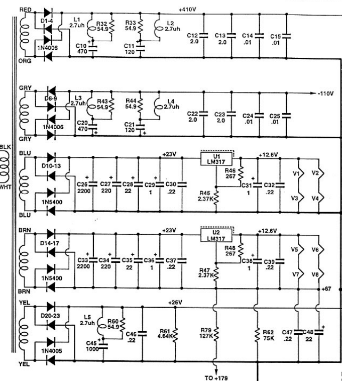

Some months ago, I finally got my hands on an Audio Research Mkiii and I want to learn as much as possible about it. Its a fully balanced linestage, uses 8x 6922 tubes. Since it may need new tubes, I have some questions.
1. When buying tubes, how should they be matched, in pairs or quads?
2. What is the purpose of RV2 and RV3 in the schematic
3. Which current production tubes? I'm currently looking at Gold Lion 6922's of Tubedepot, or perhaps some Phillips ECG 6922's off an ebay seller. Due to the high number of tubes, I'm not really interested in NOS tubes like NOS Amperex 7308 (even if they're the best sounding), my upper budget would be the Gold Lion 6922's , they're currently about $75 each.
Attaching circuit diagram if it helps answering the tube matching question, hopefully its clear enough.
Looking at the schematic, looks like this is for a single channel?
Any ideas on what Q1-Q5 do? They're color coded with paint by ARC.
Thanks in advance!

The fets are hand-selected current sources. Avoid touching the adjustments unless you have the service manual.
V1 and V3 should be a matched pair, since they are in parallel. Same for V2 and V4.
Ideally, V1-V4 should be a matched quad.
As long as the valves are of good quality, don't get sucked into paying for matched valves. In triodes, it makes little difference except costing you more cash.
RV2 and RV3 set up the bias point for the first two valves, (much like matching them).
6922 is an ECC88, 6n23P or 6n1p etc etc.
I have had best results from the 6n23P or 6n1p from Slovakia. A matched Quad from https://www.ebay.co.uk/itm/386965048863?_skw=6n23p&itmmeta=01JDFZ6JY1AP32FVENVG2CEW2E&hash=item5a18ea0e1f:g:RDIAAOSwGt1mLL2j&itmprp=enc:AQAJAAAA4HoV3kP08IDx+KZ9MfhVJKnbwyoqA0S64N++EVTRacXciYNRGKEQH1ARZwdXYlvx0R8f4U5mRkLAMzdZ4hHIB2DQRhAtjRuhtvzUjwBDdMGY4Bd0T8fnhJHCG+G/ZvyirKiAcv9l7Zkg+gRJTa0rxxxgavLKk/aB80JDsUJxRNvIVauGL4kLIlxd39G58HbJFraKhOfiOYO6gsQprfOSffUvRGbF+L6zIZ7zPrKseabJ2Rln6R2KreEjEEEpNdgZpSl/hYuhsLPALJVFUZORjumR553CAtiMj8/4A2b6oIsG|tkp:BFBMoq-a_-tk
will cost you around $10 At that price, you can afford to buy plenty and match them yourself.
Why pay more?

Would the bias point need adjusting based on the tubes individual characteristics?
The power supply section of the LS5 Mkiii seems to show that the heaters are powered with a pair of LM317's, based on the information @dubabub posted, with the 6N1P current at 600mA, then that would mean that the 6N1P would not be suitable selection it seems?

The front end of the AR pre is weird inasmuch as there are two balanced diff amps across the signal phases, but they are connected to want to be two diff amps within each phase. AR chose to make the cross-phase diffs the true diff amps - prioritising signal balance over THD reduction.
Hi
I was curious about the crossed feedback loops in this preamp, so did a sim in LTspice. I did not have 6922 models and just used 12AT7 to see the circuit function. I used 8m8 current sources for the two diff amps and the paraphase stage as that got the voltages to be around what the schematic showed. At first I had current sources for the output CFs but the negative phase would not work. I changed those to a jfet running at 1m6 each. Things you can get away with in spice 🙂
With 1Vpk in to both sides, there is 4V5 pk at each output at 0.05%THD at 1kHz. With the 12AT7s frequency response goes out to 3MHz but phase starts to drop at 100kHz.
THD jumps to 3.7% each side if the feedback loops are disabled (R15,16=0) and the output jumps to 18Vpk and is still fairly symmetrical.
Reconnecting the positive NFB path (R16=15k) restores the positive output to 0.05% and the negative side to 0.1%, both at a slightly elevated 7v4.
Shorting the negative input with 1Vpk to the positive input produces symmetric 2v3 outputs at 0.026% each. Reversing this produces identical results.
Like most balanced circuits, they really want to have two input signals.

A clarification to post-14:
With 1V peak signal on both inputs producing 4v5 peak from each output, you could look at it as 2V peak input producing 9V peak output. The gain from each input to its own output is 4.5, and so is the total input measured across the inputs compared to both outputs measured across both outputs.
With one input shorted, there is 1Vpk to the unshorted input making 2v3 on each output, so 1V in and 4v6 out. The 2v3 was a rounding, so really we still have the 4.5 gain measuring across both outputs and both inputs.
If you use just one input phase and only one output phase, the gain is 2.25, half of the differential signal gain.
From input to output, the circuit is one. Its use of differential amplifiers intimately ties the two signal paths together and we achieve the performance described above 🙂
There are "balanced" amps and preamps that are built as independent amplifying paths and they do not exhibit these characteristics. Instead, a signal applied to only one input produces only one signal on the related output.
