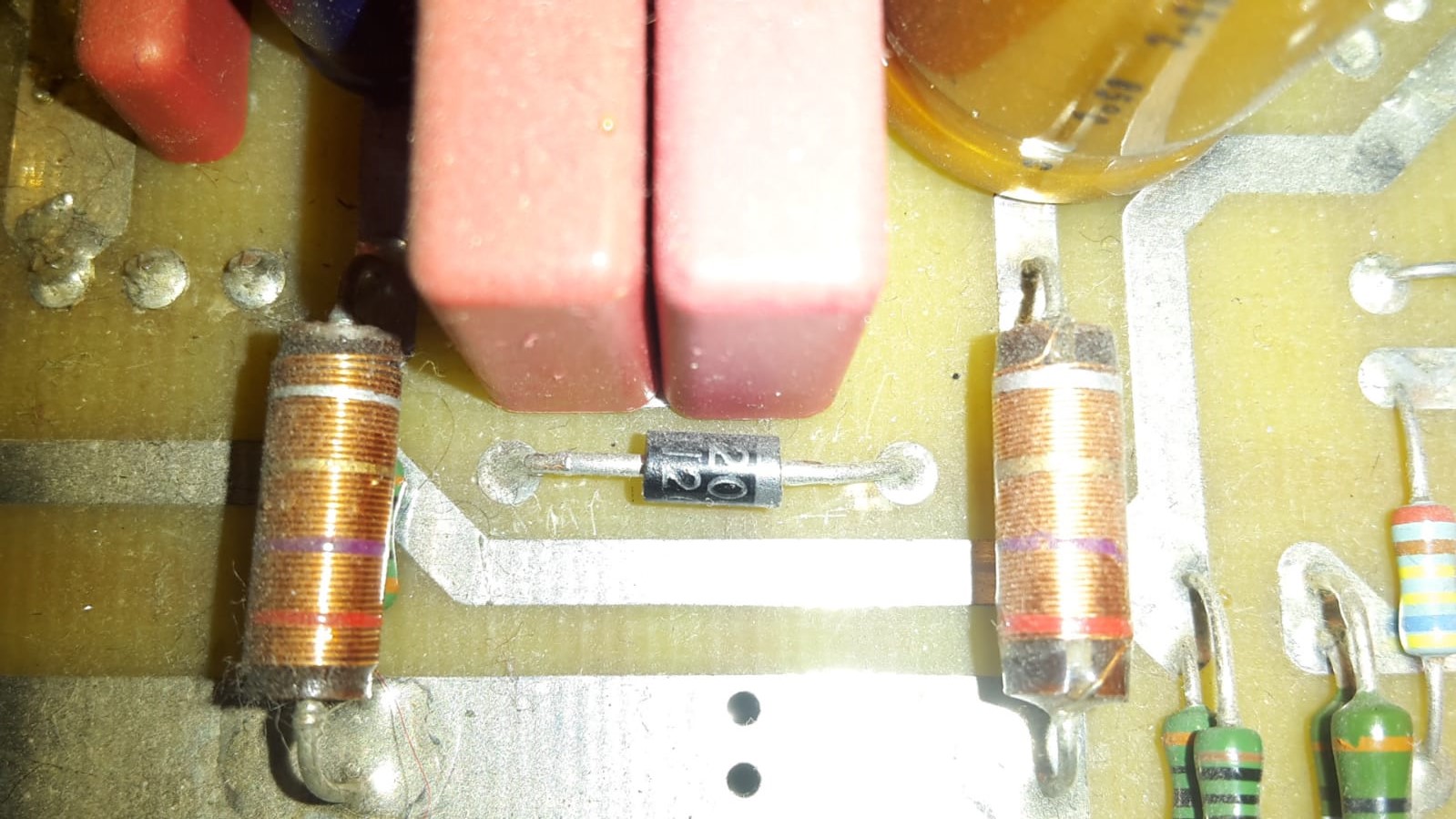

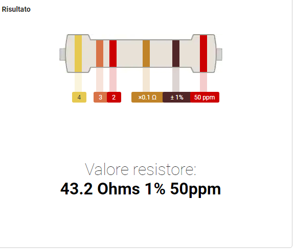

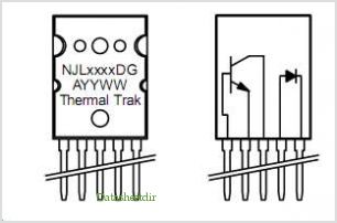

Yes, sorry. On the schematic, look for the R43 and R44 (each 43.2 ohms), and also R29 and R30
(each 1k ohms). They are part of a bias circuit. Each output transistor includes an internal bias diode.
You will have to locate these resistors on the power boards and trace out their connections. There are no
board pictorial diagrams however, so just look until you find them. There are not that many parts.
Since the bias diodes are in series, just one bad connection would cause problems with all of them.
Either the resistors are bad, or a connection is bad. Hopefully, the power devices themselves are good.

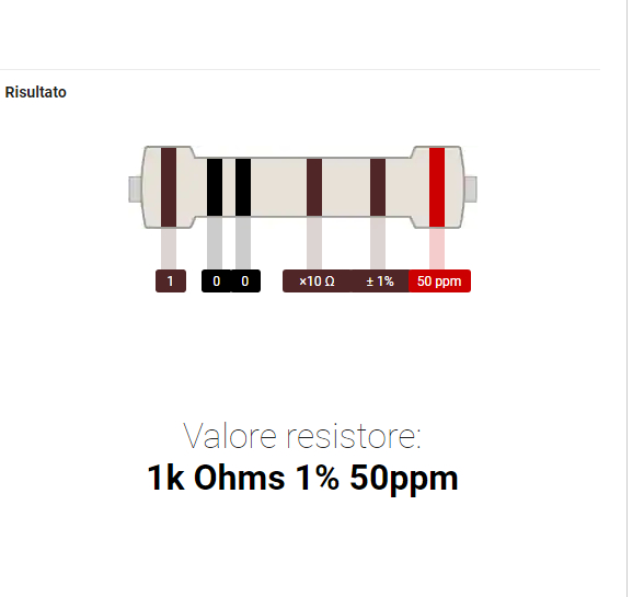

I did some soldering on the connections but to no avail, after which I started looking for the resistors mentioned, I state that it mounts all precision resistors with 6 colored bands, I understood that the polarization diode is inside each NJL3281D and NJL1302D so I attach also pin-out, looking first for R43 and R44 which as per drawing would be connected to pin 4 of the first two ic, I note that instead there is no r43 and r44 but in its place I find two diodes and subsequently R29 and R30 which are accurate to 1K, I do not understand if R43 and R44 are a schematic error I have a tamper, the two diodes are ok but how could you explain? Waiting for other advice thanks to all, I am attaching photos, the diodes do not seem to be mentioned in the diagram
