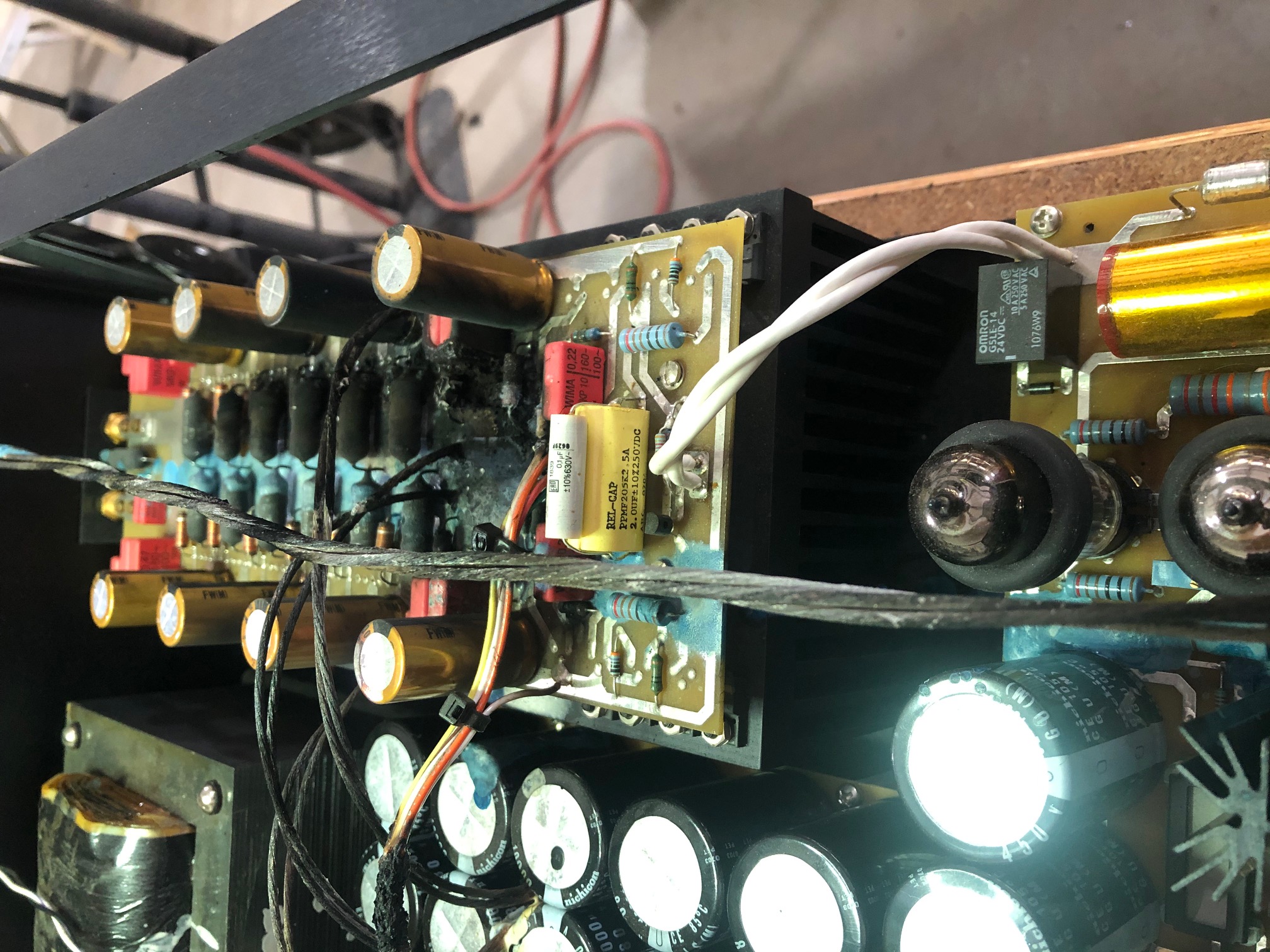

Im still not understanding why the input wiring to the right channel is melted, theres zero current running here under normal operation any input on that ?
The signal wiring? This may indicate your source ground potential was different to the amp's. All sorts of reasons for that: a leaky mains transformer, poor grounding... Only this does not explain the failed output transistors.
I don't know much about thermaltracks. These ones carry a designation of conventional transistors, only with compensation diodes. All the compensation diodes are in series and perhaps the failure of one may have caused the bias to jump up. Do these diodes ever fail?
Haven't seriously examined the circuit and perhaps will not understand their motives anyway. A diamond buffer afaik has a stable enough bias without any additional thermal compensation. The thermaltracks appear an unnecessary complication. Are they used to prevent thermal runaway or to make sure the amp runs at constant bias at all temperatures?
For the record - if you read the OP - I did play the amplifier for about 30 minutes after repairing it - it sounded great.

Were they the Thermonetics inrush limiters? -- if so they will get really hot IF the current is kept LOW for two long a period of time.
Did a little more investigating - to try to figure out why the input wire melted - the isolation on the wiring is flammable, strange choice for use in an amplifier. So the input wiring got ignited by the burning wiring below.
I'm certain the failure was caused by high frequency oscillation in the right channel - spilling over to the left channel as they share a common power supply. The output trannies on the left channel are still intact.

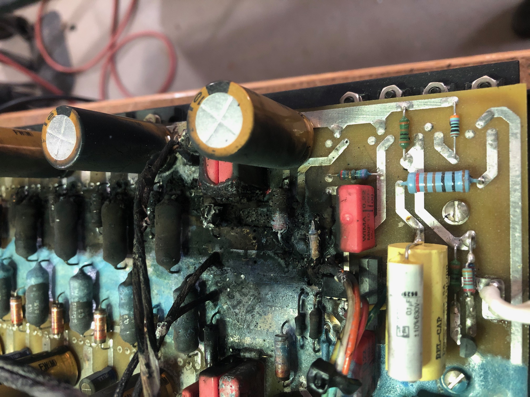

"The output trannies in the Left channel are still intact" -via-a-vis the Right channel output devices are blown---typical fault in a high frequency oscillation overheating them ,seen it time and time again --ergo heavy current applied due to extreme signal helped by large bank of high value capacitors inputting very high current .

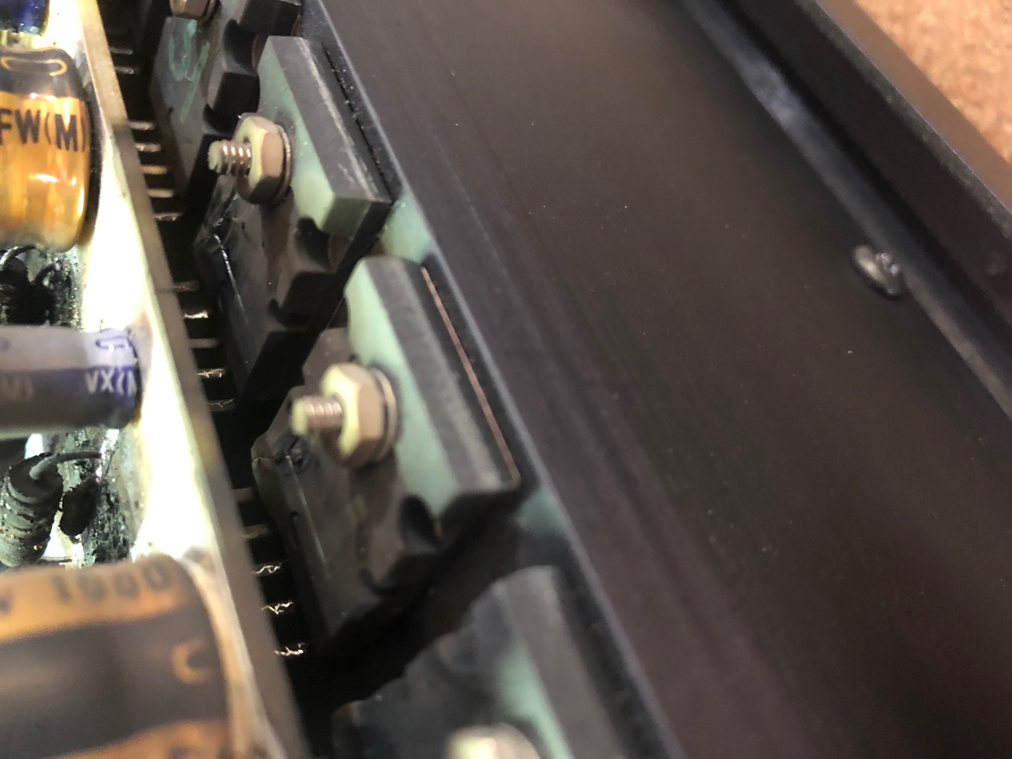

Again, if one of the thermal diodes opens up, will not all output transistors in that channel overbias and overheat?

Not at all strange, almost all wiring is flamable, but wiring should always be protected from overcurrent by a fuse or such anyway. You can use silicone insulated for wire intended to be pushed hard, but its usual to pick thicker wire instead and a suitable fuse. Teflon insulated wire will also tolerate much heat, but the fumes are pretty toxic once it chars.the isolation on the wiring is flammable, strange choice for use in an amplifier.
In special circumstances non-flammable insulation is mandated (usually for fire regulations in building ducts, aircraft etc). Its more expensive and harder to use.
And another point to consider - if the wire gets hot enough that the insulation starts to char, its going to melt any solder joints, so just assuming a robust enough insulation solves the underlying problem isn't really valid. As wires heat up their resistance increases quite
a lot too, potentially leading to thermal-runaway (acting as fuse). Wires that run cool are best. Size the wire, size the fuse, job done.

This wires insulation burns way way too quickly - if you look at the control wiring it charred too but only a few inches, the power wiring and the input wiring ignited then burnt with out any self extinguish properties.

I think i have figured out what happened with this one.
One or more of the Thermal Track devices on the right failed, it caused the board to heat up so much it caught the insulation on the wiring on fire. The insulation on this wire is not self extinguishing so it caught the rest of them on fire. If you notice in pictures above - the control wiring only charred about an inch or so on either side of the burning insulation below.
The initial conclusion that the wires over heated because of oscillation or other is not correct. It started at the Right channel PCB were the power wires enter it then spread to the rest of them.

If he also made repairs to the soft-start circuit, that could be a reason to expect a blown bridge. If the contacts on the soft-start relay were welded closed, for example. Without a soft-start circuit, 200,000 uF of capacitance is more than enough to blow a bridge.
Of course, if the soft-start relay was failing to close, then one should be even more concerned about a blown bridge rectifier.
All of this aside, any amp that can set itself on fire if the output devices fail is dangerous. There is zero excuse to not have some form of rail fusing. In an amp with such a stupid power supply (200,000 uF, no?), a transformer primary side fuse isn't really enough.
That said, a more pressing issue is why the mains fuse in the amp didn't blow. Did someone replace it with an inappropriate value? That's always something to check.
