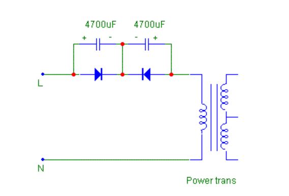

Cap. replacement is (IMO) a good thing. If DC crud happens to be riding on the AC mains, "Da Blok" could be a solution.
