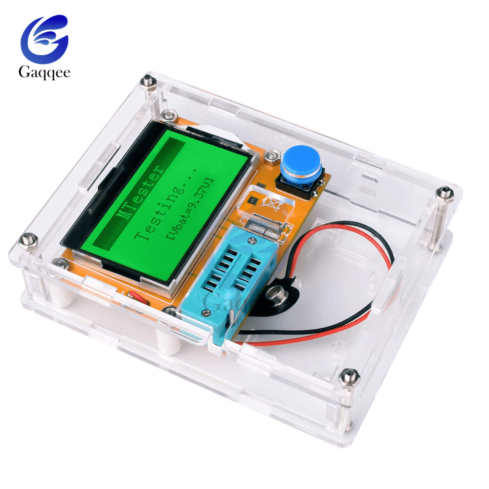

Testing transistors is no big deal, you can buy a Mega328 based tester for 10 bucks. Plus it tests LCR with better than 1% accuracy. It's all over Aliexpress, a must have.
