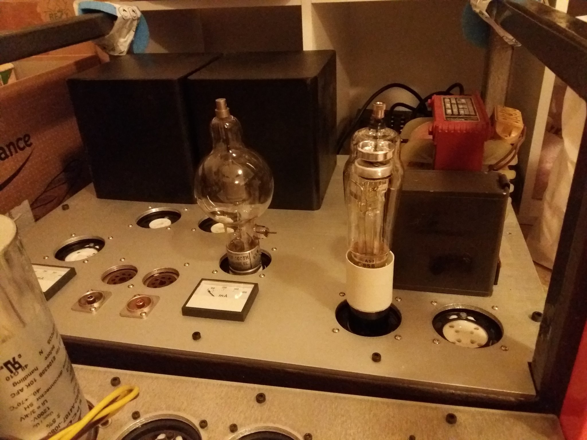

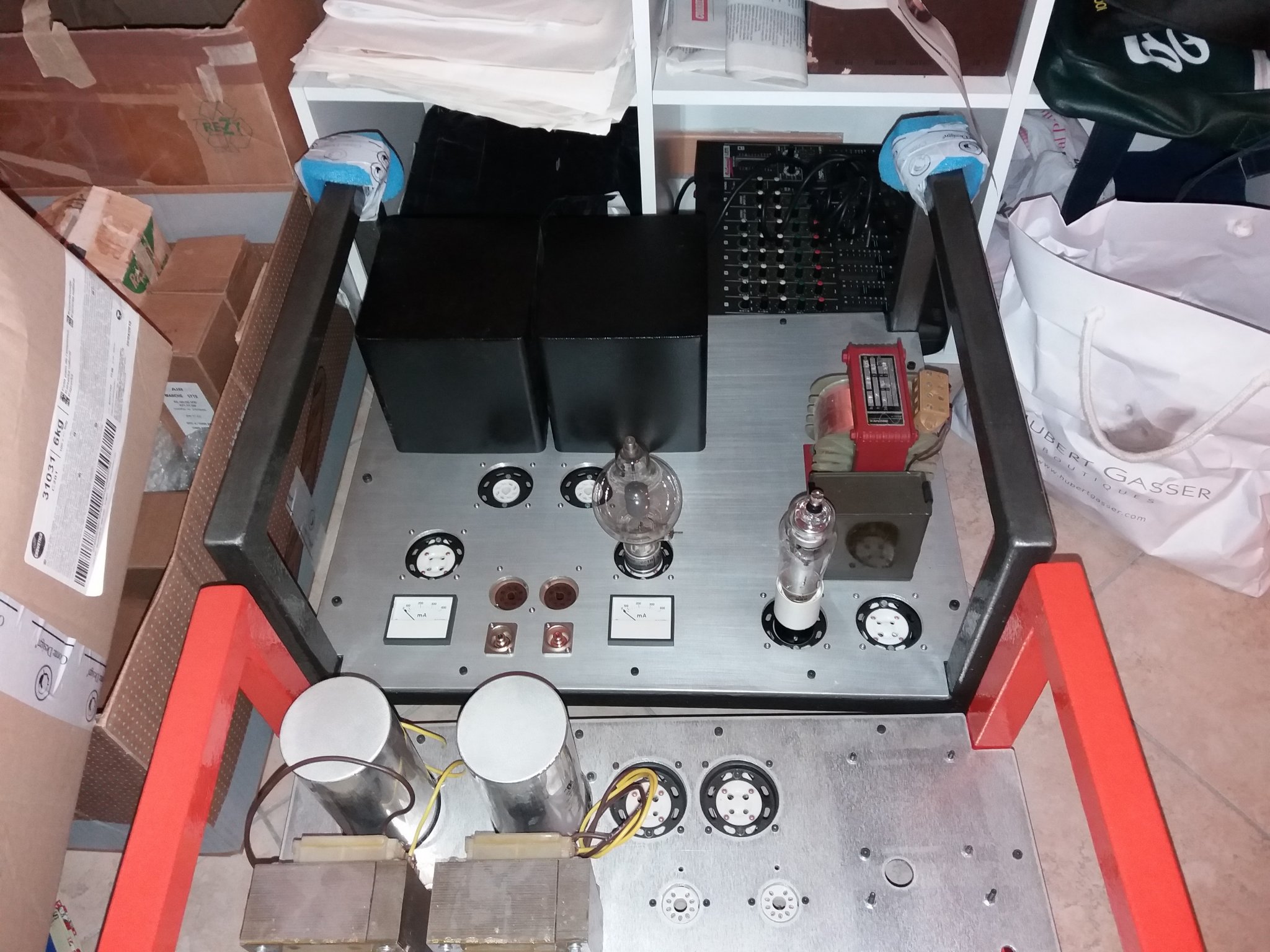

You toss toss those power numbers thinking it's like unachievable. But that's totally normal, and even maybe underwhelming, if you do radio. They think it's normal. Aka, easily done. It does broadcast across the planet.
And I don't think you are reading this forum, people routinely trounce factory stuff, or take it to another level.

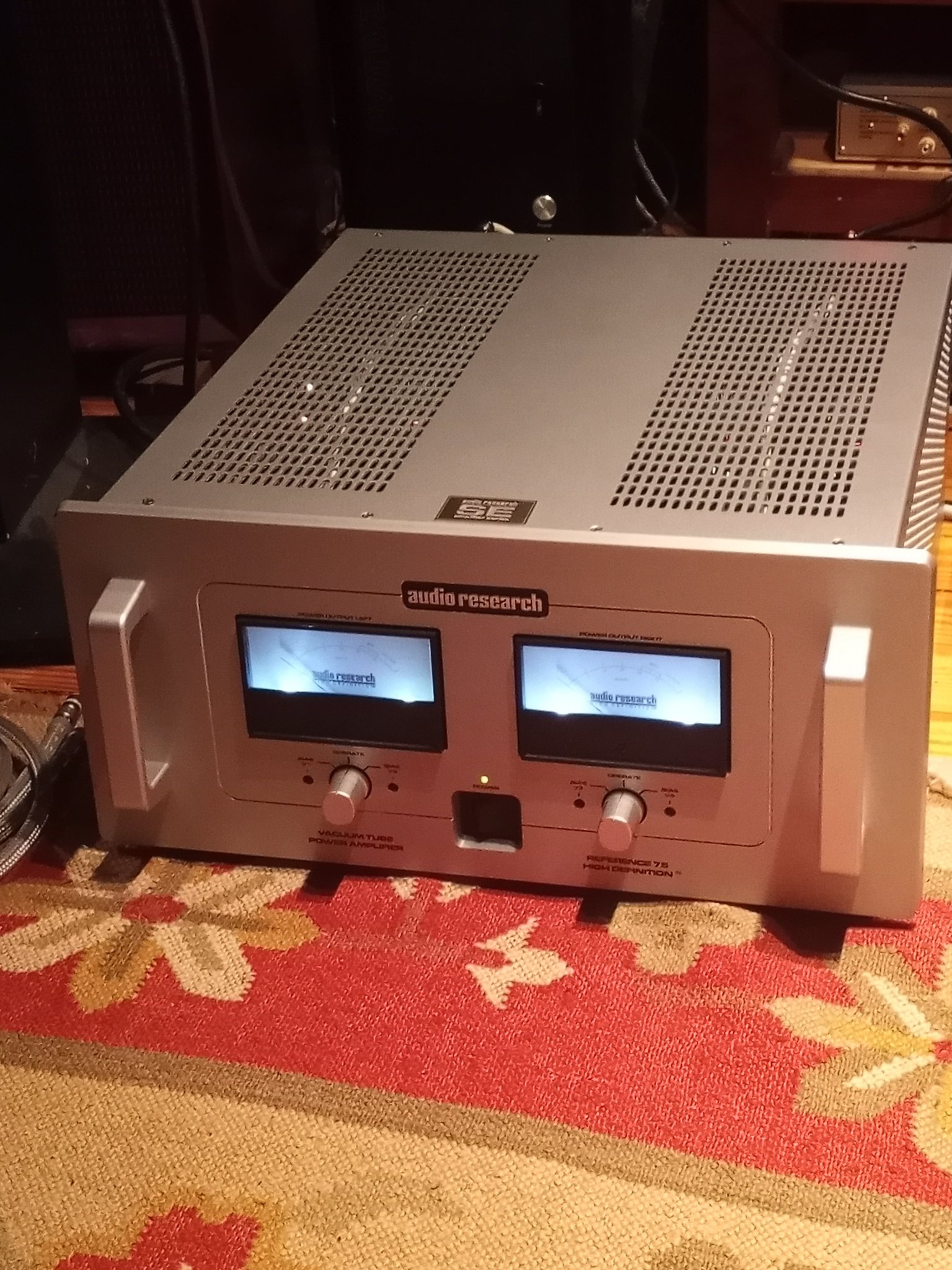

I have a pair of Classic 150.
Over a year ago I had issues with the 'Tube Saver' circuit on one of them. I took it to a recognized ARC Service provider/dealer and after many months they finally gave up. Some of the semiconductors (color coded) are no longer available from ARC and they don't even have selection criteria any longer, I verified this by speaking with the ARC Service Manager at the time.
Currently they sit in my basement, waiting for me to sell or to become 'boat anchors'.
Note: even if you have schematics these amplifiers are very difficult to troubleshoot.

My friend was one of the oldest if not the oldest ARC dealer in US . For last 3 years he gradually withdrew from the business and in last couple months they cleaned the shelves and closed the shop so my experience with ARC service dates 3 years back now. I guess things have changed with service dept there. Hard to believe they don't have a cross reference for usually standard semiconductors used in those circuits.I have a pair of Classic 150.
The service is a revenue generating business. If the tech is unable to find the fault fast they put it on the shelf and after months they push it out. Find competent local tech not related to dealer service. it's true the amps are complicated but not more than a big solid state amp so replacing a screen resistor and pocketing $500 is not going to happen.

Back to OP question. For background information, the Classic 150 and M300 are twins. The main difference between the 2 is the Classic 150 output tubes are connected in triode, and if you want to get picky, the RCA model has a more sophisticated input stage phase inversion circuit. The balanced input stage of both amps is identical. I have a pair of M300 amps that I bought about 8 years ago as a winter project. I bought them as untested non-working. I never plugged them in or did any checks; just put them on the shelf. 3 years ago I decided to put them on top of the project list. The local ARC dealership, Audio Dimensions in Royal Oak, MI told me that ARC no longer sells parts directly sells parts to individuals. I called ARC and sure enough, they will only sell to authorized ARC dealers. That put the amps back to the bottom of the project list. Fast forward to new owner, and there was a change of heart towards the DIY owner.......parts were once again available to individuals.
I checked on all of the active devices, and unfortunately many are not available. My goal was to buy all of the active devices just to have them on hand. Once I start troubleshooting, the odds of completing a project is better if I have the parts on hand. Putting a pause in the process waiting for parts is the kiss of death. Per the original OP post, the remaining parts ARC has in stock are around $15.00. I feel that's a fair price. I personally don't have the time to take a good part and test it to determine key characteristics. Or the equipment capable to measure some of the parameters like gate capacitance, or a HV curve tracer.
When I talked to ARC, I was told that they can no longer service the M300. If you look at the ARC website there are a number of amps that are no longer serviceable due to parts obsolesce.
In retrospect it's ironic that ARC created the M300, and Classic and VT series of amps because new US production small signal tubes (well all tubes) was at an end. ARC switched to hybrid designs to continue "tube amp" production. And now we are at a point in time where high quality small signal tubes and power tubes are available but semiconductors suitable for audio are no longer available. In the past I heard that the reason the M300 became the Classic 150 is that the Chinese sourced 6550 tubes failed in the M300, but would last in a triode configuration. Makes sense.
My $0.02 is that any of the ARC hybrid amps are on borrowed time. And I'm saying that while openly sharing that I have a bad pair of M300 amps. Once they fail the only viable option is to buy a working amp for parts, or to match up to get a working pair and a broken pair. Who knows maybe with 2 broken doner amps it's possible to keep a working pair running for another 40 years.
