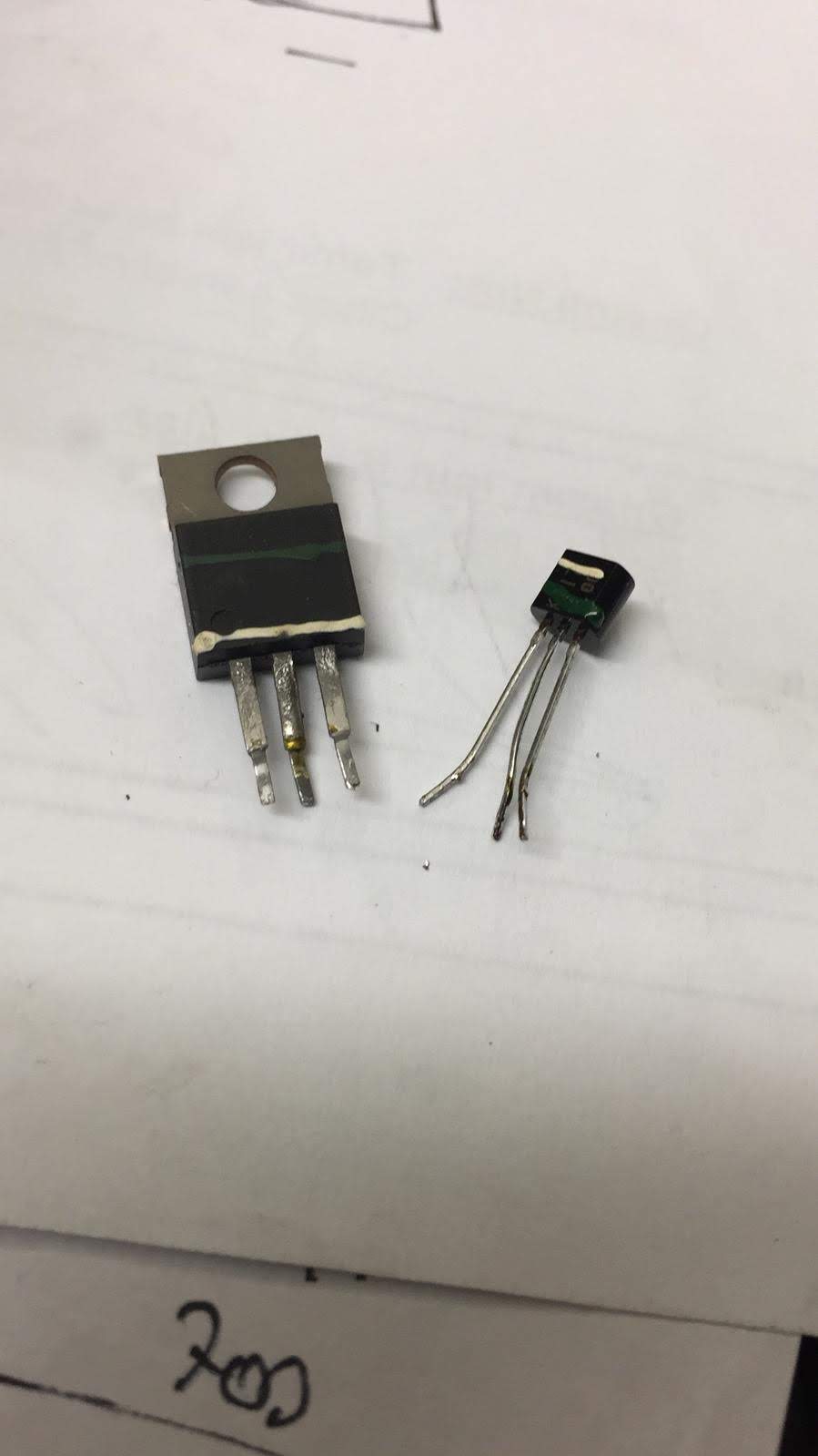

Hi everybody ! Same story here, a friend of mine faced that problem with the specific fet in his ARC REF1 preamp.
Bad is they have no print at all (deleted by ARC ...) but only colour code (Green-White-White), and its ARC part no. is 30011011. That fet has been used in ARC REF1 and VT100 mkI.
Here it is :
But ARC send him a pair of fet with different colour code and ARC part no too. He received a Green-Green-Brown fet and its ARC part no is 30011021. This fet has been used in ARC REF 2 mkI and VT200 mkI as well.
Then my friend took some pictures and sent me them to help him if I could,so here is the new Green-Green Brown fet :
If you look at it a little closer you might see the factory numbers (ARC didn't a good job here 🙄), it looks like the discontinued Zetex ZVN2535A or a Supertex DN2535 (Mouser have plenty of them).
Hope this info helps a bit
My technician friend also met same problem.He told they are between output tubes and ground.After too many attempts by my friend ,ARC sent them a replacement part but my friend tells it is not working.Anyone knows which parts it this?
the left one is original part,it is attached to a little heatsink and right one is the part which ARC sent.
They are depletion mode MOSFET's connected as current sources. They do come in both packages but beware of the power dissipation rating of each. They are probably sorted for threshold voltage and/or current at 0 Vgs.
http://www.redrok.com/MOSFET_DN2535_350V_120mA_25O_Vth-1.5_TO-92.pdf
EDIT - Mouser has plenty at $1.20 or so each (in the right package). Just pick a different resistor to set the current.

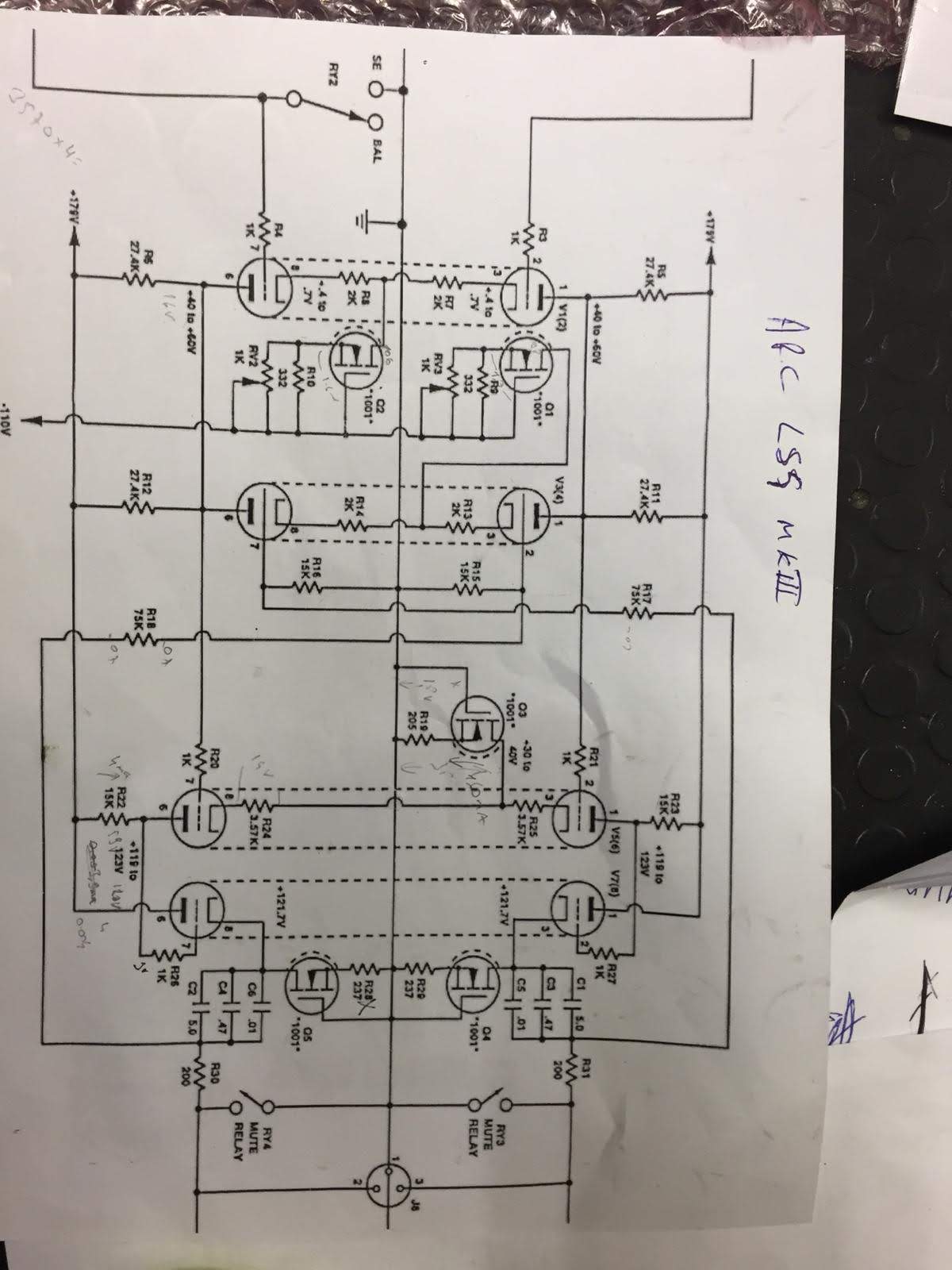

I think if we know the voltage across the q1 fet and voltage across the 237r resistor we can find a replacement for this transistor.
You are correct. Is it not just configured as a current sink for the tube?
Then you can measure the current (or voltage across the resistor) of the working other half and just put in your own current source, even with a FET of your own selection.
Scott knows far more than I do, but the posted schematic indicates that the FET is on a heatsink which, to me at least, would suggest the -220 package. Of which Mouser has plenty as well DN2535N5-G Microchip Technology | Mouser
Right, I thought the OP might have been calling the TO220 package itself a "little heatsink". I don't see how one could repair this with a TO92 package or why they would be sending them when both are cheaply available. By right I meant left in the picture. 🙂
Hi.I agree ARC did not do a good job here.I meant my friend told to220 item is connected to a little heatsink.(additional to its own metal) Are you sure DN2535 works well in this circuit?
If not sure about it i suggested him to buy an Atlas semiconductor analyser and he can find a replacement by looking at parameter results.(he is already a repairman and it will be useful for him for future repairs)

It's a good bet there are not that many depletion mode MOSFET's in these two packages, easy to try you are only setting DC current for the valves.
